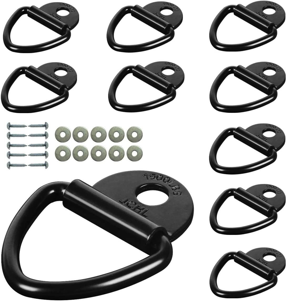

Anyone have any thoughts and or pictures of putting some sort of bed tie downs in the bed but I don’t want to drill holes in the box/bed at all.
So with that being said.....how about some sort of a d ring I could run the box bolts thru that go thru the frame?
I want something strong enough that I can put a ratchet strap to so I can tie things down like a ATV in the back of the truck.
Again I don’t want to drill holes into the box anywhere or cut anything up at all.

Had a thought. Think I will buy 4 welded able D rings. Like you would weld to a bumper. Make a 1/2” thick washer. Get some longer grade 8 bolts and welded the D ring to the washer and top part of the bolt. I’ll put them in each corner of the bed hold down bolts. I’ll investigate it more. If I do it I’ll update the post as to how they turned out.
This way no modifying the box or drilling extra holes etc...

Rich, I did see those and thought about them but they just didn’t look strong enough. Guess I’m over thinking it. I didn’t think of looking at the bed stake pocket for a hole. I’ll check it out later today. Thanks! Later, Frank

Those were just a fast find on the internet to be an example, I am sure with more than a 30 web hunt you can find some HD ones. On the front stake pocket there is a single OEM hole (facing inwards), nothing on the middle stake pocket, but a nice flat surface to work with. And the rear stake pockets has 2 OEM holes. Of course with the proper metal plate/big washer reinforcement you should be ok to tie down a common 4 wheeler.
