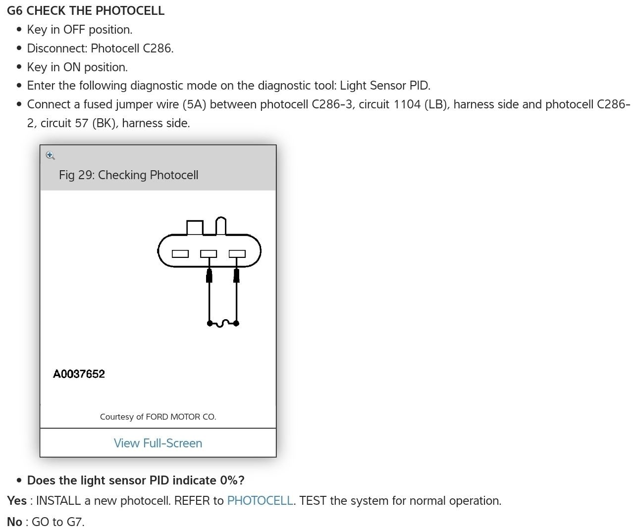

Ford has a symptom chart & diag. Since you asked photocell specifically, I'll post screenshots of how to test.
