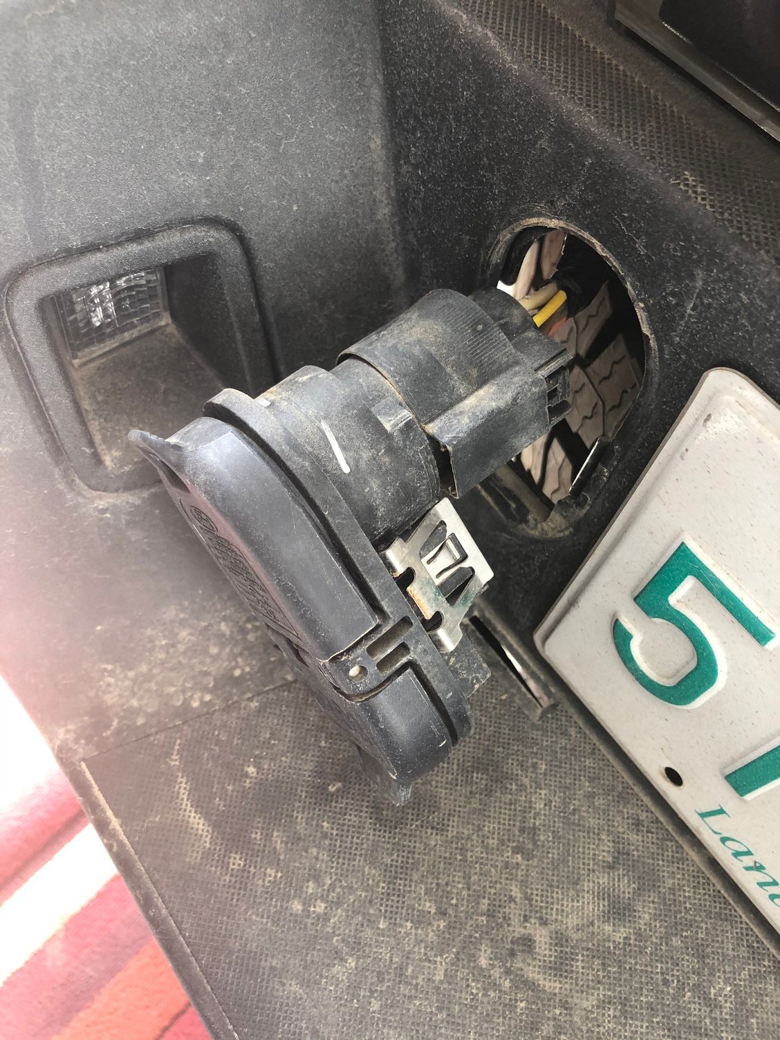

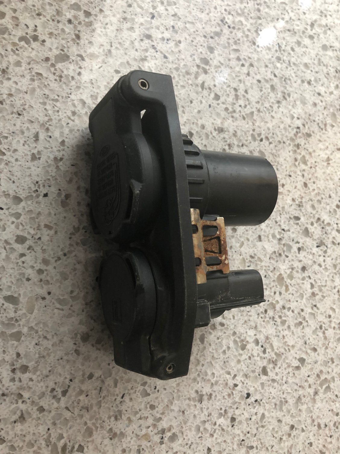

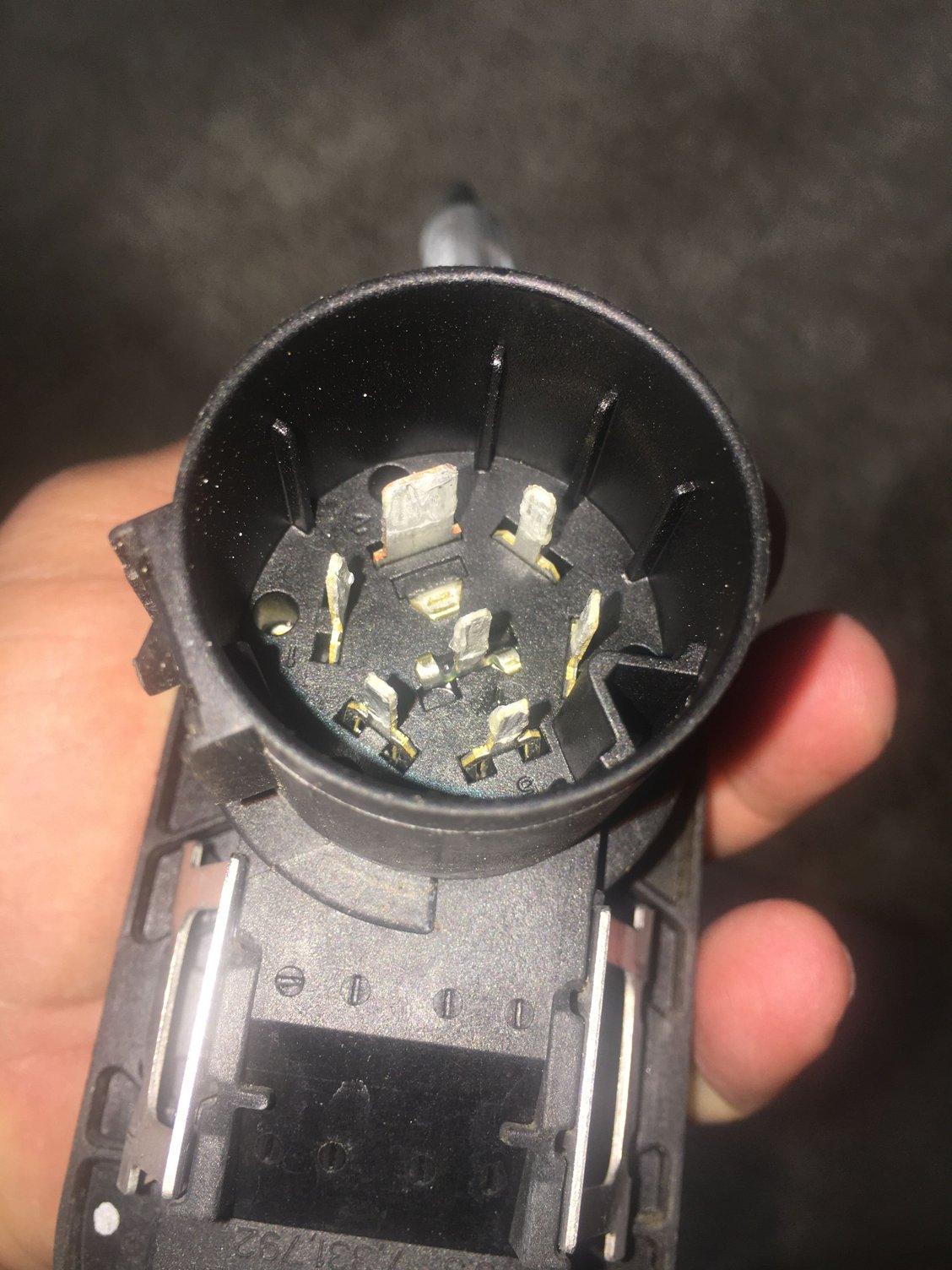

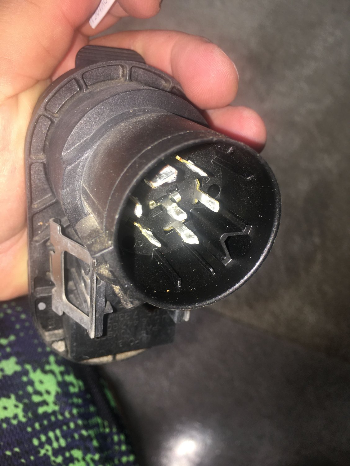

This connector.
This is actually the 7pin and camera connector that came with the six camera for trailer.
my original 7/4 pin connector was corroded and started throwing the random trailer connected and disconnected codes so I replaced the 7/4 pin one with the camera one to get the codes to stop. I exchanged the corroded 7/4 pin connector at the dealer for a new one. Now, I put the normal 7/4 pin connector back in and took this one out because it was not working anymore when I connect to a trailer. I’ll try cleaning it to see if I can get it working again.
Reach behind your bumper and you can un-clip the wire harness connection. You can then push each side in to release the retaining clips and pull it out from the bumper. Clean it good and reinstall. Hopefully you don’t have to replace the piece like I had to. Junk.

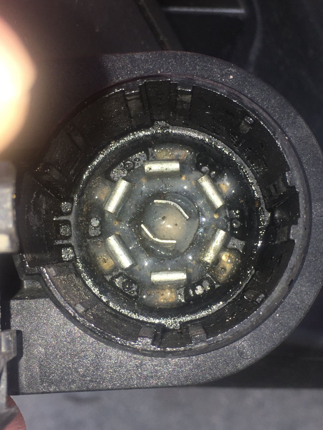

I just went out to add dielectric grease because I didn’t have any on hand when my connector stopped working. Here’s a better pic. I released the clips first, pulled it through and then released the wiring connector. It’s hard to get the wire connector clipped back together but you’ll get it.

Looks the same as when I put grease in it a few months ago.
