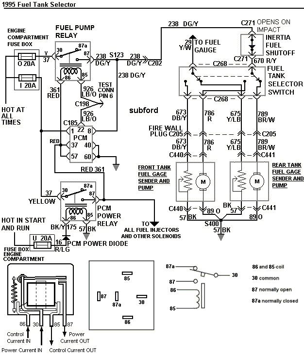

Does anyone happen to know what this means “542 open circuit in fuel system eec to ground” hooked a computer up to my truck and this is the code that came up I posted on her about my truck before being a no start they finally got everything figured out enough to get a computer hooked to my truck to read the computer in my truck and that code Is what they got??

542 most of the time is a bad fuel pump or has had a bad fuel pump in the last 80 startups if the battery has not been disconnected.
From the manual.
DTC 542 indicates that one of the following has occurred:
No Start:
-- Inertia Fuel Shutoff (IFS) switch not reset or electrically open (if in secondary circuit).
-- Open circuit between the fuel pump and FPM circuit connection to the power-to-pump circuit.
-- Poor fuel pump ground.
-- Fuel pump electrically open.
Engine Starts:
-- Fuel pump secondary circuit short to power.
-- Fuel pump relay contacts always closed.
-- Open in FPM circuit between PCM and connection to the power-to-pump circuit.
-- Left/front HO2S short to power (dual HO2S applications).
-- Damaged Powertrain Control Module (PCM).
A 1994 and a 1995 are wired the same, here is a wiring for a 1995.
Attachment 278424

Thank you
Thanks guys we found it!! But more problems have come about that it’s almost discouraging😔
