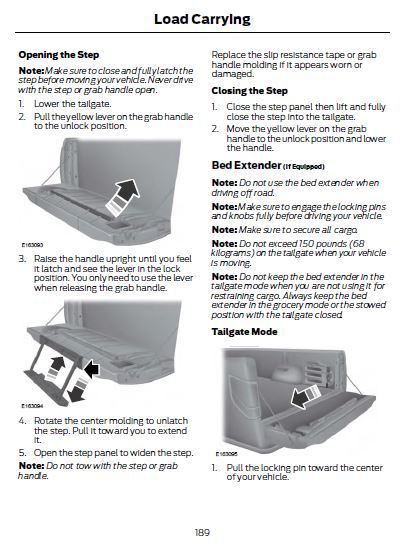

so I just picked up a 2015 f350 a month or so ago and I can not get the step in the tailgate to pull out. I took the cover off and seems like there is a latch in the middle holding it up but for the life of me can not figure it out. Is there there a diagram or something on this? or am I just a ****ing idiot lol

See page 189 of your owner's manual
Ford Owners Manuals Search Results
