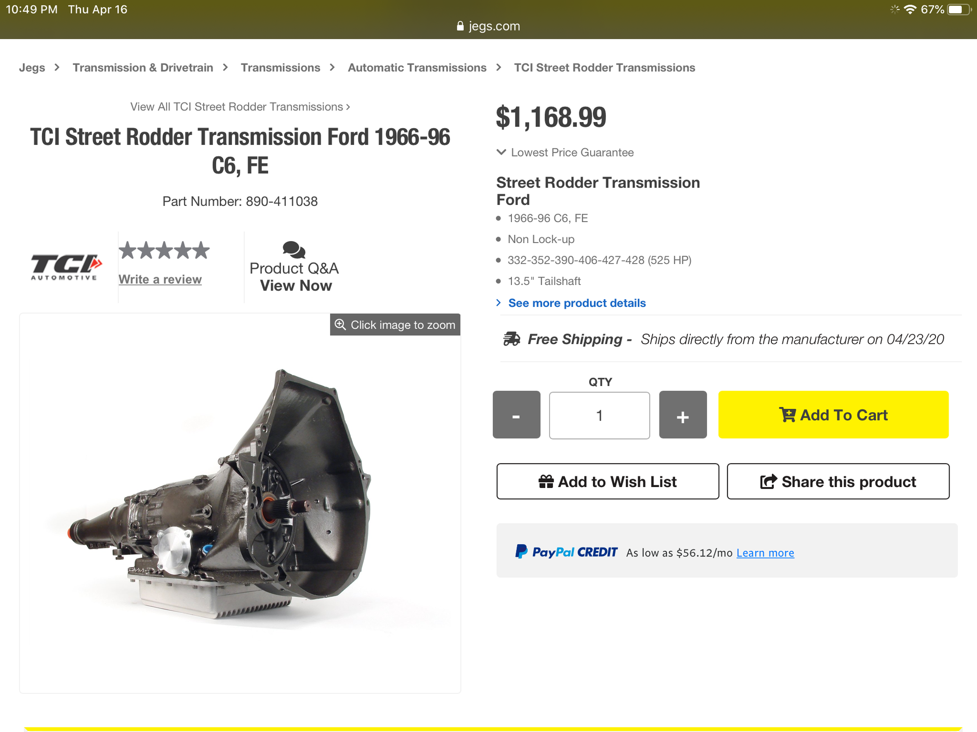

Since I don’t have a connection to get it rebuilt for $600 and it looks like it will be about $1200 to get the upgrades, this might be my best bet:
There’s a $50 off coupon and free shipping, so by the time I buy this and a torque converter, it comes out about the same as the rebuild with upgrades option and this is rated for up to 525 hp, Dyno tested, guaranteed, etc. Anybody gone this route?

TCI and B&M are the biggest waste of money, absolute junk products. They ride on a name and false claims, don't expect after sale support either. If you want to order online I would go with Monster as they have gained a good reputation in the racing and performance industry and offer a good value.
https://www.monstertransmission.com/...E#.XpkkMVNlA0E
The Monster C6 starts out at $1199, add $299 for the round one that fits a 390, add $225 for core return shipping or consider it a warranty charge since you can opt not to return the core and just decline the warranty. They also charge $189 for the factory low stall torque converter (rated up to 300 hp) which sounds to me like they suggest the $300 torque converter for my engine. If you choose not to buy the torque converter from them they knock the warranty down to 30 days. I'm not knowledgeable about transmissions, so it's tough for me to really evaluate these options. If I need to research planets and servos, etc to make an informed choice I can do that. Ultimately my goal is to have a reliable transmission in my truck. My current one feels worn out and I'm being told that hooking up a more powerful engine to it is asking for trouble. My brother used to work as a mechanic and now just works on his own vehicles and goes off roading in his truck had good things to say about the TCI, but I'm not 100% sold on that by any means.

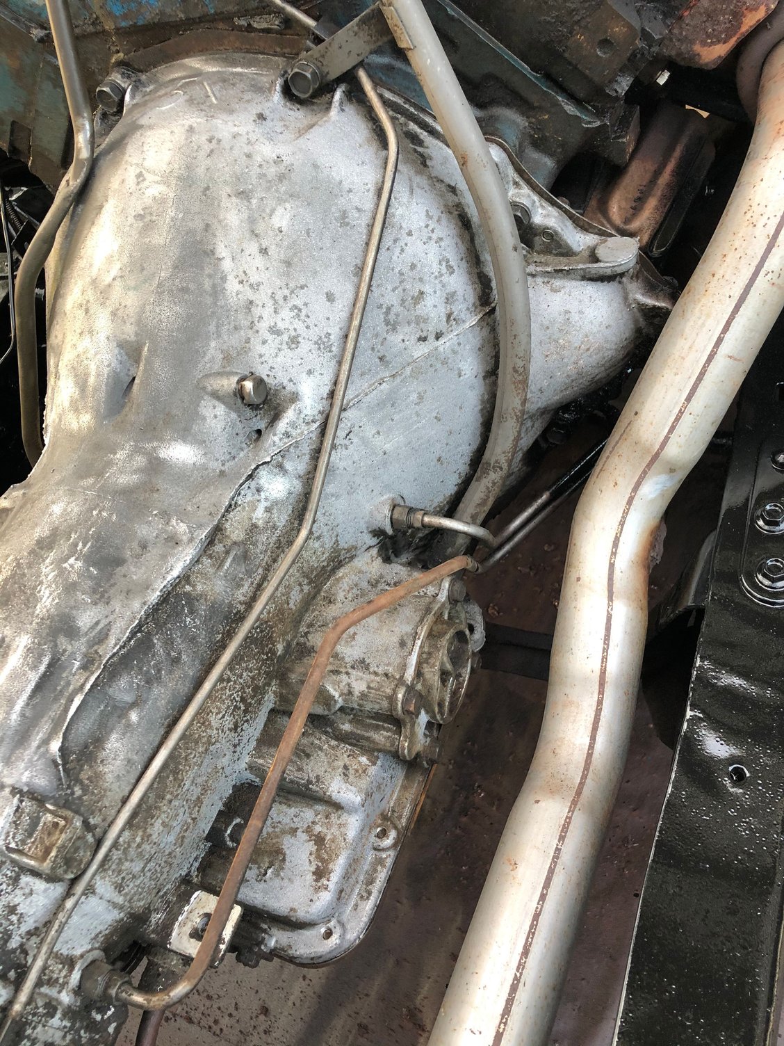

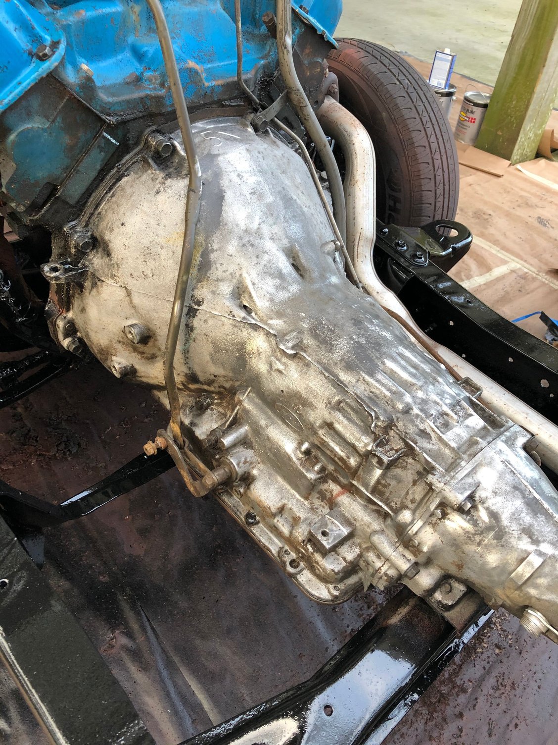

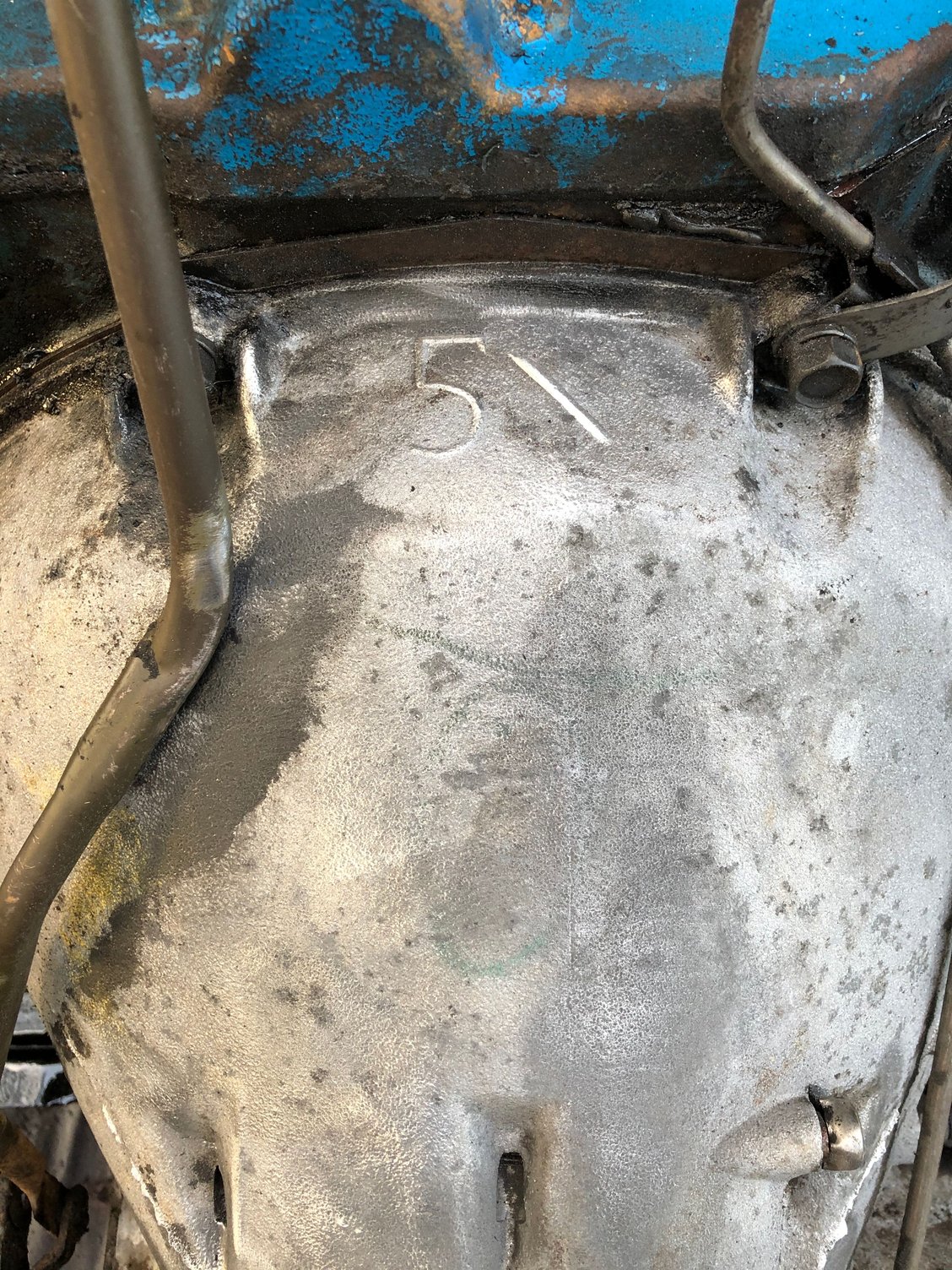

Originally Posted by mark a.
If you exchange it, make sure it has the right tail shaft and the right shifter in it to hook up to your linkage.
Good call. Right now I have a 360 in my truck and I’m swapping in a 390. That is supposed to be a bolt in swap. But when I look up the big block version of the c6 like the picture I posted above, it shows a flat edge at the top. But my current transmission looks more rounded, so that is confusing me:
Is the flat part on the bottom? I never took pictures from underneath.
