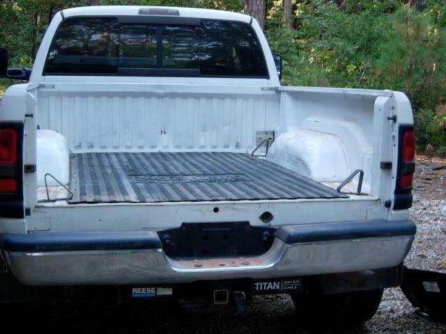

Lance Camper Guides in position on my Dodge Cummins
jefe
