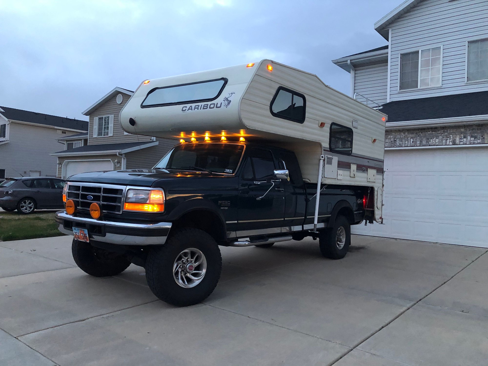

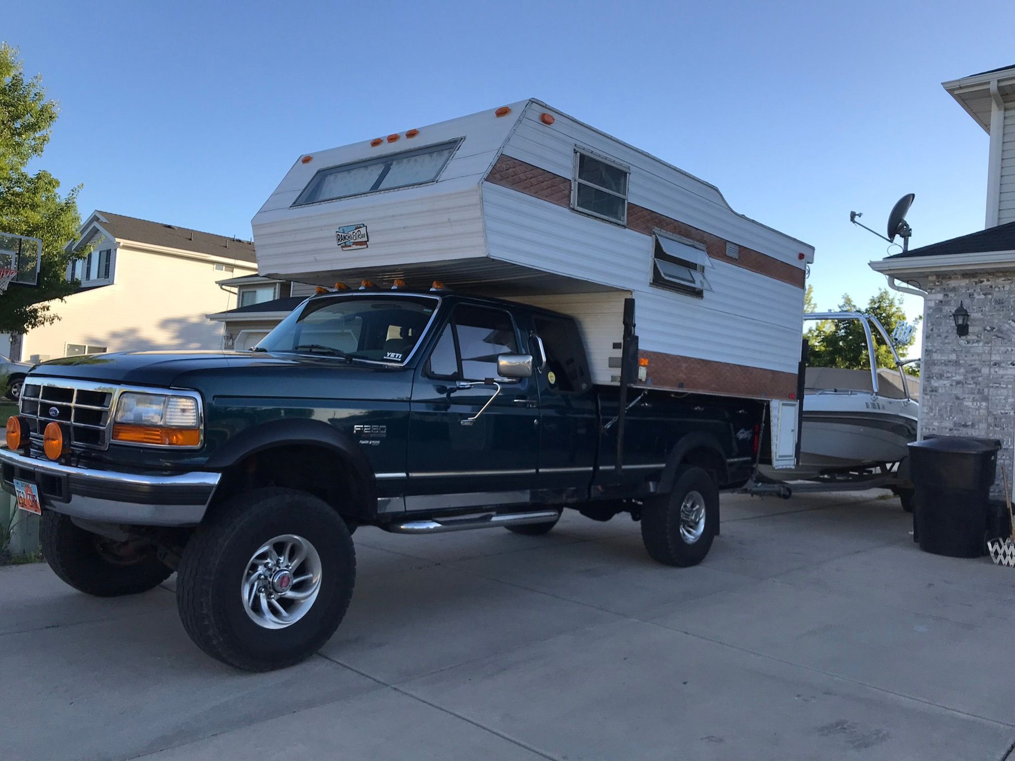

Here’s a couple of pictures of the upgrade.
Old One
New One
Old Apr 16, 2020 | 01:50 PM
