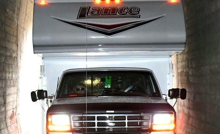

A lot of people are using plywood / Stall Mat single or combine applications, and I've seen a lot of people using 1" foam insulation from Lowes or similar stores.
When Lance redesigned, IMHO for those of us with older pickups, it put way too much clearance between the cab and the cab over.
On my 96 I have over 8" of clearance and right at 6 3/4 (IIRC) on the 2011.
2020 1062 on 2011 F350 DRW King Ranch. Nothing in the bed except the OEM bed liner and a bed liner mat.
2020 on 1996 F250 Extended Cab PSD. I do have a 3/4" plywood spacer in this pickup to keep the camper above a fold down ball goose neck setup.

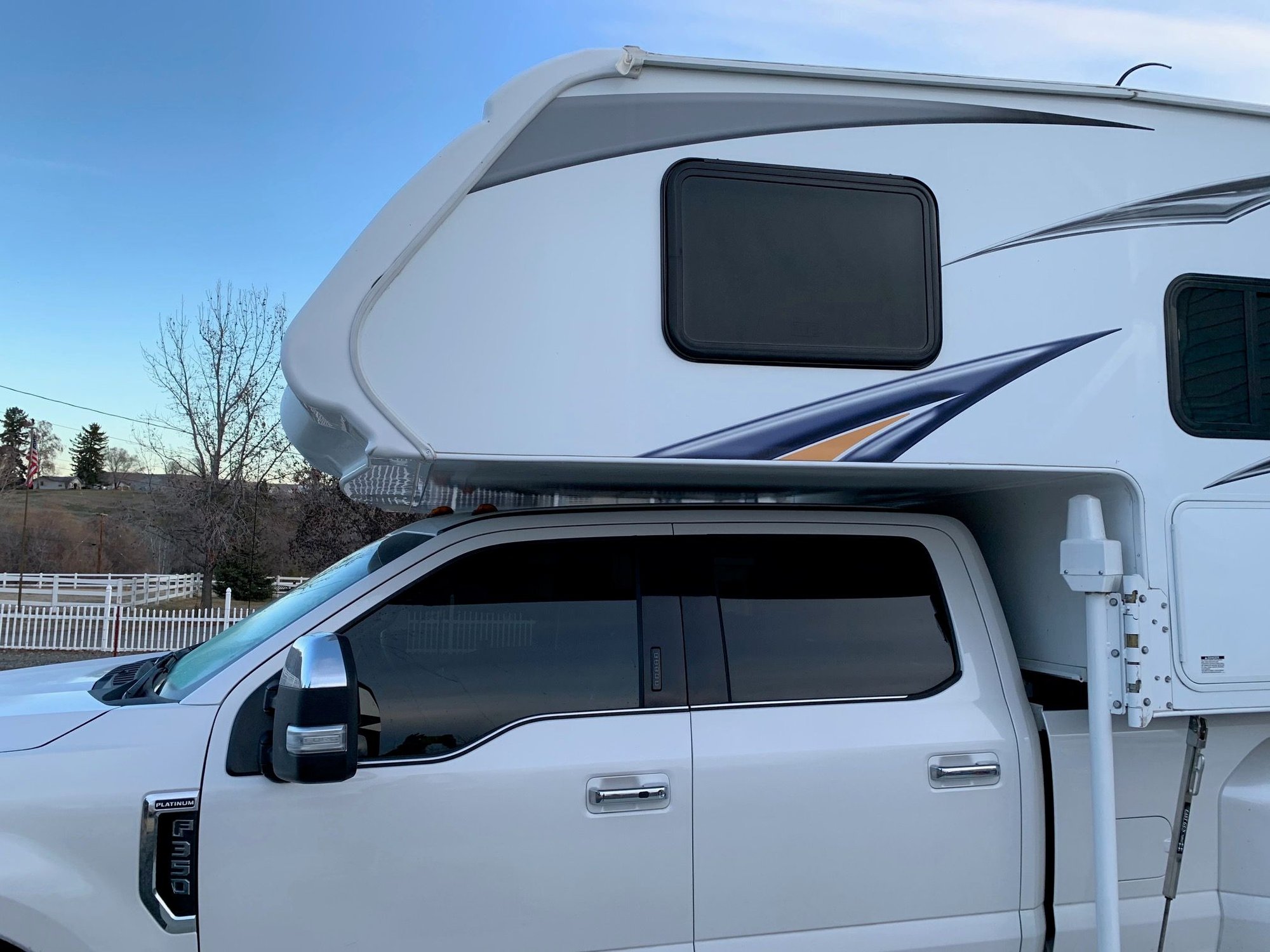

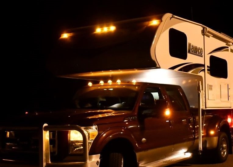

I don't have an exact measurement (the camper is off the truck), but here’s what our clearance looks like. So far, so good!
HTH,
Jim / crewzer

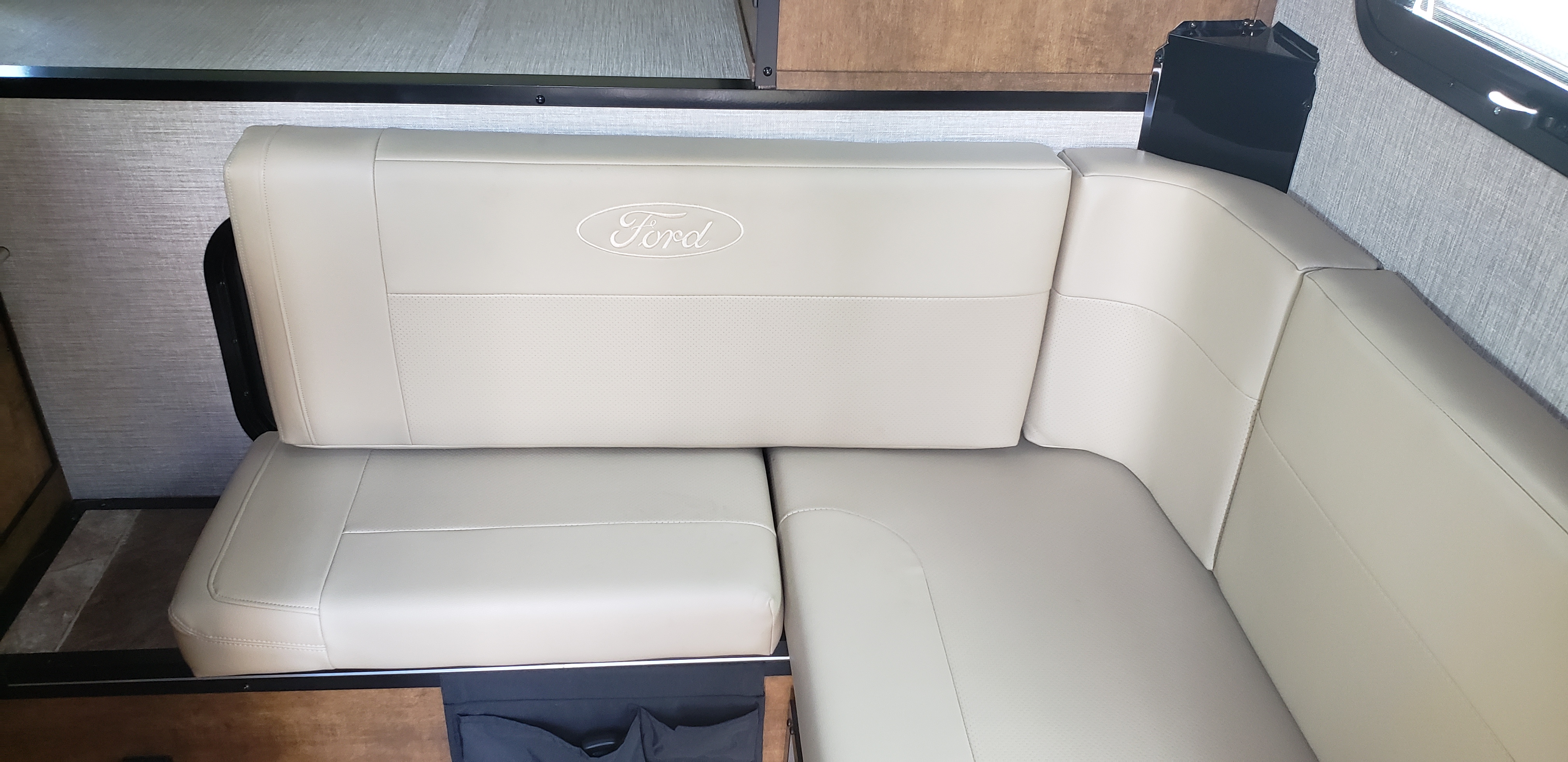

Originally Posted by AMXDREAMER
I bought a Ford camper and it fits great.....just another reason to buy OEM stuff! lol
I don't think there is anything "OEM" about that little camper except the Ford sticker? Does Ford actually make it? If so I'd be leery of the quality. If I didn't have the family needs of a larger camper it sure would be a lot simpler to stay with that size of camper for sure! The new campers are built to adjust for the height from what I have found, I just didn't want to buy a brand new camper. From talking to the local Lance dealer here, the cab height of the new Fords starting in 2017 forced camper dealers to make the clearance higher, this raised the total height or lessened the cabover bed room depending on model. He was able to print out a spec sheet of what the camper needed for truck and it was 1.75" of clearance. He also said the new ford frame does not flex nearly as much as older trucks and it will be just fine. I'm just going to run it how I have it setup, it seems to work just fine.

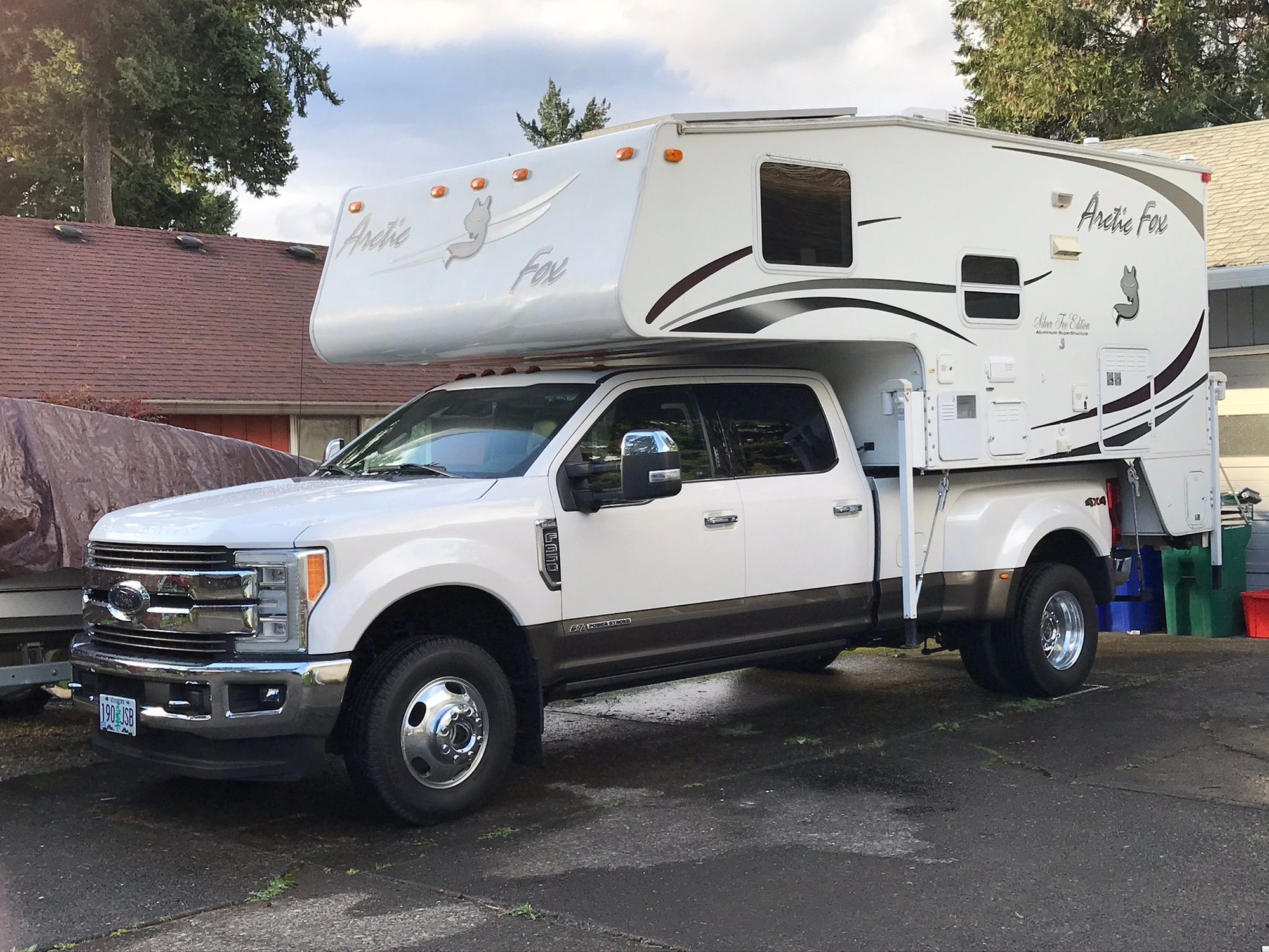

I just went thru this with my 2007 arctic fox and 2017 F-350, I have about 2” of clearance above antennae and markers.
i have an industrial rubber mat in the bed, it is 2” thick and provides clearance above the cab but I might just add another 1/2 mat just for insurance.
When I get a chance I will get an actual measurement.

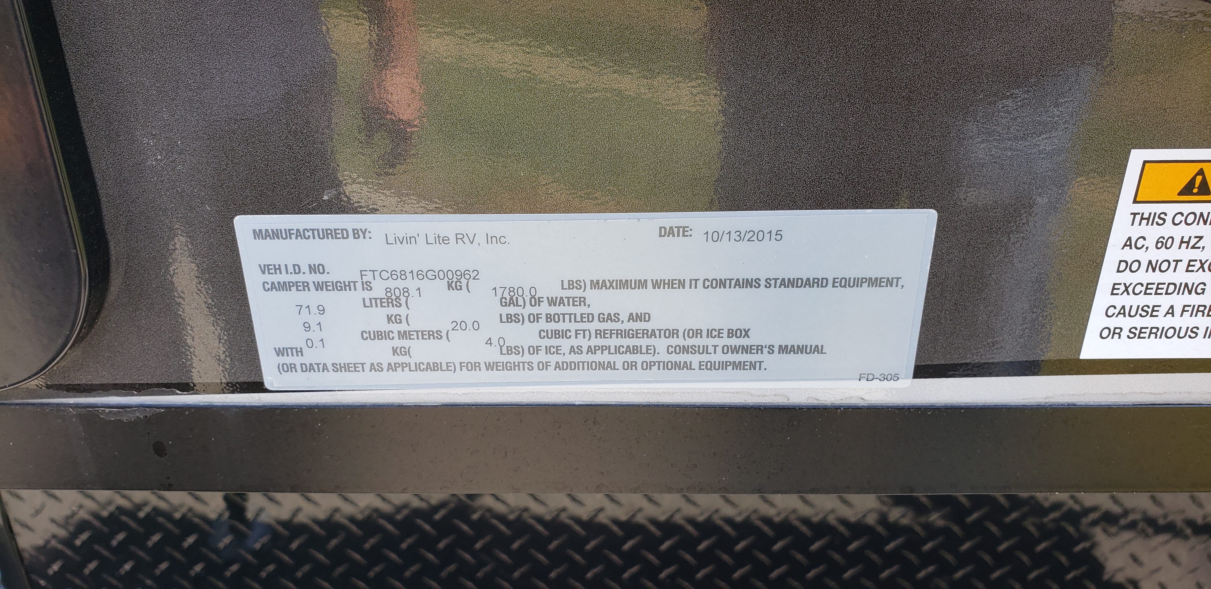

The camper in fact is Ford "branded" and has an actual Ford VIN. The paint is factory Ford colors, it has the same materials on the seating and window treatments as the Ford truck leather seats along with stitched Ford logos and a Ford designed front cap to match the truck windshields, along with a few other unique items. They were made by Livin' Lite I believe for only 2016.
.Attachment 280323
Note the VIN starts with FT for Ford Truck
Attachment 280326
The actual Ford VIN tag on the back of the camper.
