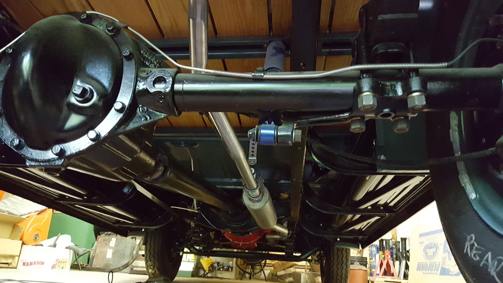

Be prepared to get creative on your hangers. There isn't a good place to support it near the rear fender so I had to get a couple of hangers and cobble together one to get the height I wanted. I hope that guy gets the length right cause you want some clearance from the rear fender so it doesn't make contact with the pipe. I have a spare tire mounted under there so had to mess with the straight piece's length, and twisting the tail pipe and over-axle pipe different ways in the loose clamps before tightening to get everything to play nice with each other.
I don't have a good picture of my exhaust and my truck is now stored five miles away. I looked through pictures but it was all of the engine area which is self-evident. But this is the only one I have. The spare tire wasn't in place yet.
Oh, Bob is very, very correct. When you install the pipes you want to do the manifold piece first and get a very firm tight hanger in place to support the weight of the next weight of the muffler.
