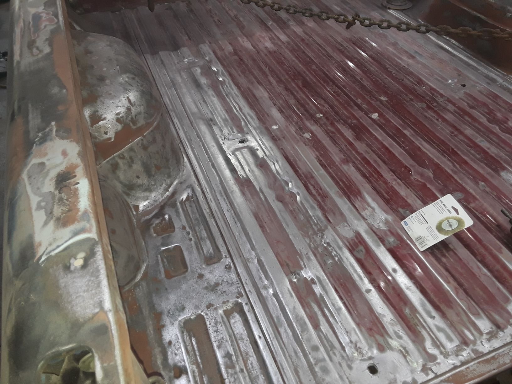

I just did this if you want to see it , its on my build page in my signature , the rear bolt holes line up pretty good , , the very front towards cab have to be drilled since that the area you cut down for a short bed conversion , the center braces as far as in proper place are ok but the center of bed bolt holes may be off , I laid my donor floor on truck with bed off and lined everything up an marked as needed , , I had to replace a center brace that was rusty and it pretty much was back in place of the old just had to drill center of bolt holes an weld up the rest ,,I didn't have any big issues other than a few welds to grind down after filling holes from drilling an the one brace for centering holes , my donor was off a 92 long bed , here are a couple of pictures were I am finishing up now, more pictures on build link

i'll check out the build thread, but was hoping more to just replace the floor with possibly a newer model floor. But if I were to happen to be able to get a long bed donor it's possible.

Yes its possible as mine was a short bed 79 , its not all that hard , but many spot welds to drill out , I bought the donor truck as a running truck , and sold it so I only have time in my bed no real money as I made it all back in the way I sold the donor truck

The wheel area does not need replaced in most cases , as the center of the floor is a seperate piece from the side with the wheel wells, the center of floor is around 4' wide , to do properly you drill out the spot welds from underneath at the seam as center of floor is a seperate piece ,,I thought about using those panels but unless it has the seal between the sides of floor with wheel well it will be a much harder task to do the job , plus the areas for the bolts have a area in floor that is recessed for the bolt , as with those panels I don't see it in picture and you could end up with a bed bolt close or in a ridge area , so I decided it would be easier to just do a swap and make it look more factory style
