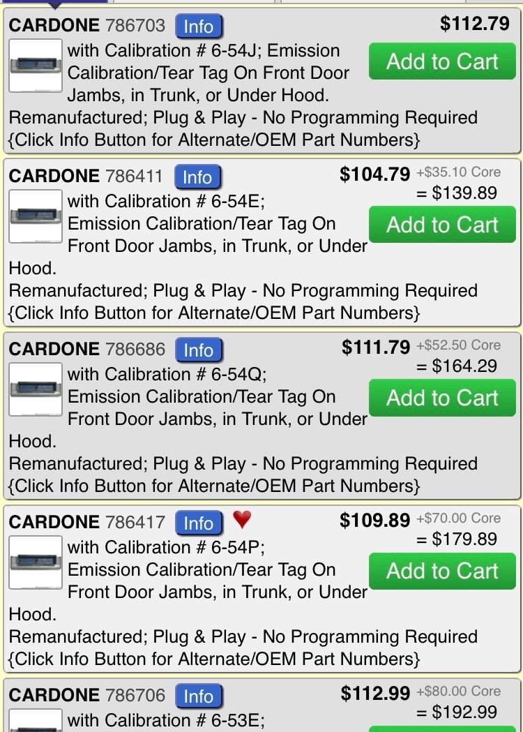

This is what Rock Auto lists as available. As you can they do not specify what transmission is in the vehicle. Does someone have a calibration code book for ‘96 to see if any of these would work?
