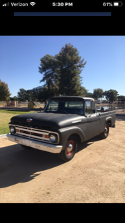

Hi all, Just joined the Forum. We just purchased a 1962 F100 with the 1960 bed . What are the best value suspension upgrades to drop the truck a little and add a small block V8. Thanks in advance for your input.
Jeff
