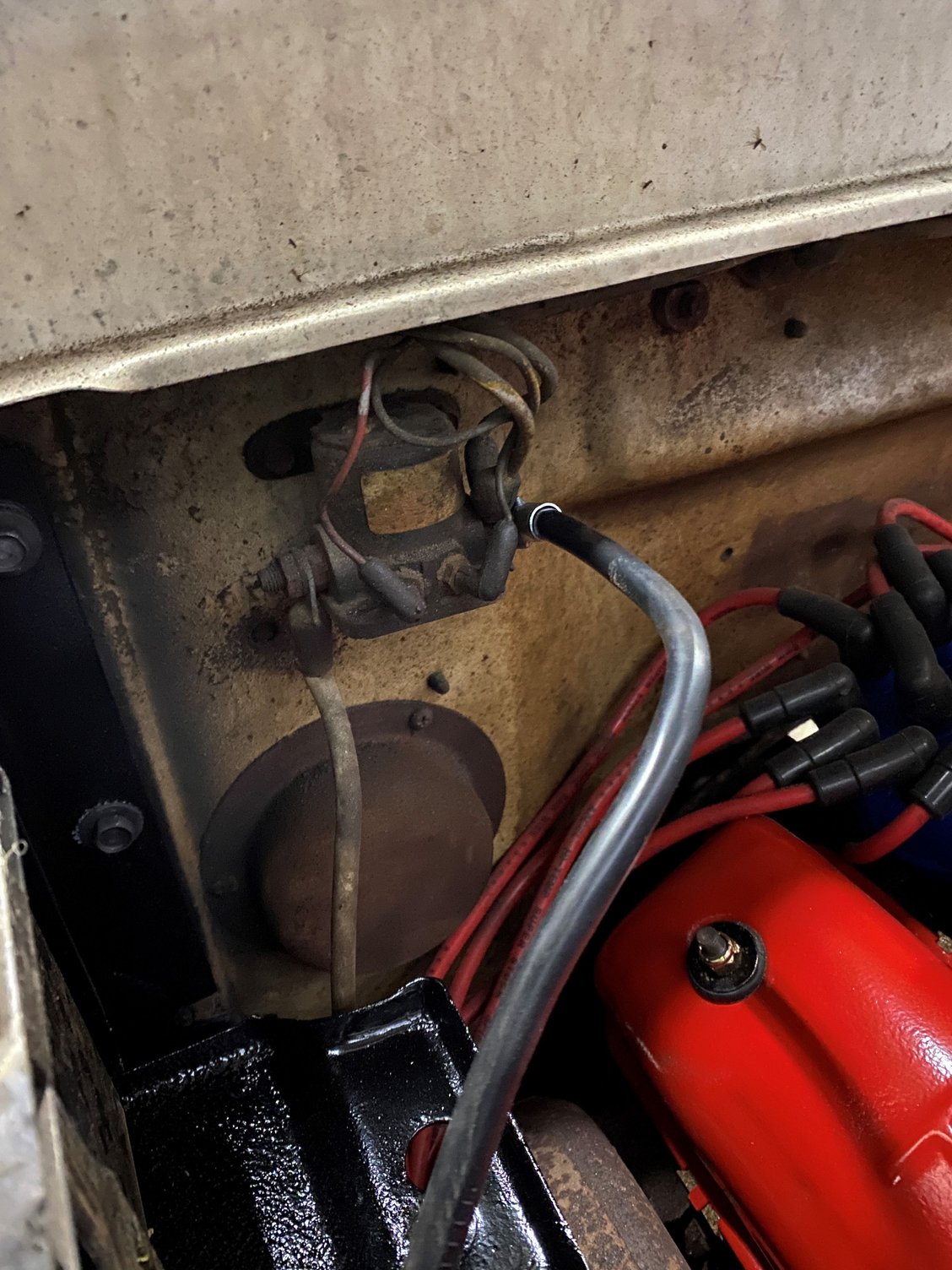

Is this what you mean
sorry I realized the picture was sideways. Perhaps this helps. I replaced both battery cables (the negative side and the positive side). The original battery cables were frayed badly. the picture here shows the only battery cable that goes directly into the starter solenoid which I replaced.
Is this the starter solenoid? If so are you referring to left hand side to disconnect? Thank you! Perhaps when I was replacing battery cable I jarred something? Or shorted something? Would the gauge of the battery cable matter? I went with 4 gauge. What would cause starter not to turn off? Is that the purpose to turn on and off starter? Is does turn engine on just not off. Thank you!

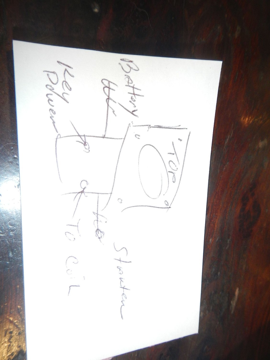

Is this how yours is wired?

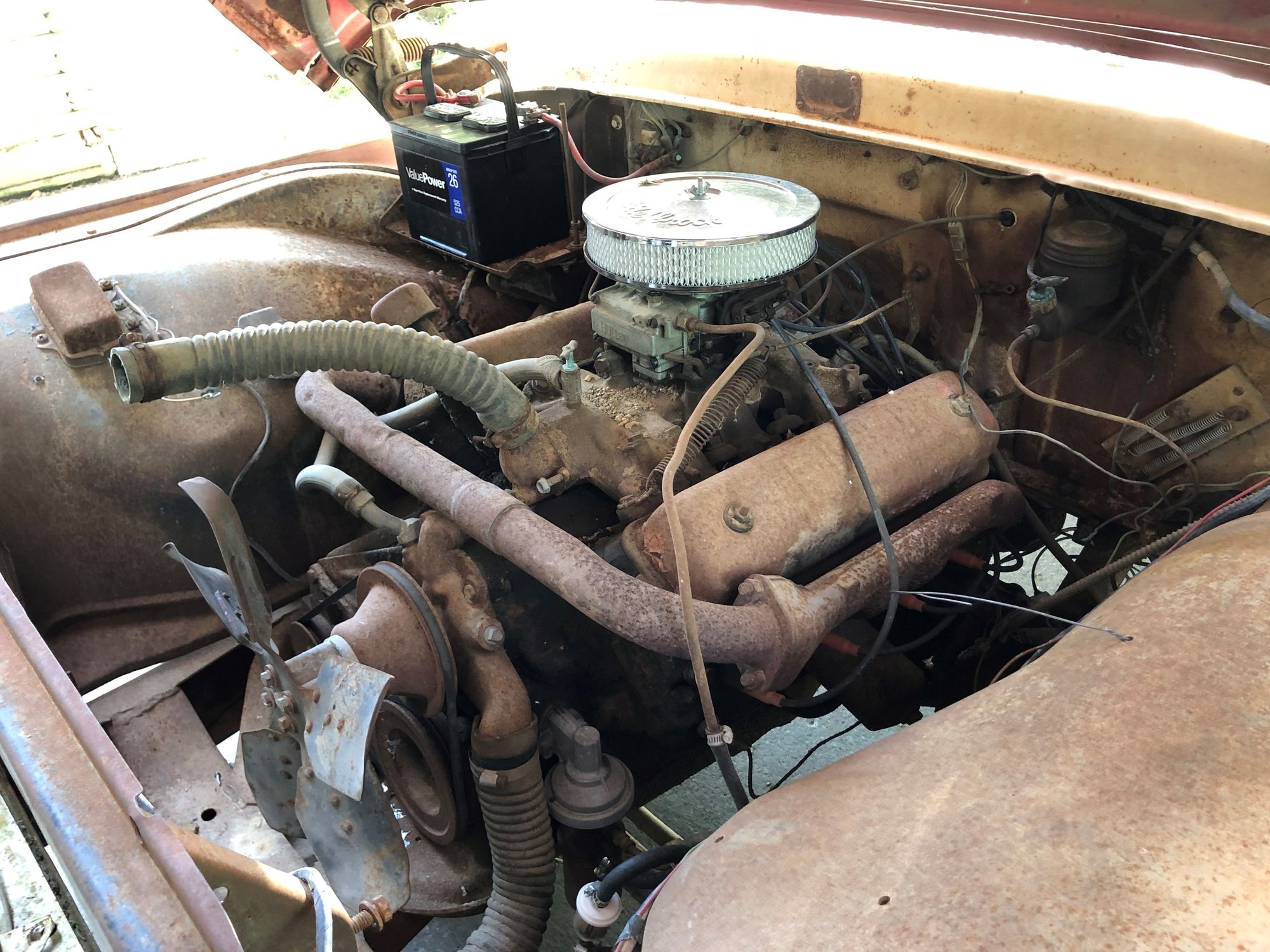

Here is a photo before I removed battery bracket and replaced battery cables. Is it possible the painting of the bracket and firewall where the negative side grounded into the firewall is interfering and either shorted out or not getting proper grounding?

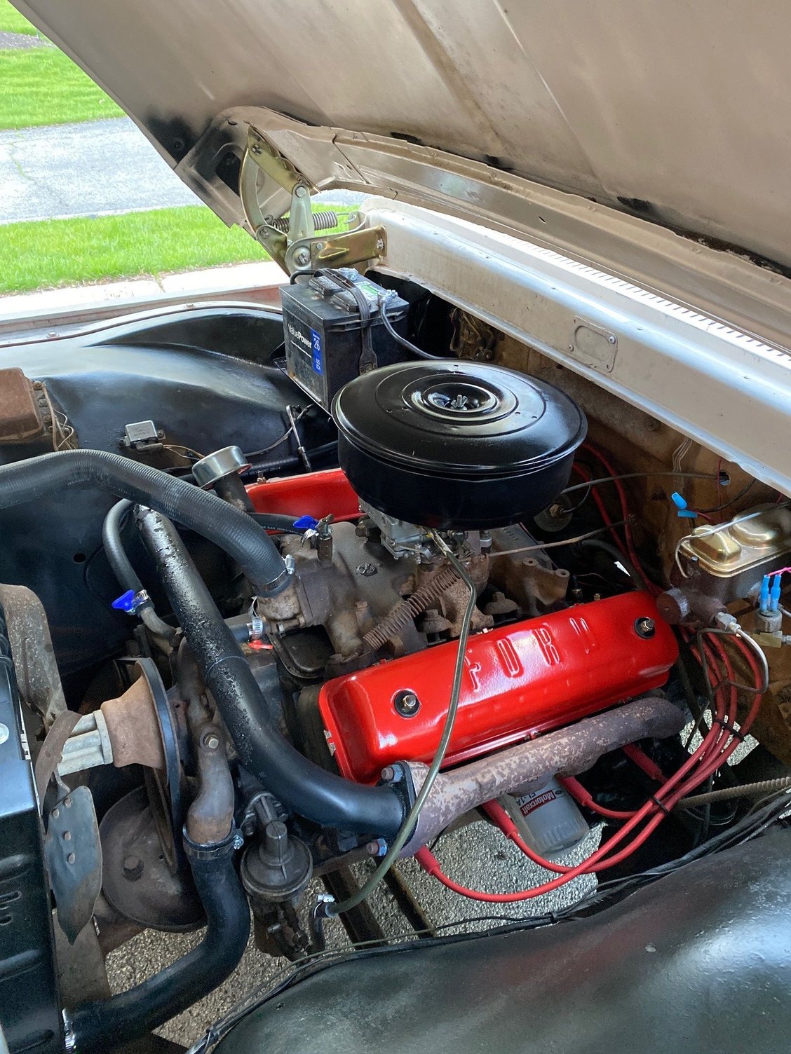

this is after I painted the bracket and firewall behind battery and replaced battery cables.

Old Apr 10, 2020 | 10:57 AM
Tedster9's Avatar
Tedster9
Joined: Apr 2002
Posts: 19,311
Likes: 97
From: Waterloo, Iowa
Getting 'er tightened up I see. My slick won't win any appearance awards inside or out, but it is reliable as anything, and I can hop in it and drive anywhere with confidence. Done it many times.
Not to nitpick, don't take offense pliz, but two things I see that could cause issue. One is the radiator cap - the older radiators in those days used a 7 lb pressure cap. Don't exceed this, maybe it isn't, though in the pic it suspiciously looks like one of those 16 lb el-cheapo specials. This is a good way to balloon the radiator or maybe the heater core.
Another is the battery doesn't look to have anything securing it to the tray, very important that a battery doesn't slide or rock, it has to be rigidly anchored, the internal plates and such can get damaged or even short out from potholes or on rough terrain if starts bouncing around. Bad Things can happen when that occurs.
