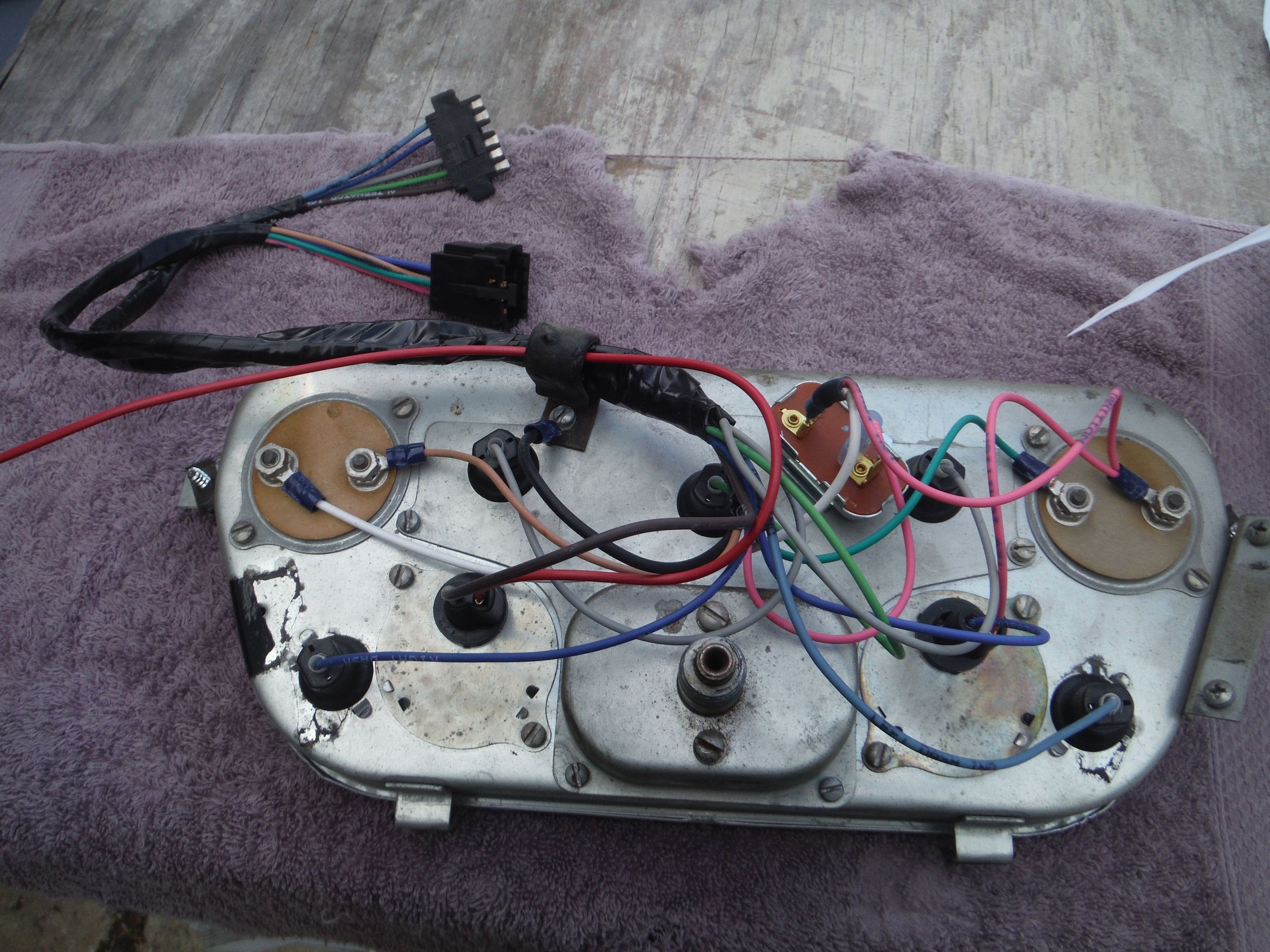

I am going to put a runts voltage reducer on my fuel gauge on my 1955 ford F-100. The reducer didn’t come with instructions. I found on the internet that the runts goes on the plus side of the gauge. The hot wire bolts to the end with a nut on it. And the fork connector goes to ground. Is the correct method.

From what I see that is correct. When I was rewiring my truck I did a lot of research on voltage reducers and read that a lot of people were having problems blowing out the Runts...so I went with an IR-1 voltage reducer. You don't need 1 for each gage you can run 1 for them all.
