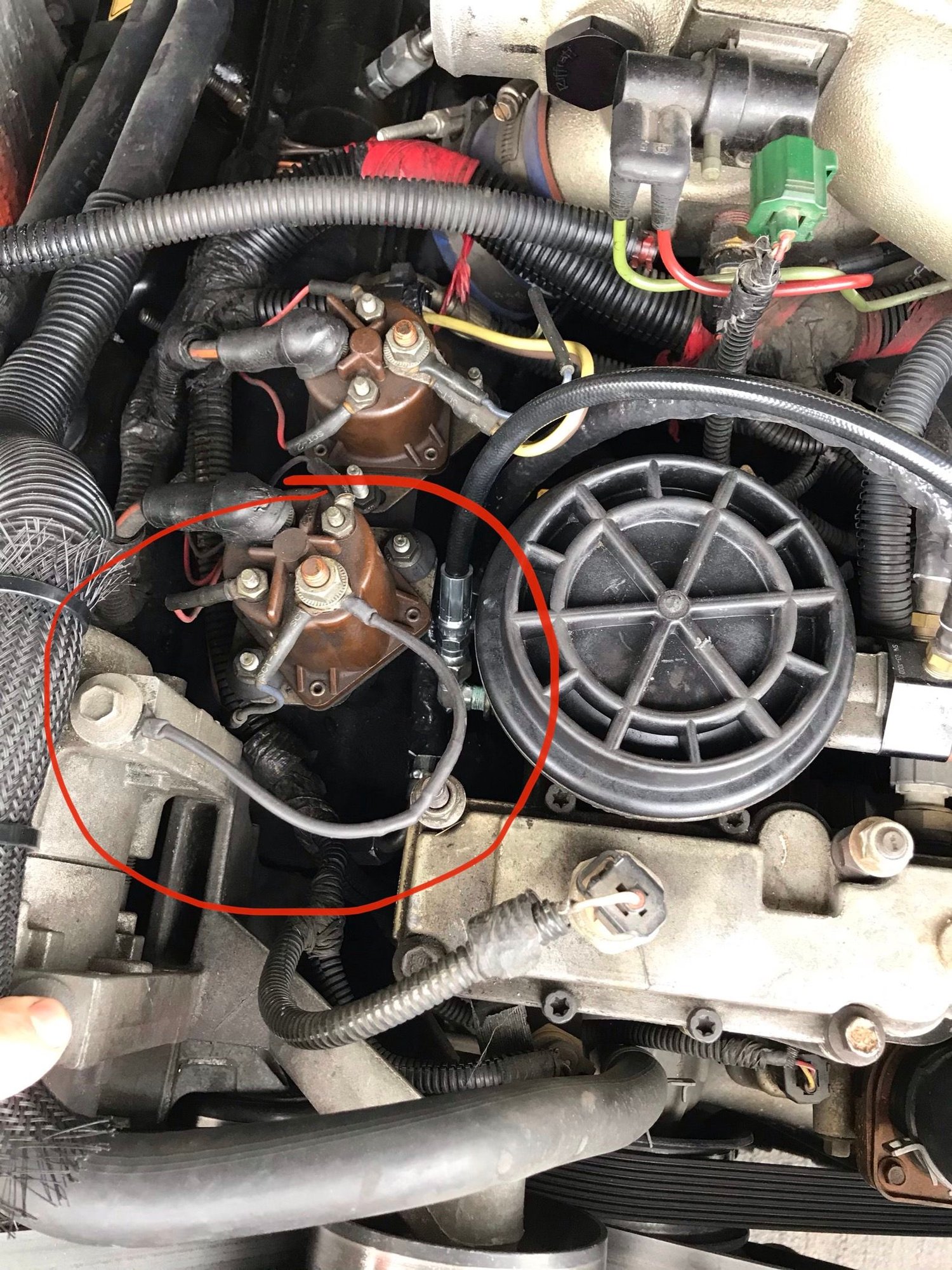

I’m not sure what the auxiliary sensor is or where it resides on the truck. Could that be a bad relay in the dog house next to the under hood fuse box?

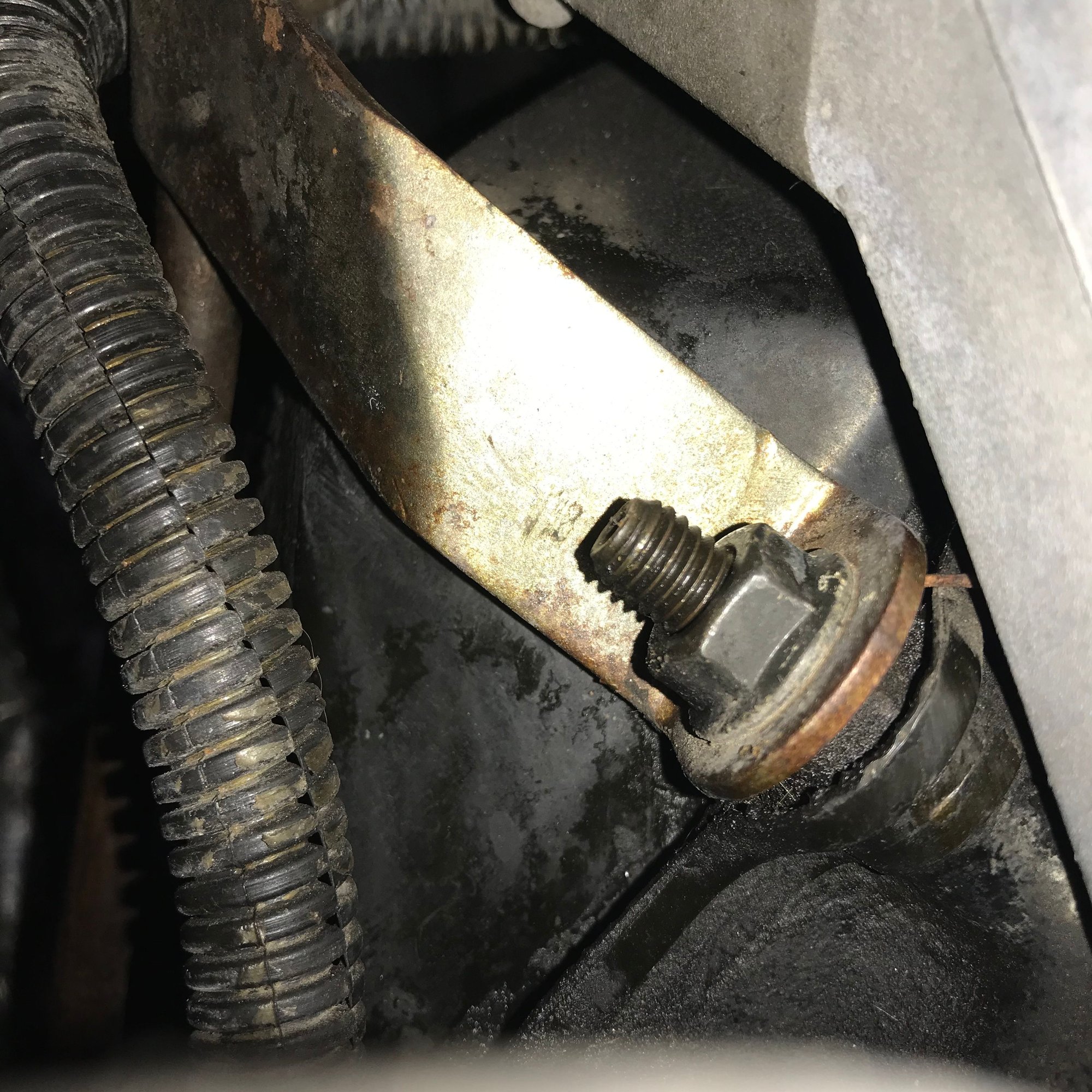

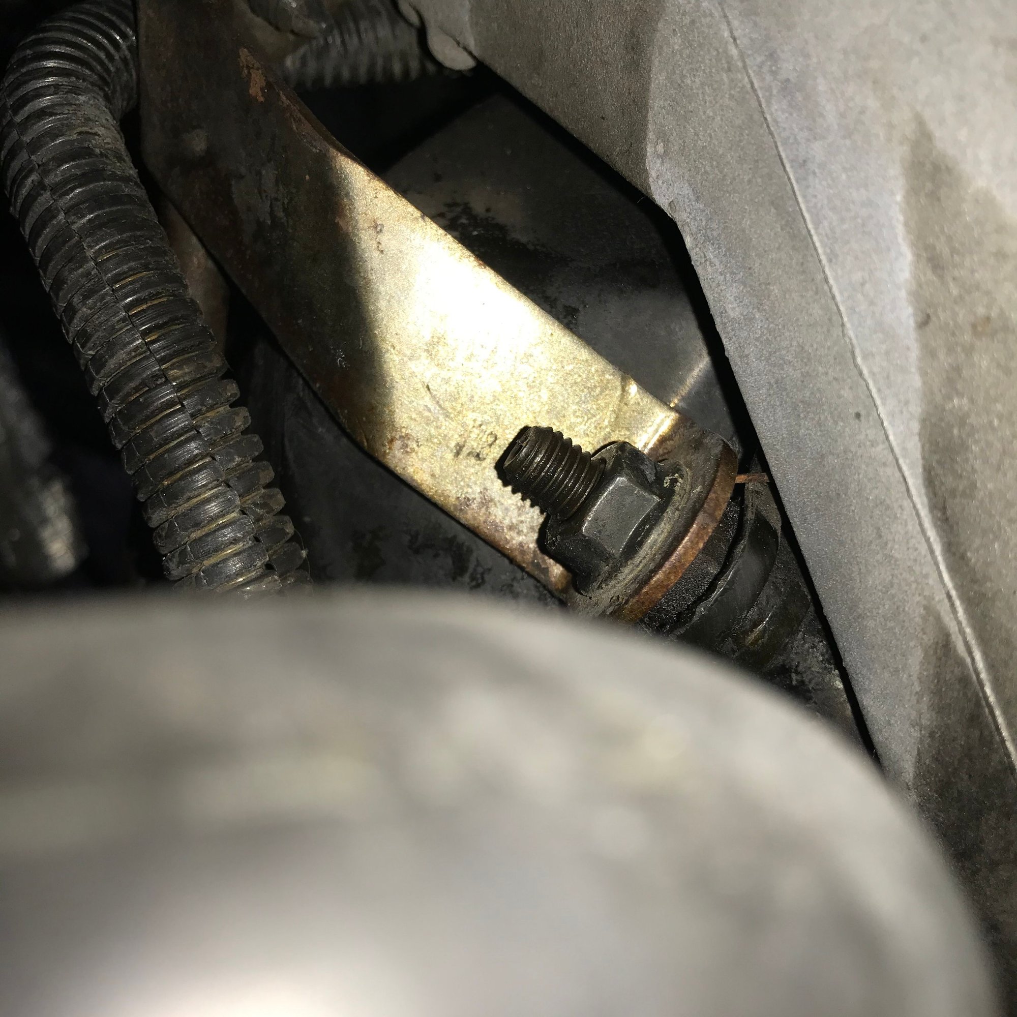

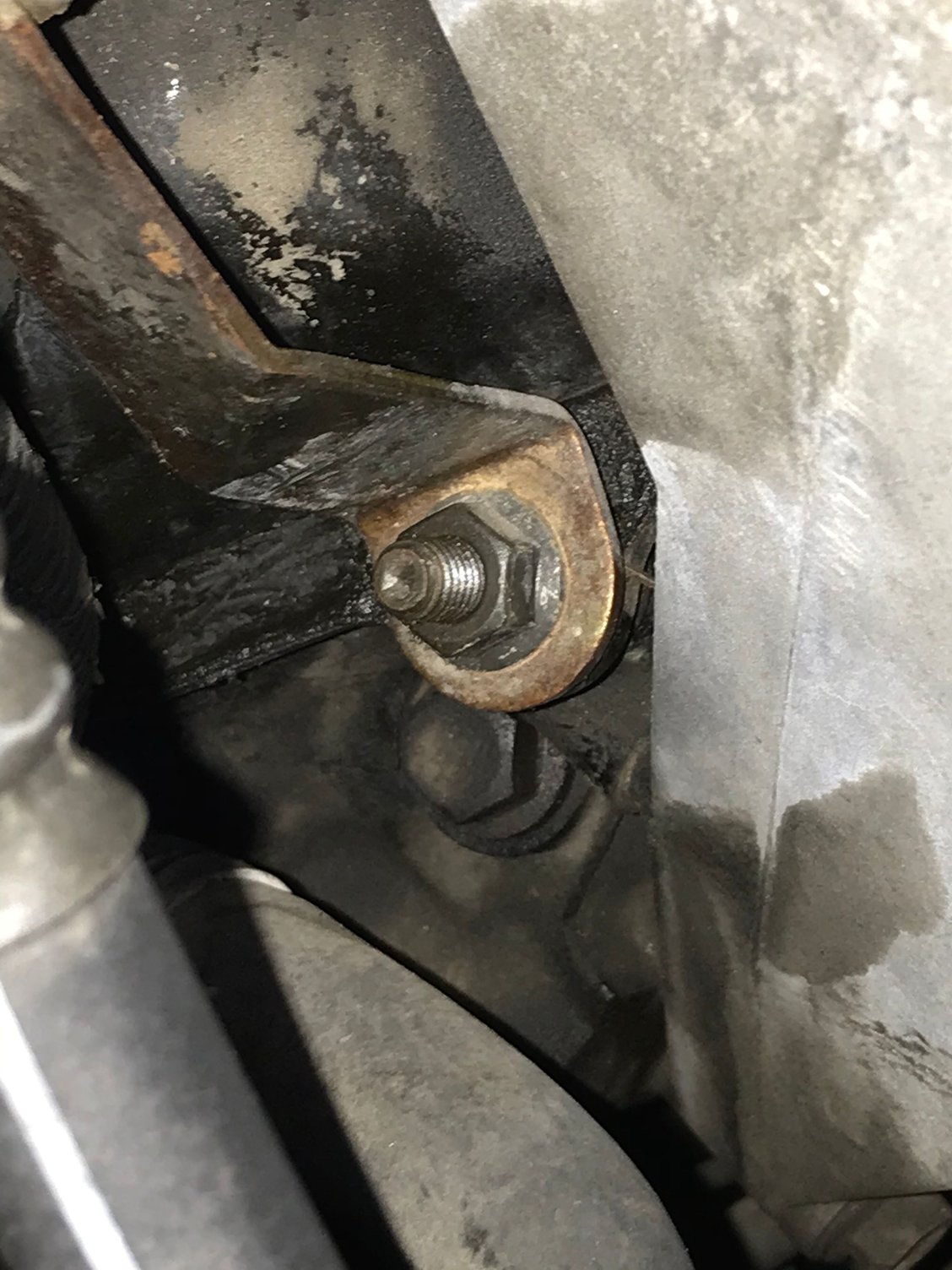

Is there a trick to removing the oil dipstick bracket bolt? I am afraid if I torque on the bolt it will twist the dipstick connection going into the pan. Strictly Diesel seems to sell a fix ( https://norcaldieselperformance.com/...iABEgKE1PD_BwE ) but at $300 plus tax and shipping that’s an expensive mistake.

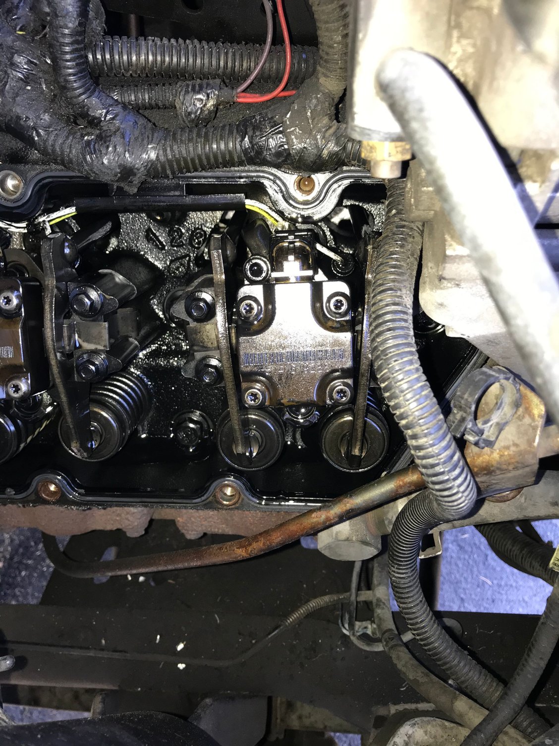

Here’s what I’m dealing with

What I have done in the past is soak the top nut wit penetrating fluid, then brace the bracket with anything you want. I have used a large screwdriver to an adjustable wrench. The use a 3/8 socket wrench with an extension and deep socket to try and turn it off while bracing the bracket to keep it from twisting or moving.
On a friend's truck, I ended up using a cordless Ryobi impact gun to break the nut loose while he held the bracket in place.
It has a bit of movement allowed in it, just not a lot...
This is the fitting that goes into the side of the oil pan. The factory version has a habit of loosening the nut and/or squishing the o-ring on the inside of the pan such that oil starts leaking out. There are cheaper options than this. The tube you are trying to loosen the nut for is separate.
Like Sous said, brace the bracket so it doesn't twist and then get an impact on it. Alternatively, grind a custom slim wrench (13mm if memory serves) to hold the hex underneath then get an impact on the nut above. Be sure to apply anti-seize to the bracket and nut when reinstalling to prevent future issues.

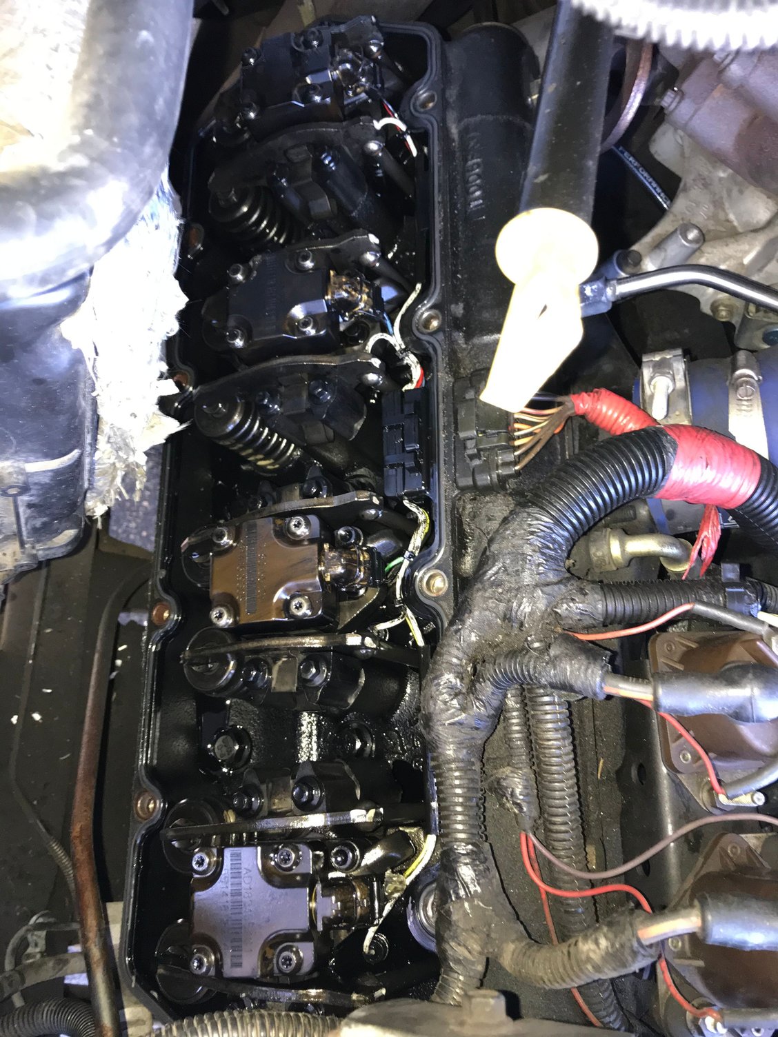

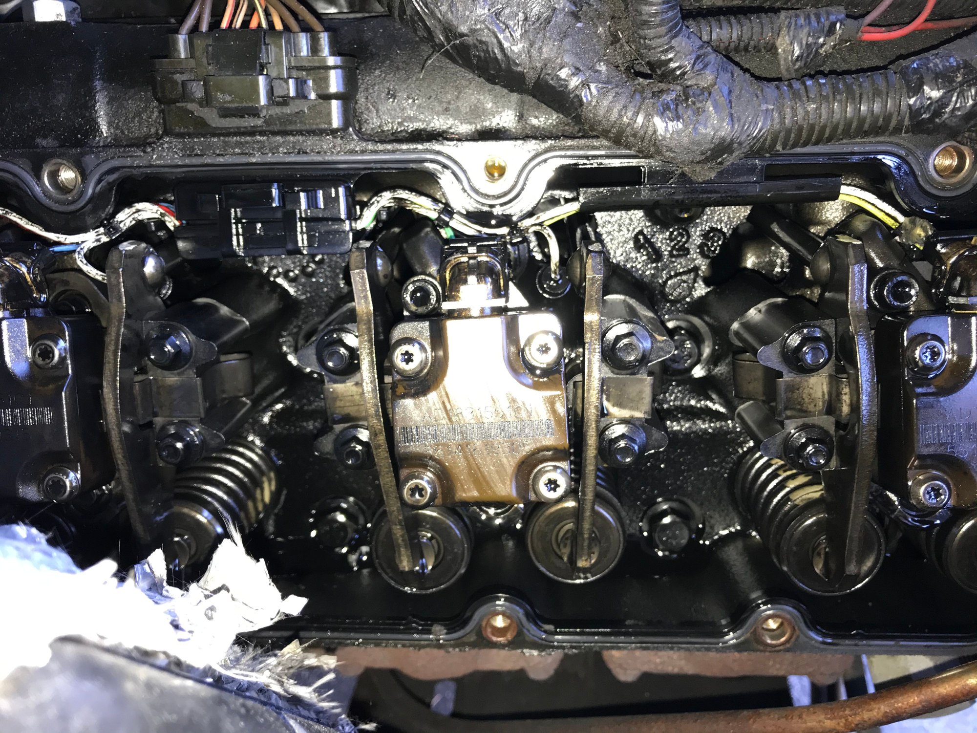

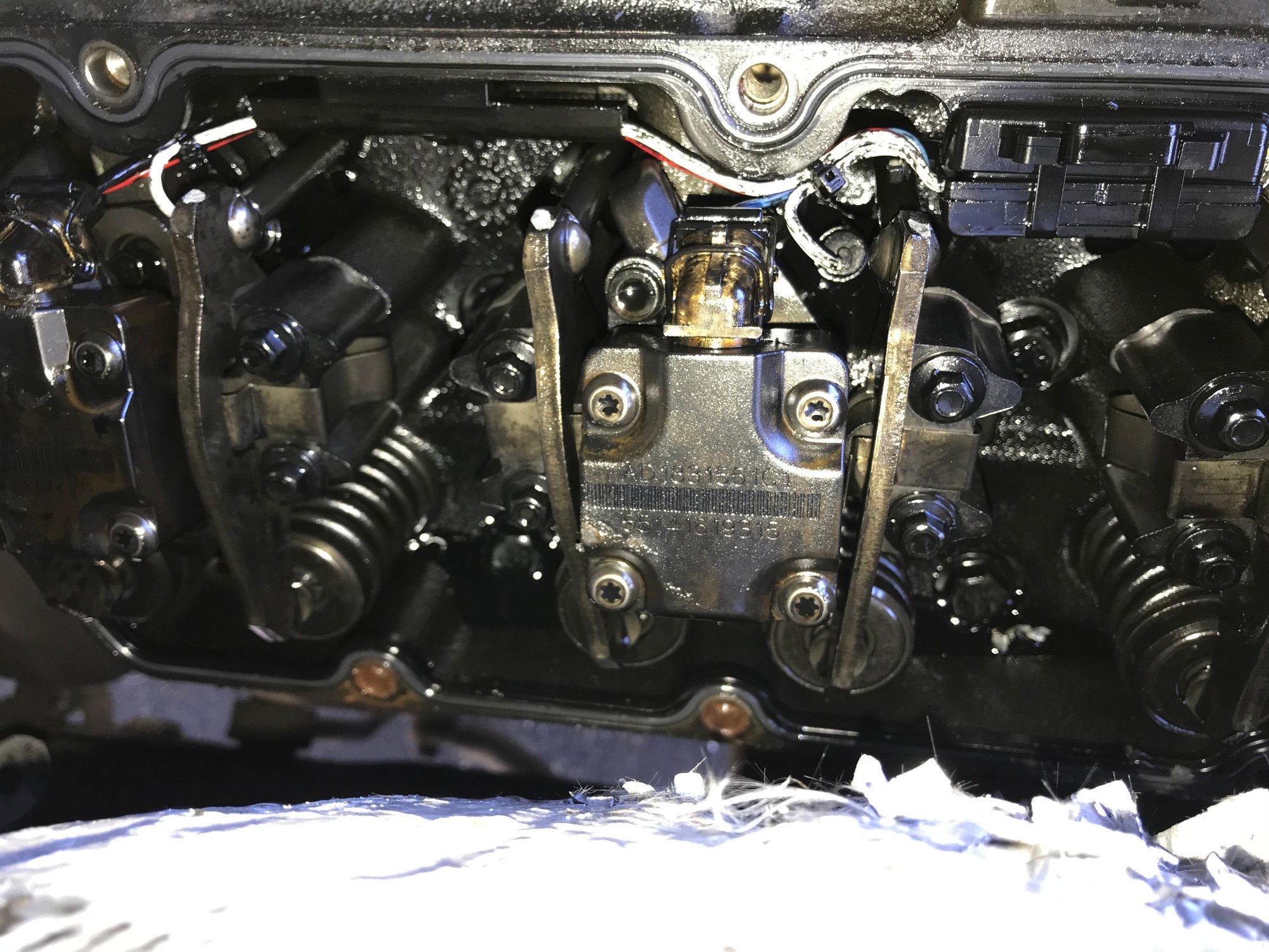

Valve covers off. Sous’ suggestion to brace the dipstick bracket and use an impact wrench did the trick.
back to the buzz test, does ForScan test in firing order such that the two soft buzz sounds at the end were 6 & 8 or does the test run in sequential order (1, 2, 3, ...)?
