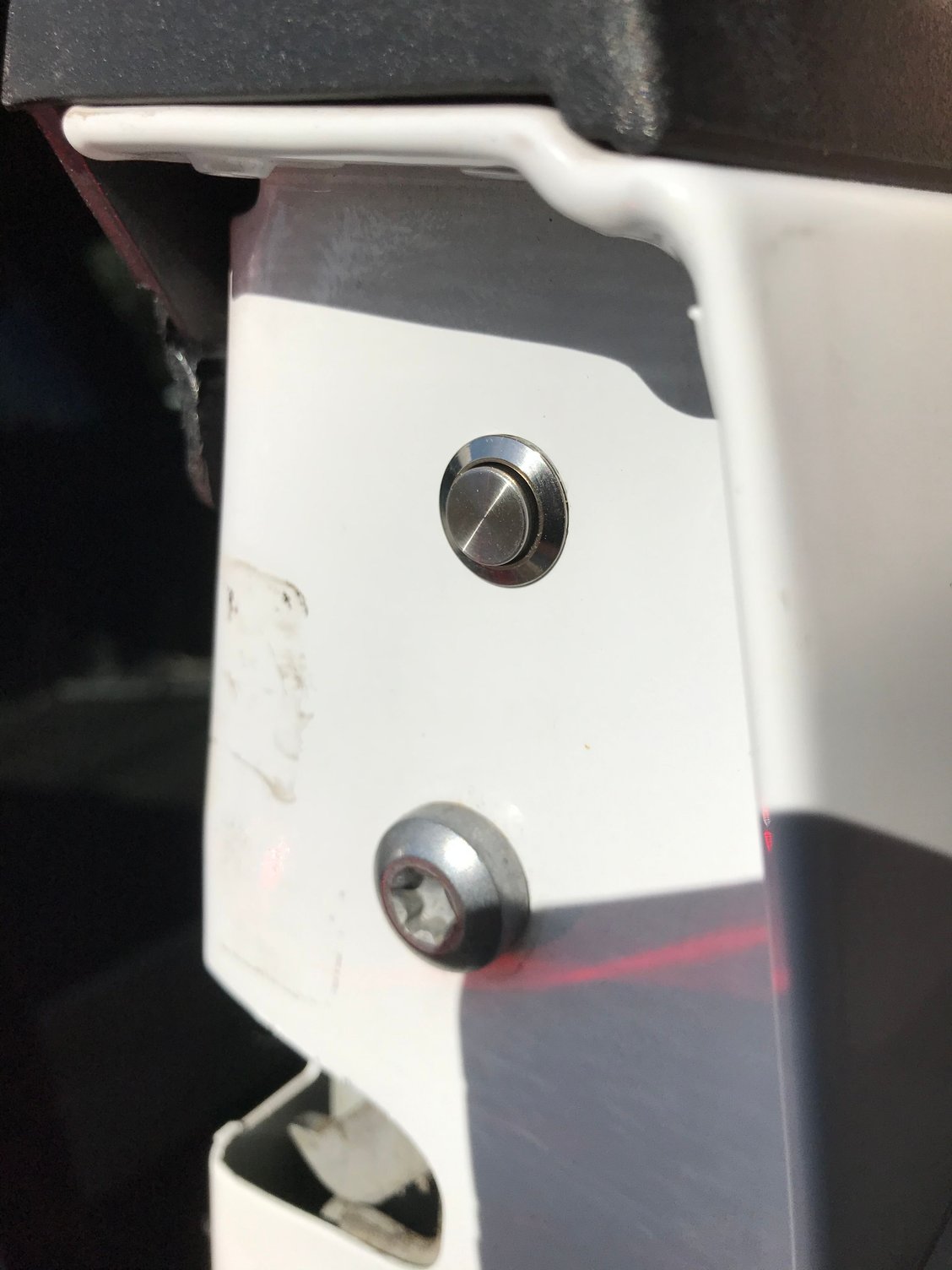

Installed a waterproof push button switch that turns the tailgate lock on or off. Works great and when I am wanting the truck locked but not the tailgate I just push the button and disengage the lock. Another push of the button turns the lock back on.

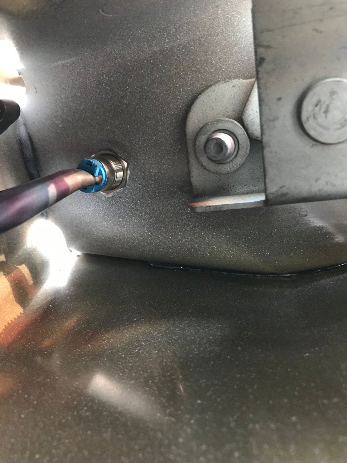

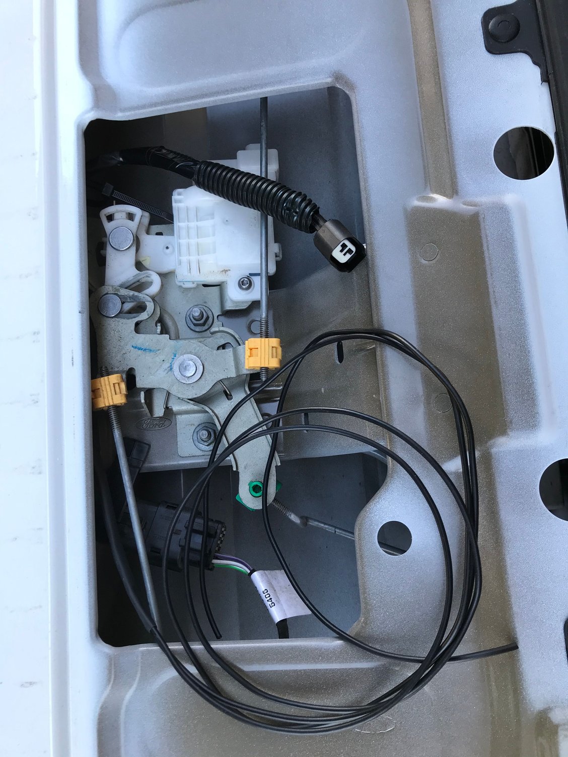

Cover off tailgate leads installed interrupting the solenoid

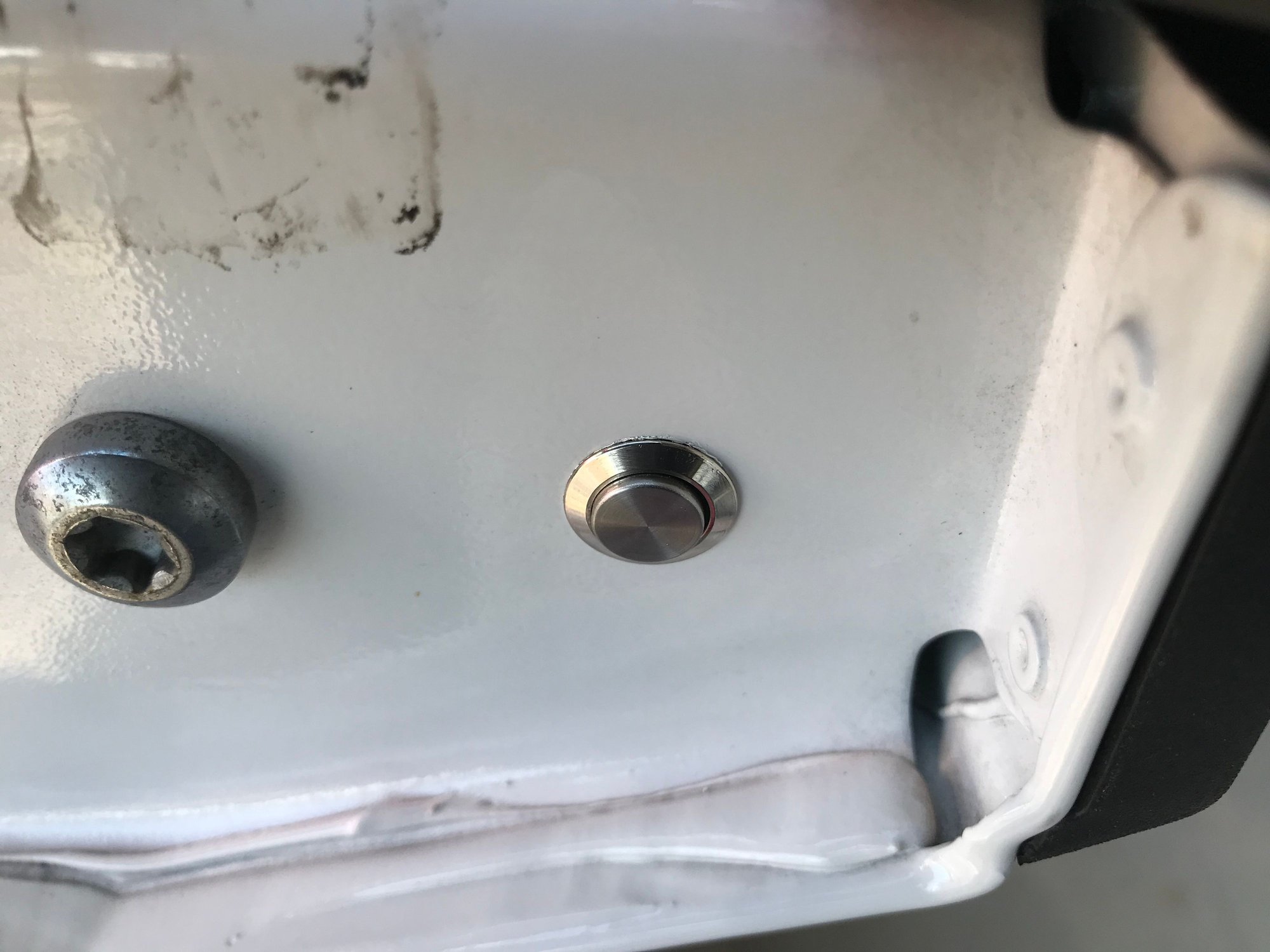

Switch installed
Back of switch inside tailgate

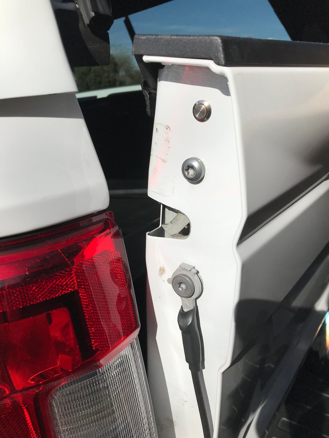

Installed

To the OP, did you isolate the two dissimilar metals when putting the switch in?
Old Mar 29, 2020 | 09:25 AM
cncroutingaz's Avatar
cncroutingaz
Joined: Nov 2019
Posts: 28
Originally Posted by porthole
I do something similar with my toolbox (has power locks). I have a witch inside the box for those times the truck will be left somewhere long term or have valet access.
This is something else to plan for when the new truck gets built.
after drilling the hole I painted the raw aluminum area inside the hole.
the switch came with a rubber grommet as well other than that no isolation
