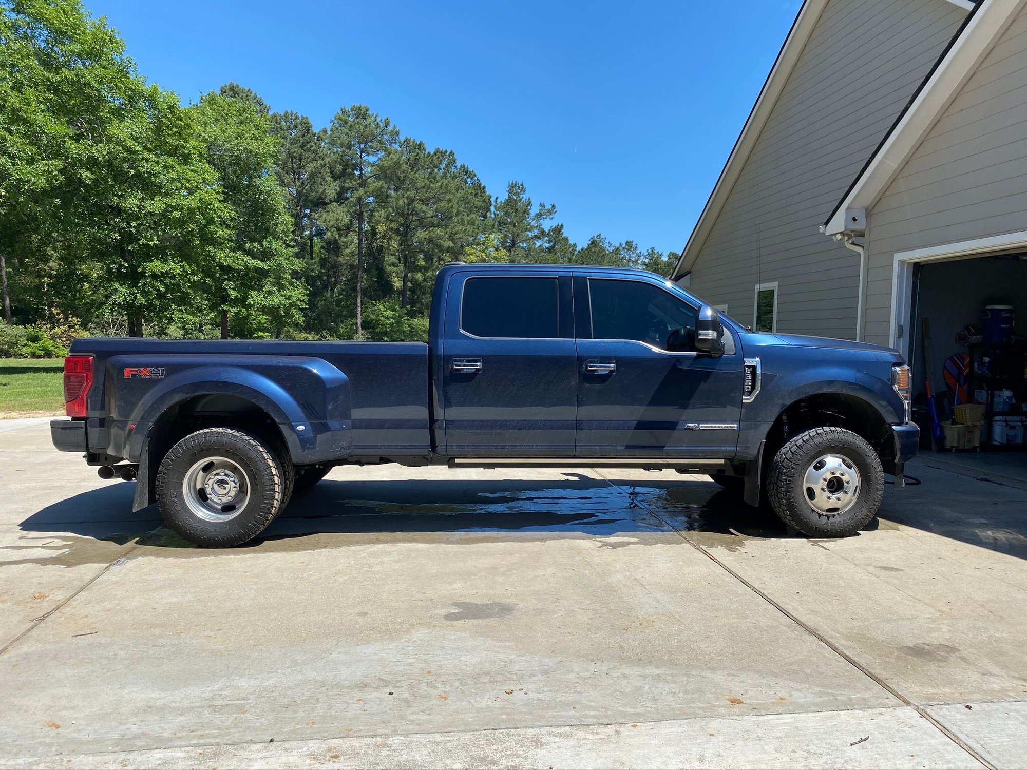

We ordered a loaded platinum in January. Had been waiting for info on silver spruce and had a deadline when we needed the truck so we decided on blue jeans metallic. Truck arrived two weeks early and we picked it up 3/11. It was the first 20 platinum they had and salesman kept taking pics to show their wives.
We bought this to haul our jeeps and customer jeeps around the country to Jeep events and to also provide pick up and delivery. My previous ford Dually was on 35s and had an aluminum flatbed for gooseneck clearance thanks to the lift it had. My wife refused to drive it so I wanted something she would drive and help me out with driving duties on these long drives.
Plan was to pretty much leave it stock. Well that didn’t last long. So far we have tinted all the windows including the windshield, added 285/75r17 Toyo open country at2, ordered a Carli commuter with 3” lift blocks. Hopefully I can get a toolbox/fuel tank combo installed and weightsafe 3” hitch too.
After talking to some folks about mods it seems like we’re going to be some early adopters of things and wanted to share our build and answer any questions guys have. The reason for the lift block is stock, when we hook to our 28’ car hauler the rear sits about .5” lower than the front.
When we brought it home.
Brett
How it sits today

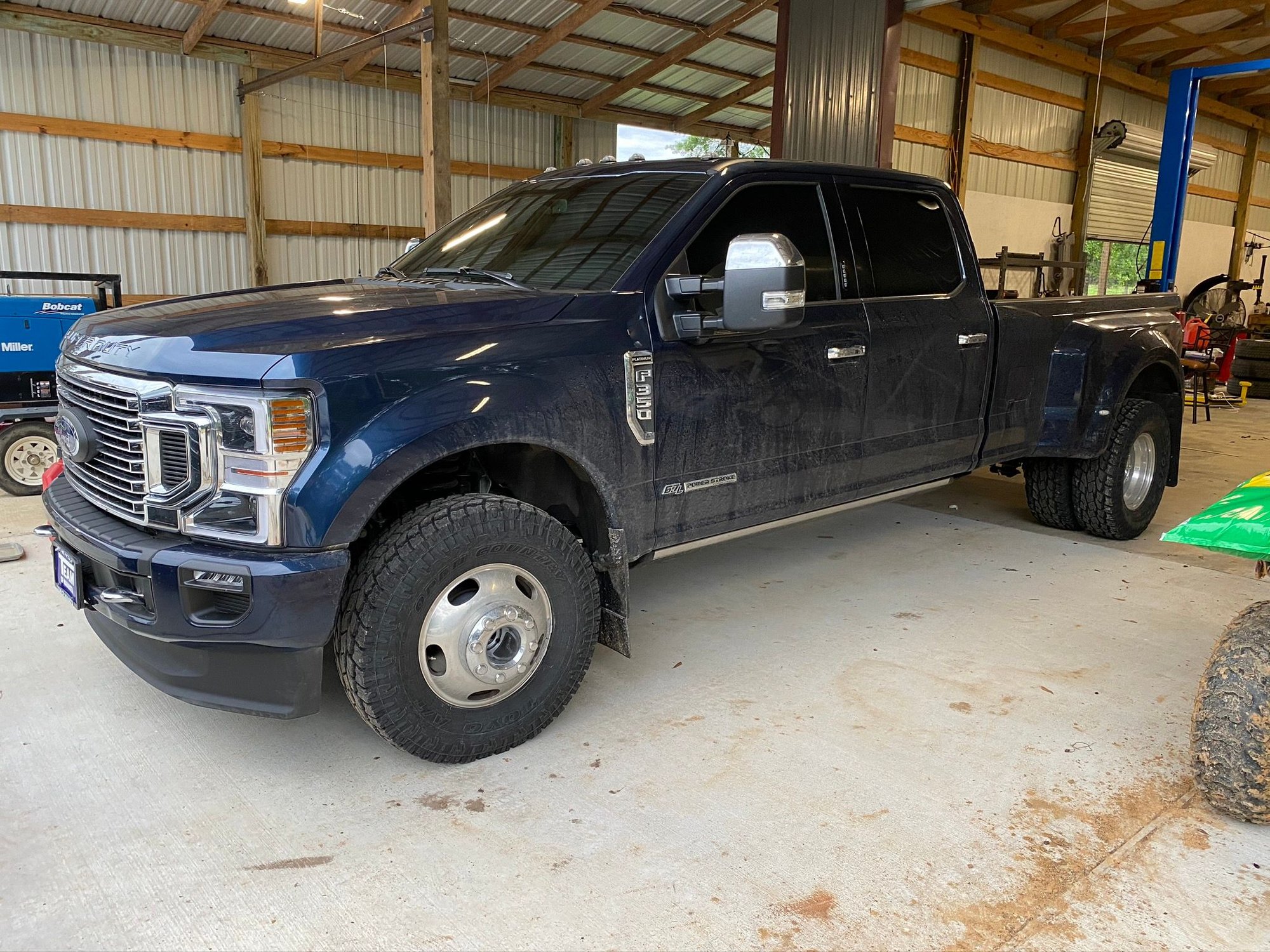

Here’s how it sits now. Once the tires were in I considered leaving it alone and not lifting it. However, I rolled the jack out and lifted it to the new ride height and I quickly changed my mind. Lift will be here Wednesday and I’ll put it on then or hopefully Thursday! The Dually was a curve ball for a bunch of folks as we try and figure out the new ride height on the 20s. I’m hoping I chose the right block but worst case is I’ll have to swap it out.

Any spacers between the rear duals?

.25” spacer. Originally was going to run 35/12.5 but didn’t want them sticking so far outside the fenders and needing the 2” spacer. It’s tight but the clearance should be fine.

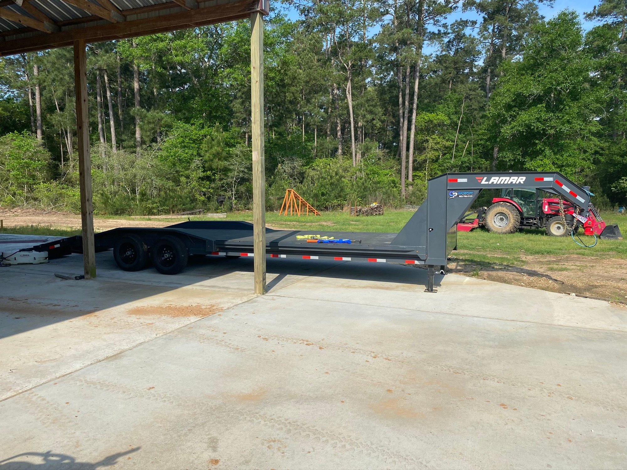

Ordered a lift for my trailer too. Didn’t want to worry about smashing my bedsides. Should be here next week to get it installed. Will also help with ground clearance! Might have to upgrade these tires too so it doesn’t look like it missed leg day!

I lifted my gooseneck too.

did you use an axle flip kit, putting the springs on top of the axle? Do you like it still? I bought an aluminum flatbed for my last lifted truck because I didn’t want to crush the bed, don’t know why I didn’t think about it then and saved 5g!

They built a subframe. Got 4 inches.
Really I should have just went with a dexter 2 inch bolt on lift. What I originally suggested. I notice now my ramps are too high so I will need to throw blocks under them. I was too busy at the time to stop by and talk to them.

Im sure I’ll have that issue too but since I’m only loading 6k jeeps, I doubt I’ll worry about the ramps. They fold flat now so it would involve me putting blocks or something under it. First time I load, I’ll see how much deflection there is and go from there. I’m hoping the flip kit gets here soon so I can knock it all out this week.
The rear blocks for the truck didn’t ship with the lift so I’ll be able to see it with the stock rear and get accurate measurements vs knocking it all out at once
