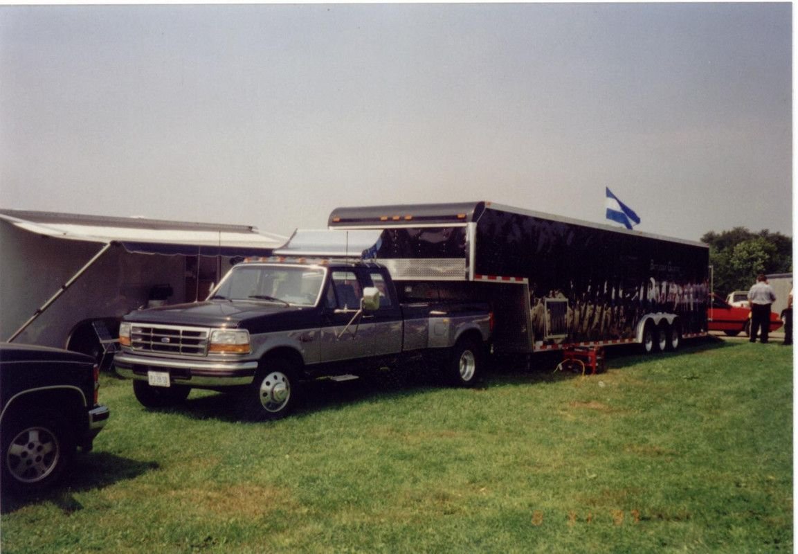

My truck got 10 mpg daily driving around town with some highway mixed in getting to work It got 7 mpg pulling my trailer. So you are in the ballpark of "normal". I don't recall any mileage increase with boost? But it surely accelerated easier even with just 1# of boost just driving easily around town(boost gauge barely moved). When I traded the truck in, I removed the vortech. It was like someone took 100 hp away? It was a complete slug around town. I was amazed at the major improvement that it made off idle.
I'm curious as to what the powerband is like in those old motors? Would taking gear out help? Like I mentioned above, my current F150 has 3.08 gears and it's horrible on the highway(and around town) compared to my previous truck with 3.31 gears. My big question is would just adding a GV unit help enough to warrant it? It would be about the easiest upgrade compared to a full blown motor conversion. I don't see a stroker Windsor helping that much? The only thing it would have going for it would be better flowing heads, but in a low rpm/torque application I don't see that as much of an improvement.
Were those 460 roller cam? Maybe a cam change would increase power slightly at lower rpm, that with the GV might get you enough improvement to be notable? Get up to 15+? that would be a 50% increase and I think the simplest fixes. Maybe headers and free flowing exhaust?
GV is $2500
cam $400
headers $700
exhaust $700
total $4300
