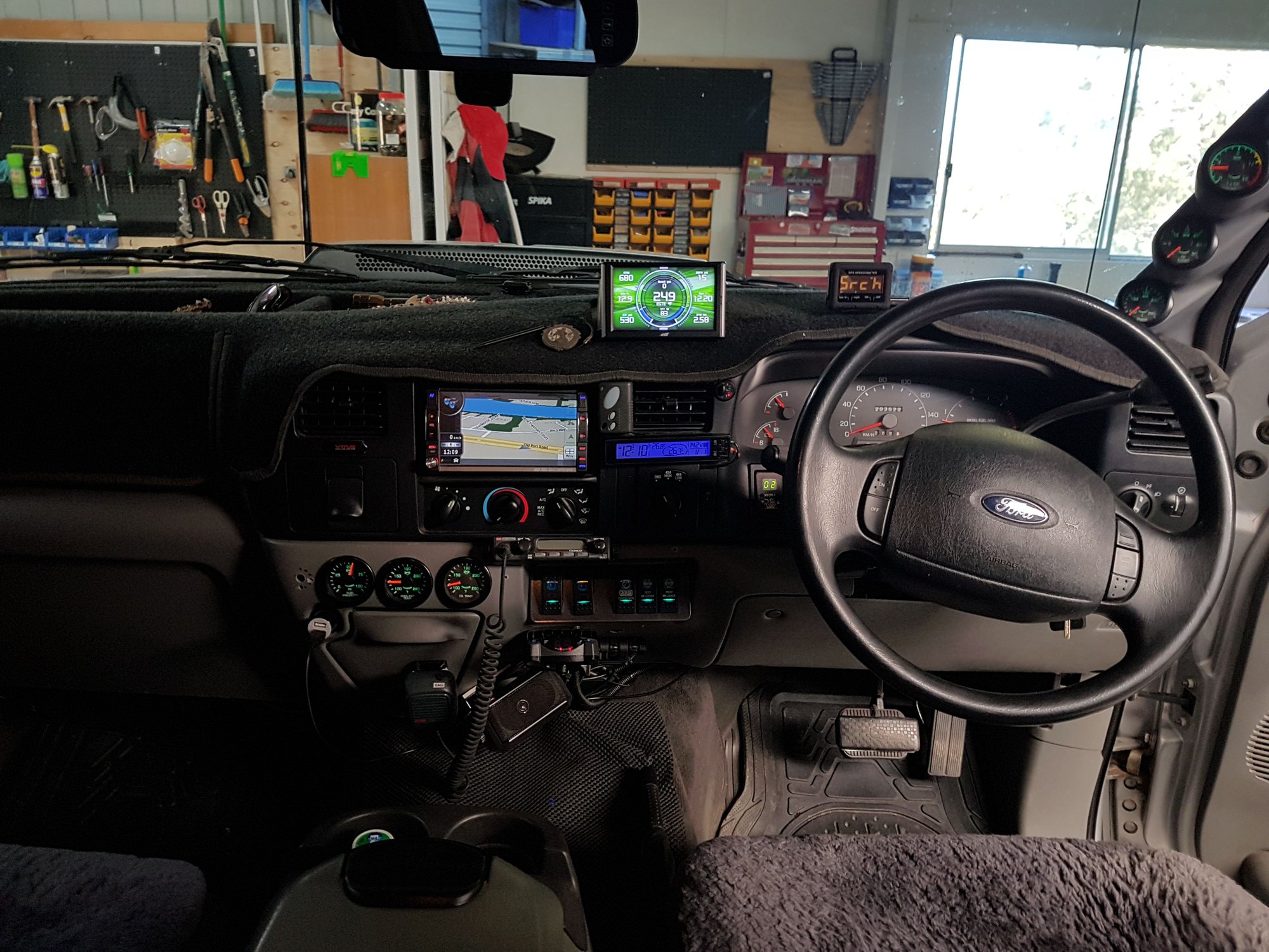

A-pillar gauge pod on the right errrr wrong side too!! I’ve actually never seen that before. Very cool, but
so weird!!!

I thought that shifter would be on the left..
Do you have the same or mirrored shift pattern on manuals..?

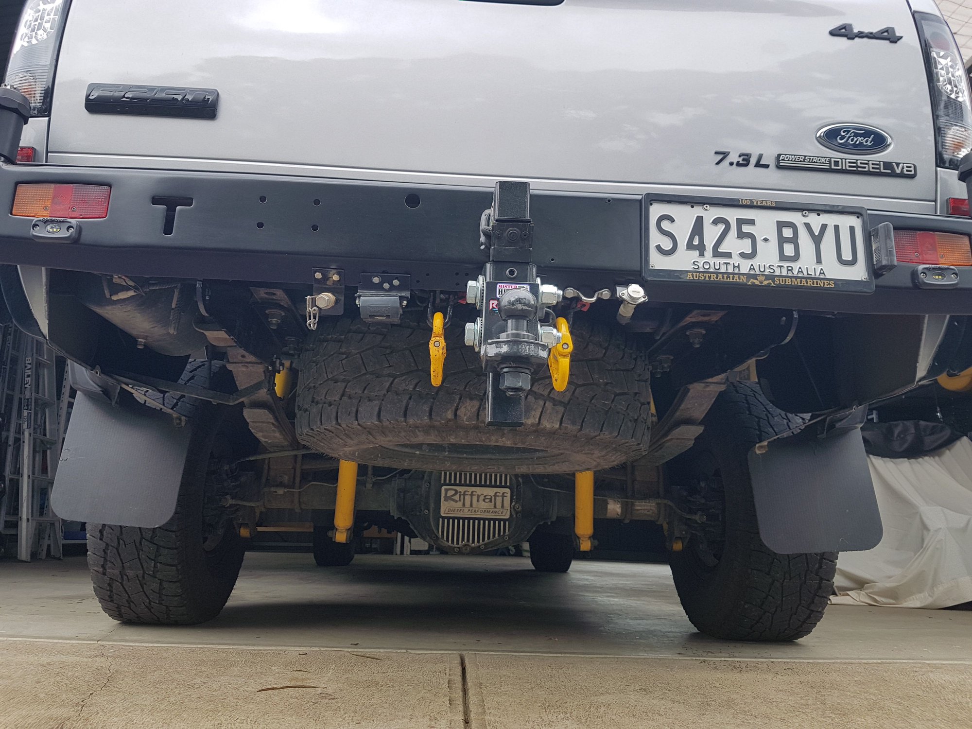

I'm not sure what the difference is my self . Do you fellas have as standard from factory 4 x Rear Shocks?
Mine is lifted about 2.5 to 3" with a set of ARB Old Man Emu (OME) rear Springs and Shocks. The front has Blue Max 3 Leaf Parabolic springs.
The Brazil made F-Trucks were made to the Ford Australia required specs.
All foreign made vehicles imported to Australia have Australian Engineered and tuned suspension designs built in.
I've put a few pics to see if you can point out the difference.

That's the first 4 shock rear end I've ever seen.

Exactly. No North American will find this factory built setup under their Super Duty. But all the Aussie spec Super Duties have bi angular quad shocks in the rear, as well as additional frame reinforcement brackets, inside and outside of the frame web, to distribute the "shock" loading.
Note that this is not the case with the newer Harrison converted and imported Super Duites. This distinction will only be meaningful to those down under, who will know what I am talking about.
For the Yanks among us, briefly, Harrison is a three store Ford truck dealer in Australia, who began converting and importing USA built (and some Mexican built that were NAFTA'd stateside) trucks to Australia, once the plant in Brazil stopped producing them in 2006. Harrison has gone so far as to purchased an abandoned supplier building in Michigan, near the Detroit auto industry hub, where their convincing conversions, complete with remolded parts, takes place.
But these later model Harrison modded Super Duties do not have the factory built Brazilian rear ends that Diesel Submariner (and that almost every other Australian on FTE with this vintage {up to 2006} truck has).
