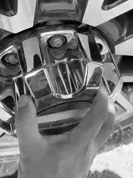

I’m swapping wheels on my ‘18 F250. I currently have 18” wheels and going to 20” wheels. I noticed the caps are different, mounting flanges look the same. What type of lug nuts do I need and where is the best/cheapest place to buy replacement?
also are there any aftermarket splined nuts that will fit with OE caps ?
These are the 20’s I’m switching to
Currently on truck

The stock lug nuts will secure the wheel. They will not secure the caps. I did the swap today. The stock caps off the 18’s will snap on the 20” wheels with ease. But the stock 20” caps will not securely grab.
i need lug nuts like the ones posted above.
does anyone have a part # or common place to order besides stealership ?
thanks

This is the stock 18” lug nuts on 20” wheels
i tried again the 20” caps

these are the caps and the lugs I need
would you happen to know part # or replacement Dorman # Lug ?

Pretty sure these are correct, but ford is about the same price when you consider you must buy 4 sets to get 32.
https://www.carid.com/dorman/chrome-...CABEgKF4_D_BwE

this looks about right
