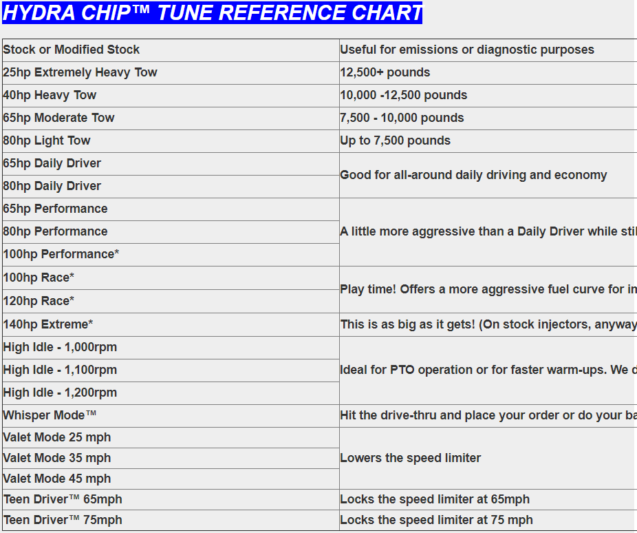

@aklim , As I stated in my earlier post, CNC Fabrication is a "dealer" (not tuner) for the PHP extended library of tunes which on the CNC Fabrication site it is called "Titan Unlock" as seen in the link below.
Titan Unlock
As you can see from the list below, all of the standard PHP tunes are available in the Extended library, but they are built for modified injectors like 160/80 or 205/100.
