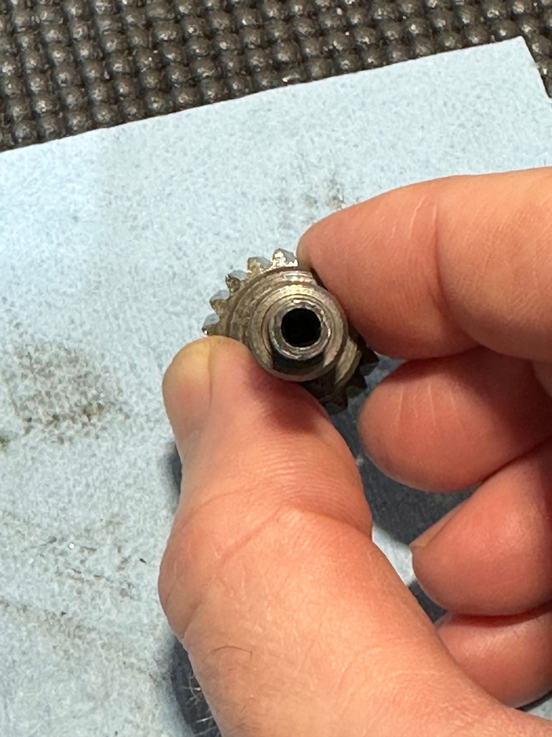

Thanks very much. I have ordered a new one. The one I have is new (previous owner bought it) but the end at the gear side doesn't fit into the gear. I've attached a couple of photos. The cable end is a hex and the gear appears to be round and is smaller in size. Not sure if the cable sitting in there damaged the inside of the gear? I hope not because the obsolete parts web site referenced below indicates out of stock.
