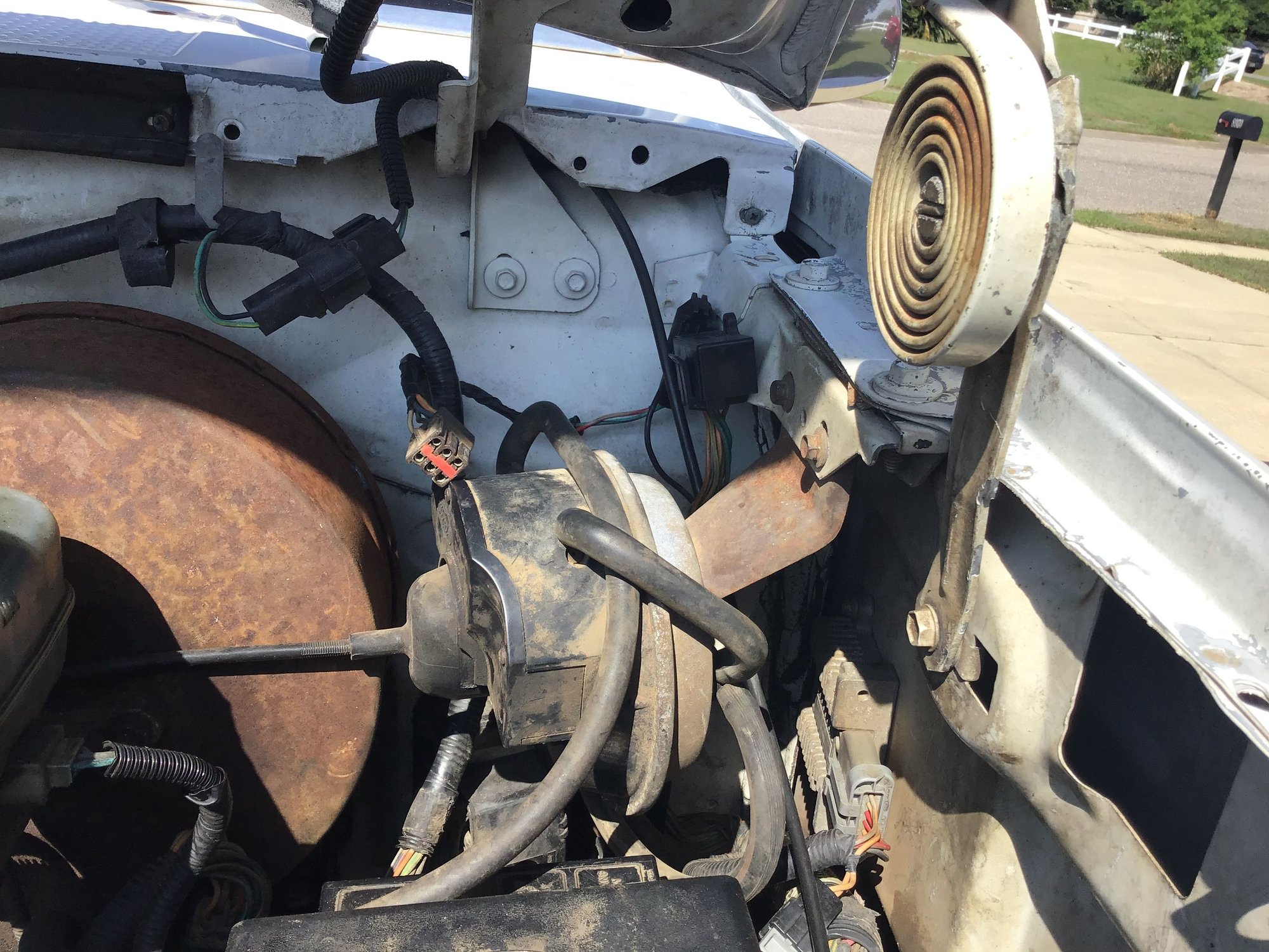

The cruise control? Mine looks like this and has a 6 wire plug that is showing. (The cruise does not work btw never did)

I caught the RABS-I based on your 1992 MY, but did overlook your truck also uses the older style vacuum-servo speed control system. Looks like Bill has the updated info for you.
