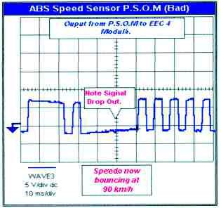

It is not the transmission as the yellow ABS lamp is on.
A breakout box will not help you unless you use it to see the wave form on the wire from the PSOM to the PCM.
But we know that the wave form from the PSOM to the PCM is bad.
The problem would be between the RABS module/PSOM and the rear end (maybe bad wiring).
Could be bad bearings or bad tone ring in the rear also.
This is why the wave form needs to be checked on the input to the PSOM.
Anstand alone shift controller will not help the yellow lamp for the RABS.
Attachment 281981
Attachment 281982
Attachment 277289
Attachment 277292

When you get a code 452 you do not look at the transmission.
The PCM says it is not getting speed information from the PSOM so it ups the transmission pressure and this higher pressure causes the hard shifts.
Continuous Memory DTC 452 indicates the PCM detected an error in the PSOM output signal during the last 40 warm-up cycles.
Possible Causes:
-- Damaged Rear Anti-Lock Brake Sensor.
-- Damaged PSOM.
-- Damaged harness circuits.
-- Damaged Powertrain Control Module (PCM).
