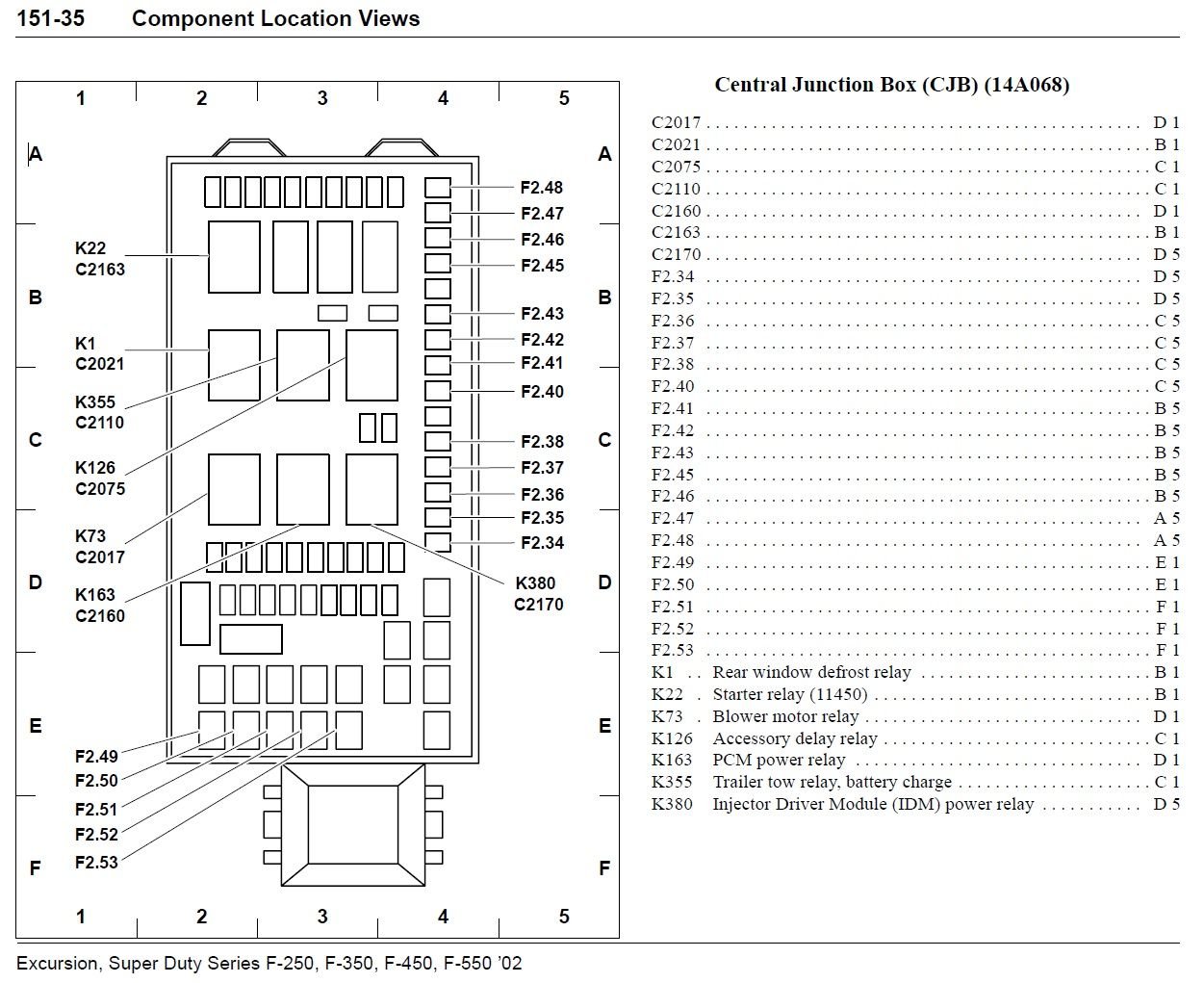

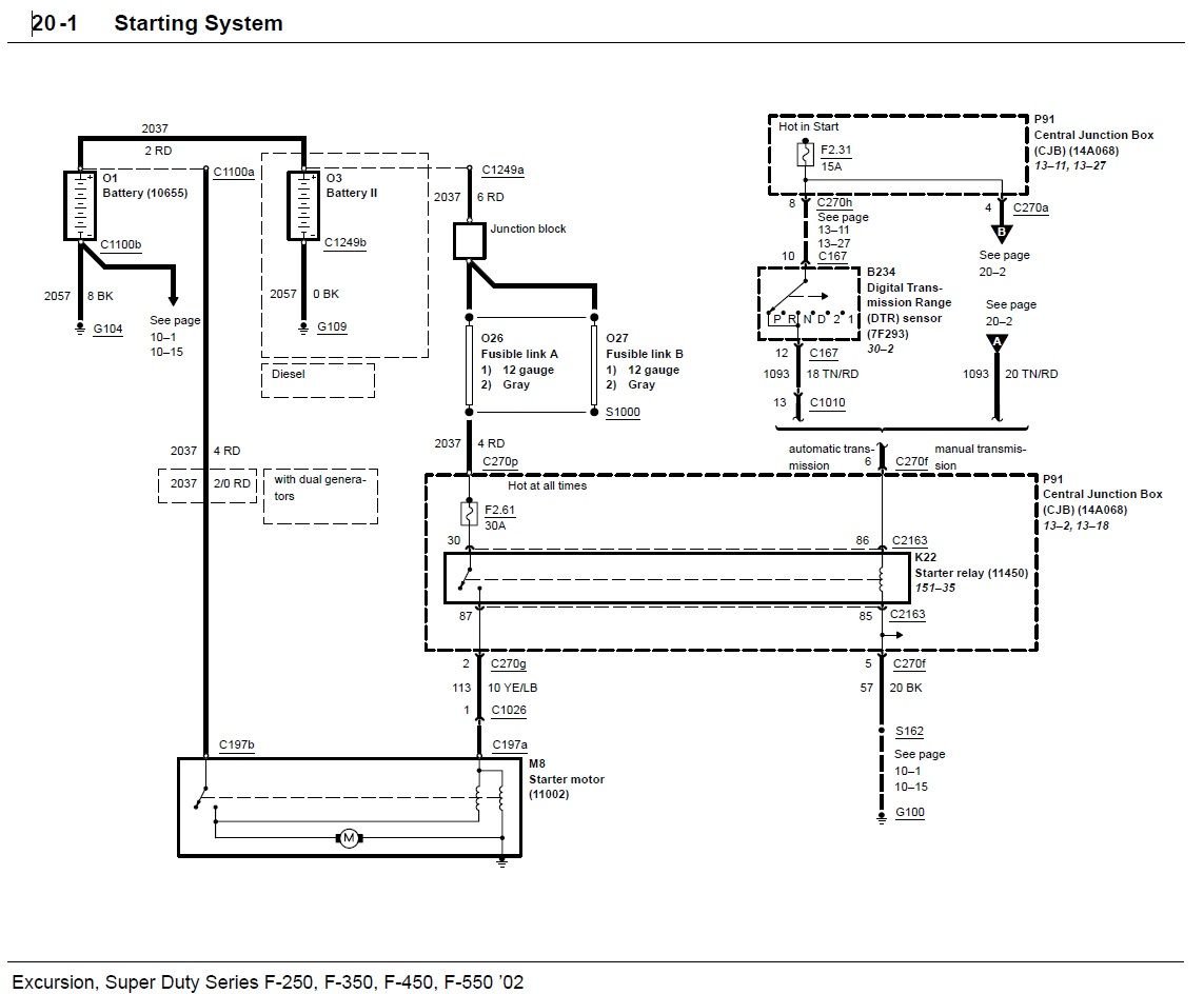

Speaking of, Ive been meaning to ask. Where is the starter relay located on 02/03 trucks? I keep meaning to trace the wire, thought yall might know the difference off top of head

It is in the Central Junction Box.
