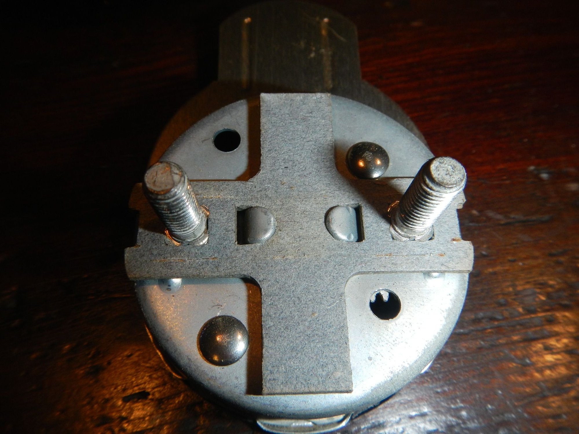

What carb are you working on? When you pull the fuel canister put a pair of hemostats on the fuel line, when you get the new filter in pull the hemostats and it will fill no problem. Sender units seem to always need calibration, the fuel gauge itself. The bottom hole in the pic has the cam that you adjust ( like fixing a watch that to slow or fast).
