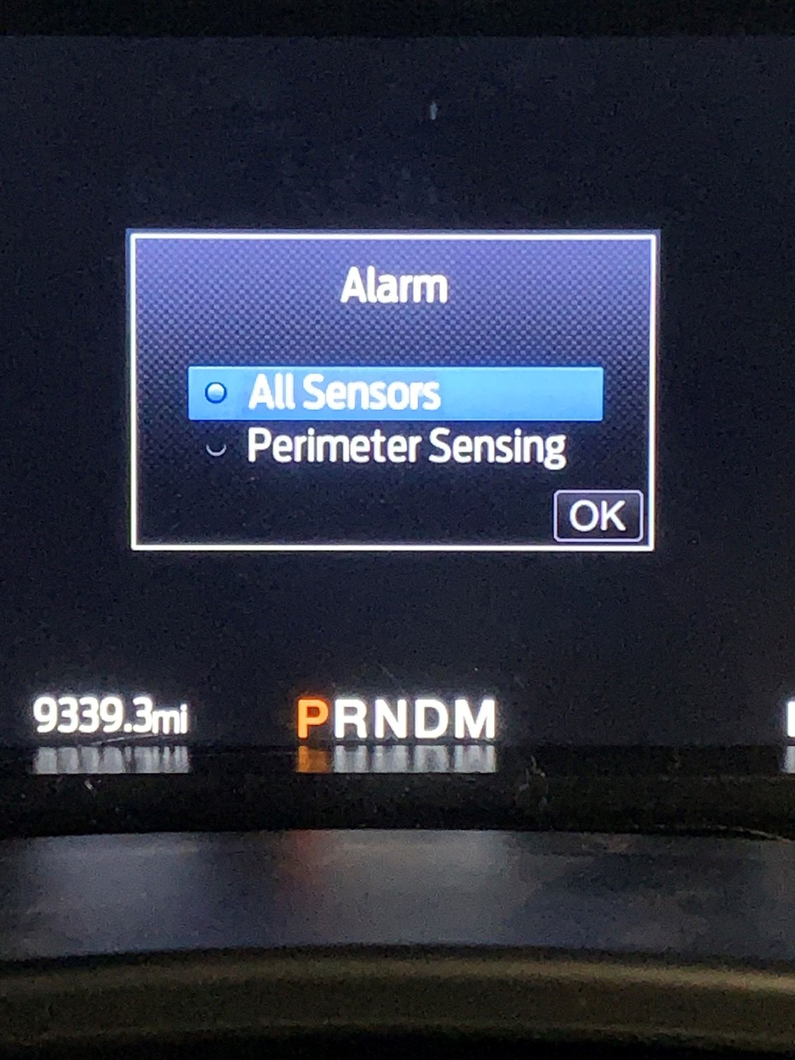

I too was having a hard time removing the air bag. And as mentioned above, you need a "long" Alan wrench or something like it. The tab inside that needs to be depressed is very tough to get to. I used a 4mm alan wrench that was extra long and it worked perfectly. After I did the wheel swap, I now have a warning light that comes on everytime I shut the truck off. See below and let me know what you guys think may have started this:

Make sure you don't have Ask On Exit enabled in the IPC Vehicle Security settings.
SETTING THE ALARM SECURITY LEVEL
1. Press Settings on the touchscreen.
2. Press Vehicle Settings.
3. Press Alarm System.
4. Press Motion Sensors.
5. Press a setting.
WHAT IS ASK ON EXIT
You can choose which level of security you require after you switch the ignition off.
Note: If you do not choose a setting, the system defaults to all sensors.
SWITCHING ASK ON EXIT ON AND OFF
4. Switch Ask on Exit on or off.

I just tried this and when I go to vehicle settings, there is no "alarm system" in the vehicle settings menu. Do I need to change it via Forscan? Thanks.

With a XLT, I'm assuming you have the 4.2" IPC. Should be somewhere under Advanced Settings. See at the ~1:50 minute mark of this video.

My previous 2020 and current 2022 have always done this at shutdown. This is nothing out of the ordinary. I usually close the door and walk away, it won't hurt anything.
Somehow your truck must have had it deactivated in the instrument cluster settings before you removed the steering wheel. As h2OCamper says, you should be able to find this in the settings and adjust.
My understanding is that All Sensors will have your interior motion sensors activated along with the perimeter. If Perimeter Sensing is chosen, the interior will not be on. For such occasions as maybe a dog left in the truck, etc.

Found it guys. Appreciate the help and I activated perimeter sensing as we do have a dog! Thanks much!
