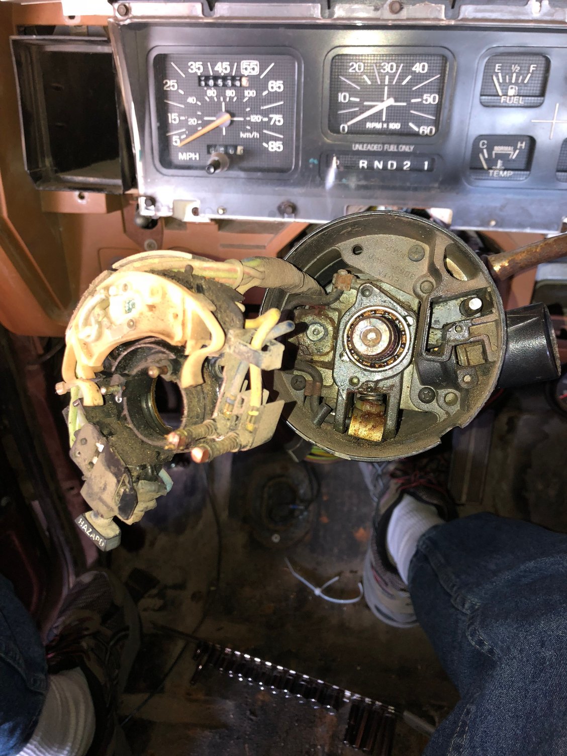

I had this issue on my Bronco. The tilt mechanism has a 4 tooth pawl that is pinned to the housing and engages another pin to hold position. The pawl holding pin was loose on one end and it allowed the paw to **** and fall out of position under the weight of my hands. I repinned the pawl using a roll pin and no problems since. I’m away from my computer but I’ll try to get pics up in the next day or two.

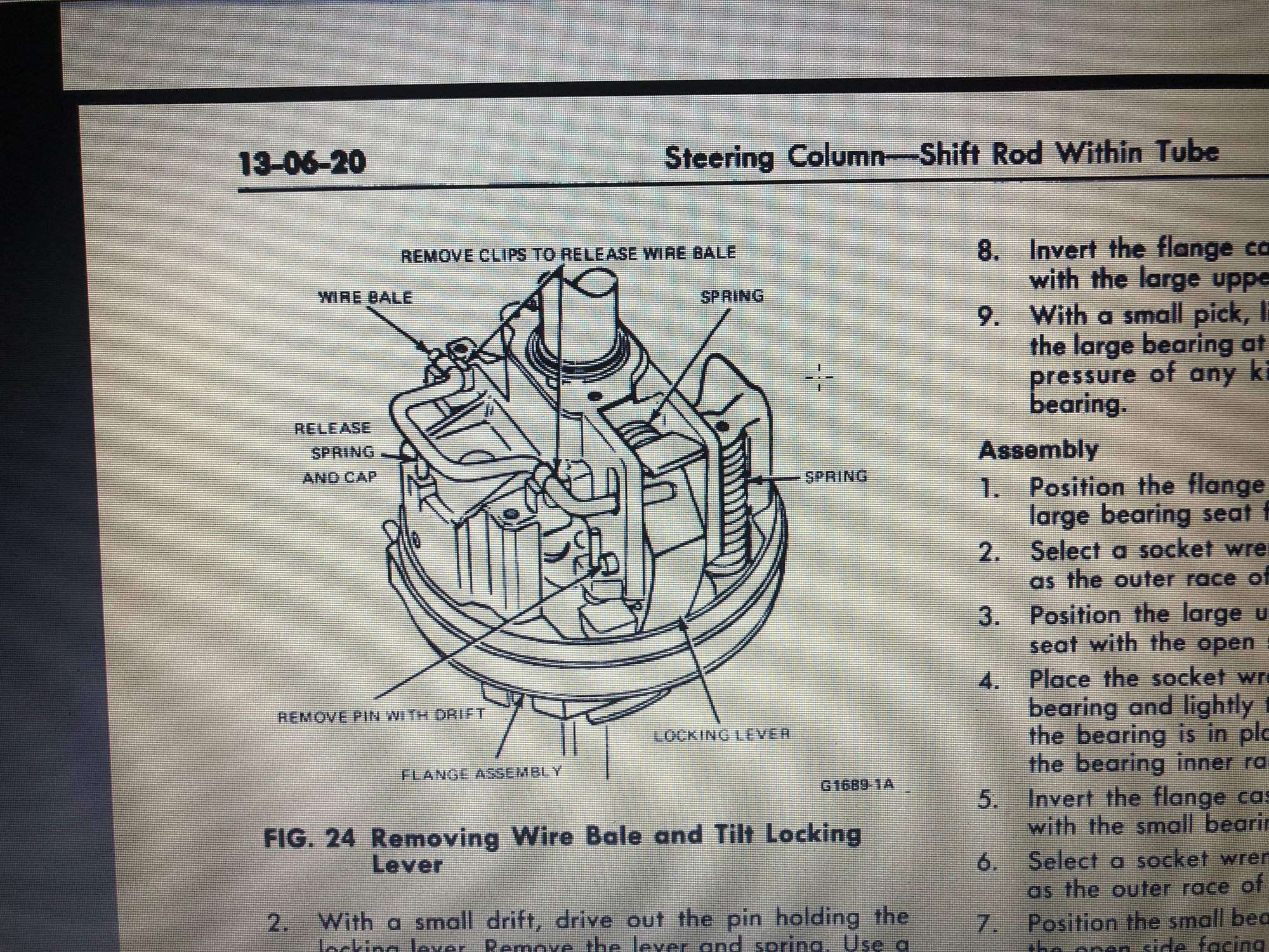

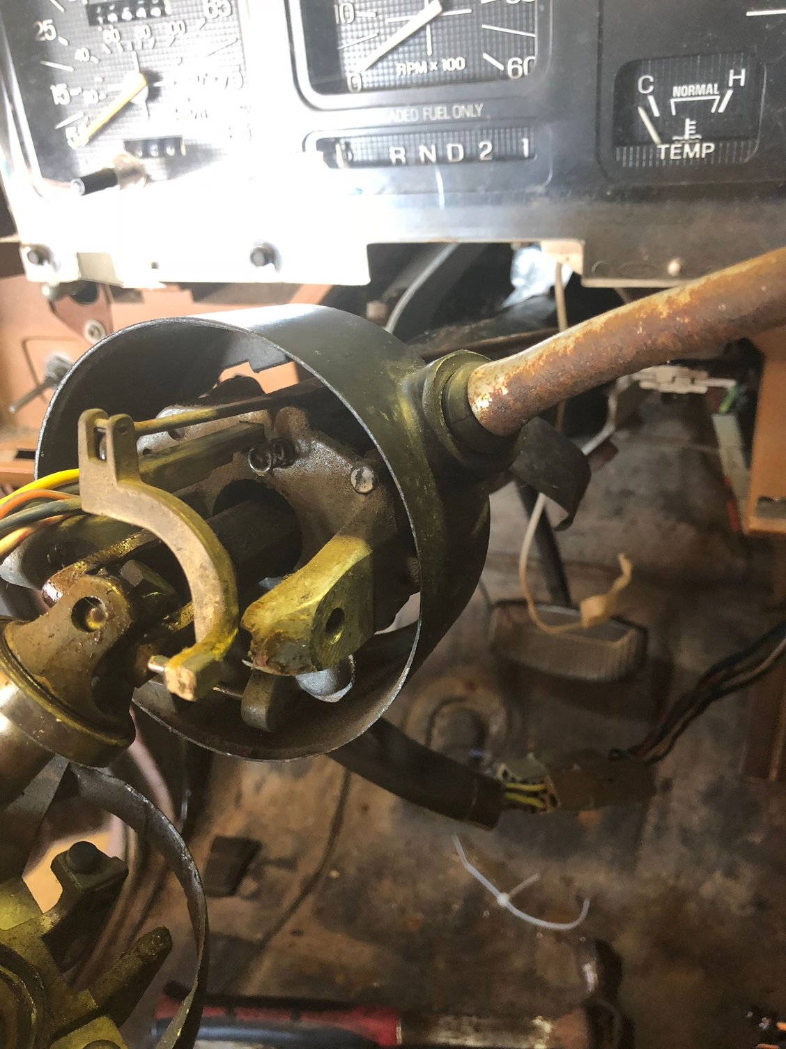

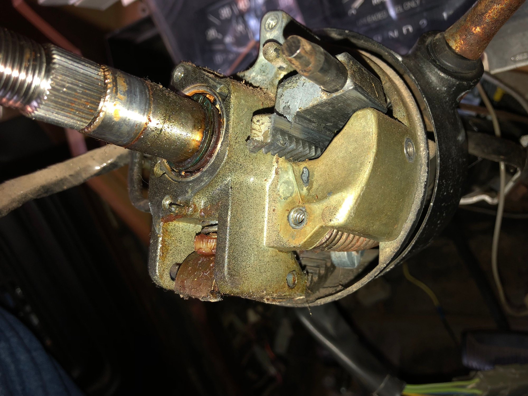

I'm fuzzy on the details of what I did to fix mine and I haven't located my notes just yet. I do know that the straight pin shown above was not engaged in the driver's side hole in the housing. I replaced it with a roll pin the next size up. I drilled out the housing ever so slightly, maybe a number 11 or 12 bit. If I can find my notes I'll edit this post. The bear out of the bunch is getting the spring back in. I remember struggling with this for a long time. I was clamping on a taper, so my clamp kept sliding off. I changed something up and was able to keep it together long enough to get to the next assembly step.
Sorry that's so vague, if I find my notes I'll tighten it up. It'll be obvious when you get to that point.
This thread is helpful to get you most of the way there.
You can see the pawl laid over to the passenger side. Wouldn't hold tilt position.
Don't lose the wire bale clips. Like hen's teeth.
This is how I clamped the tilt head to get the pivot pins started. That tilt spring is a beast.
