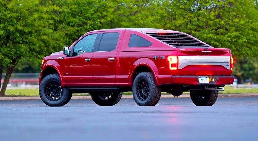

@Meyer6.2 I couldn't tell from you profile if you have a 6.5 ft bed but there is a company that makes a fastback bed cover for 6.5ft F150 beds so it should also fit F250 6.5 ft beds. It's call the Aero X.
https://www.mivehiclesolutions.com/products
