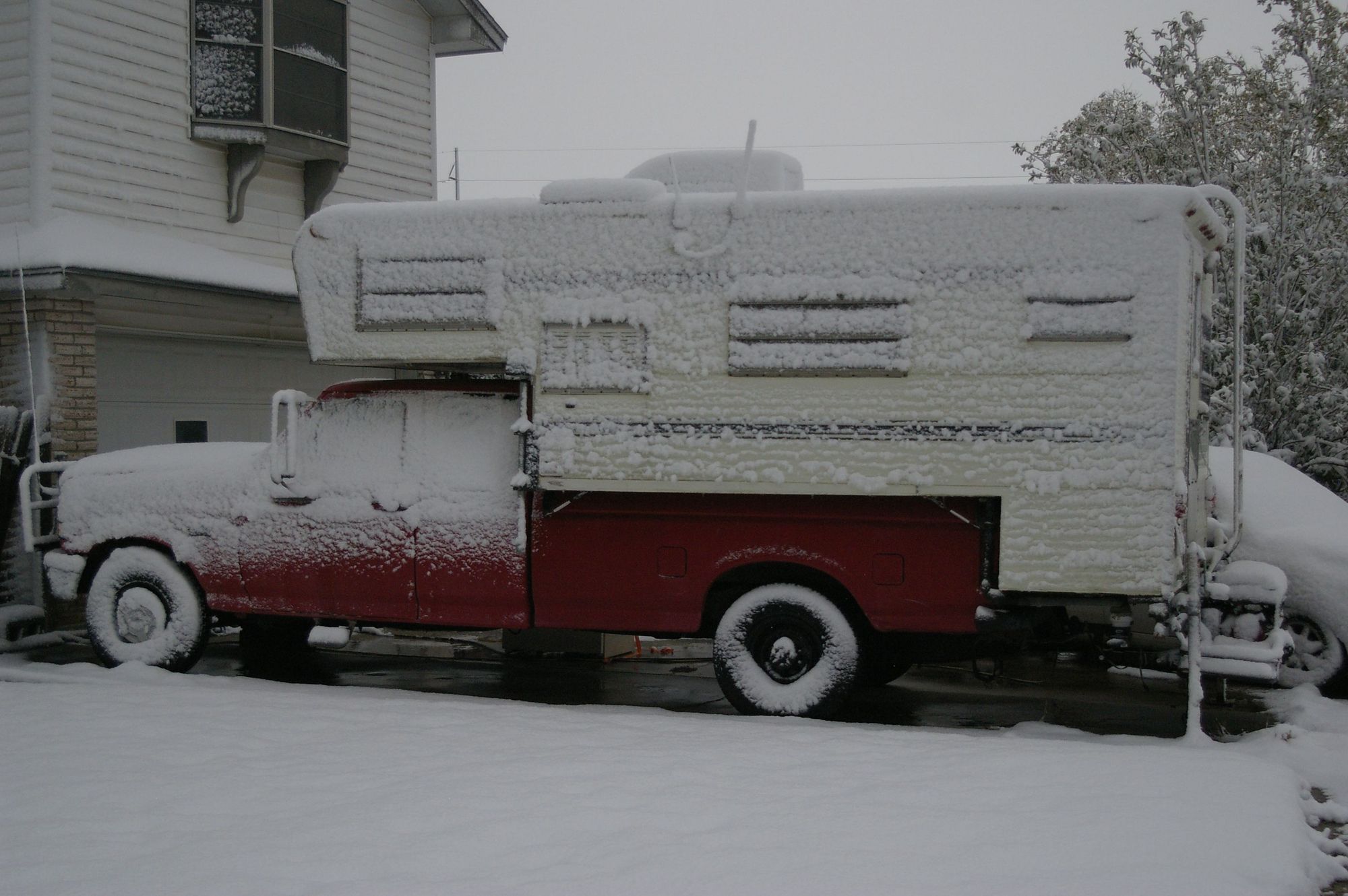

naw I'm good ... this is my Bus .....
Sweet! I had thought about one of those for the 250 before. I don't see too many of those like I used to.

well, they really aren't worth much unless you have a buyer, BUT then again who can afford 50K on a new vehicle every few years..
I'm retired My home is paid for all my vehicles are paid for and have paid for themselves over the years.
That Camper is an old 76 Huntsman 15 footer, fully self contained I spent several years doing a complete refit on it so she is in pristine fully functional condition, but it ain't worth more than a few hundred Unless you have a buyer that just really wants it.
She's seen a lot of Miles
I don't have to worry too much about new fangled electronics leaving me stranded or stupid stuff like Death Wobble that we seem to be seeing a lot of in the newer vehicles
