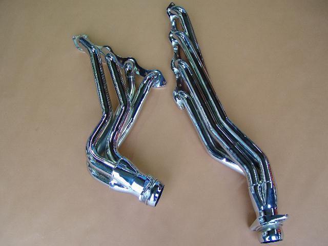

I love the sound of the turbo off my 96' 7.3 Powerstroke. Plus I do also plan on straight piping and doing some custom headers. I have always known the 7.3 to be turboed anyway. So might as well go all out if I'm gonna spend the money might as well boost it as well

Good luck with IDI Headers....... Yes they make em.....
But you will have a Hell of a time installing the turbo and expecting much out of it .... Stock Manifolds are much better

agreed.. headers, or turbo. doing both is a waste of time and money.
