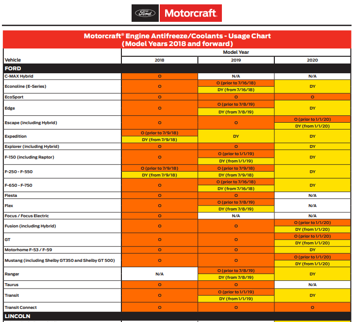

Originally Posted by djousma
I'd probably NOT switch, unless you are willing to pay Ford to do a full system flush, and then I'd do both cooling systems. Not sure its worth the cost/effort? But, what I would ask the dealership to do is to replace the drained coolant with new, along with distilled water(you provide) on your dime. Otherwise, I am pretty sure they will reuse the old that they captured draining the system to do the work. Finally, while they are in the area, you might consider having them replace the serpentine belt. Should be little additional labor (but verify that, as they might try to charge book time).
Suppose that decision is made by the technician. When my water pump was replaced the coolant was replaced also, or at least there was a line item for new coolant on the work order. I've heard some people say the dealer charges $400-500 for a cooling system flush.
I'm considering changing to the new yellow coolant when I hit the end of life on the Orange coolant. Drain the old coolant and refill will distilled water and drive it for a week. Drain coolant again and refill with more distilled and drive it for another week. Then drain and refill with the new coolant. Any reason why that wouldn't work?
