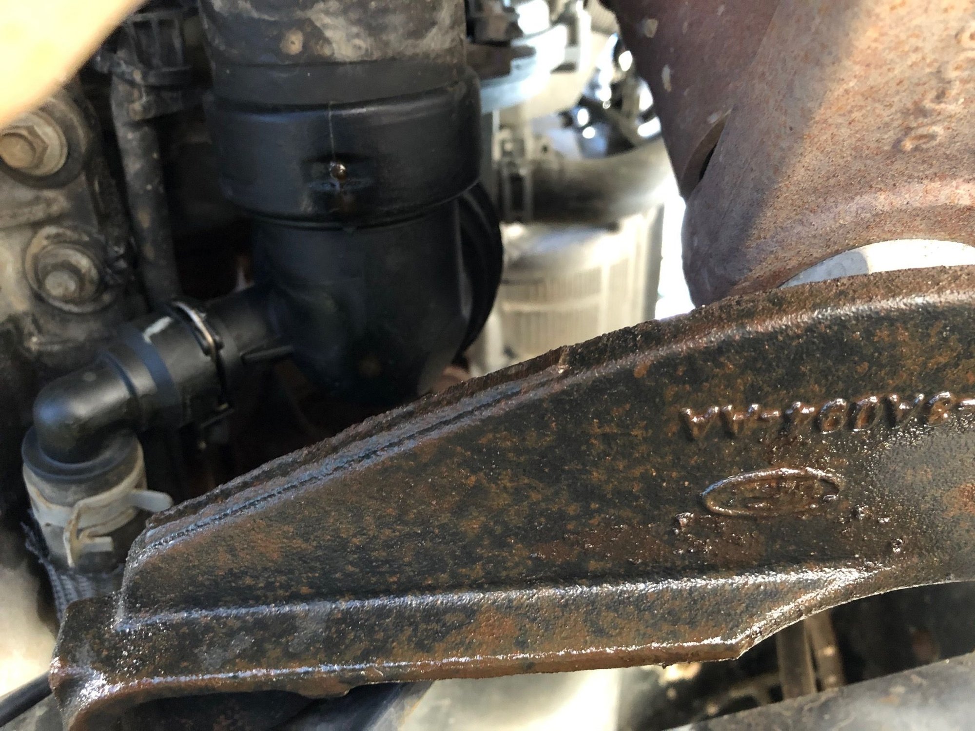

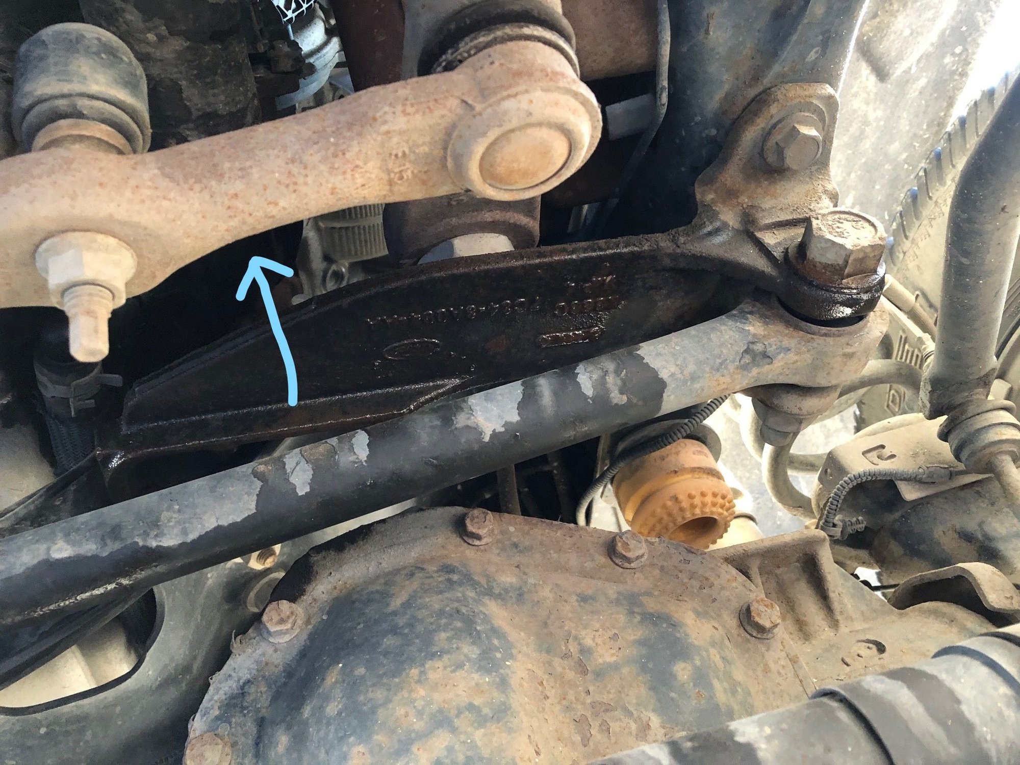

A couple days ago I got a whiff of coolant when I parked my truck, but I didn't see any coolant on the ground or elsewhere. Today I found a couple spots on my driveway, and I figured it was going to be the infamous radiator leak or turbo coolant line leak. I don't see any sign that either of those is the culprit. I find coolant drops on the bottom of where the lower radiator hose connects to the bottom of the engine on the front driver's side. I've looked pretty hard above this spot, and I just don't see anything wet up there or in the valley by the turbo. Unless I have a hose failing at the connection point to the engine, I'm not sure where the fluid is coming out unless maybe it's a oring inside the 90* fitting. I'll throw a couple pics up here, and I'll call my dealership tomorrow for an appt. I'm still covered by my extended warranty, which is why I was kind of hoping the radiator was the problem. I'd rather that not pop once my warranty runs out.
I didn't find any reports of this kind of problem in the coolant leak posts I found on here, but I did stop looking after a few pages of posts. What have you guys seen like this before? Thanks.

that hose looks to be the issue. Don't clean it or anything so they can see it too.

I had coolant dripping from that lower coolant hose and it turned out to be a failed water pump. That would be my guess.

Thanks guys. I'm leaving it alone so they have the crumb trail to the problem. Hard for me to not try and figure it out, but that's why I got the extended warranty.
