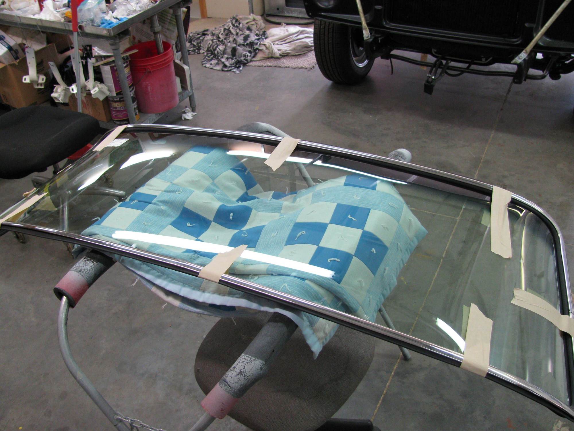

I got this one from a local body shop it has the tinted band across the top. It was $115 plus I paid $15 more for insurance that covered breaking it while installing it. I used Dennis Carpenter's rubber seal and 3M, 08509 non hardening sealant. A friend of mine came over and we had it installed in 30 minutes after I got it prepped. Also we used Castrol Red Rubber grease on the nylon cord we placed in the channel to pull the seal over the pinch weld.
The hardest part is getting that stainless trim to stay put.
