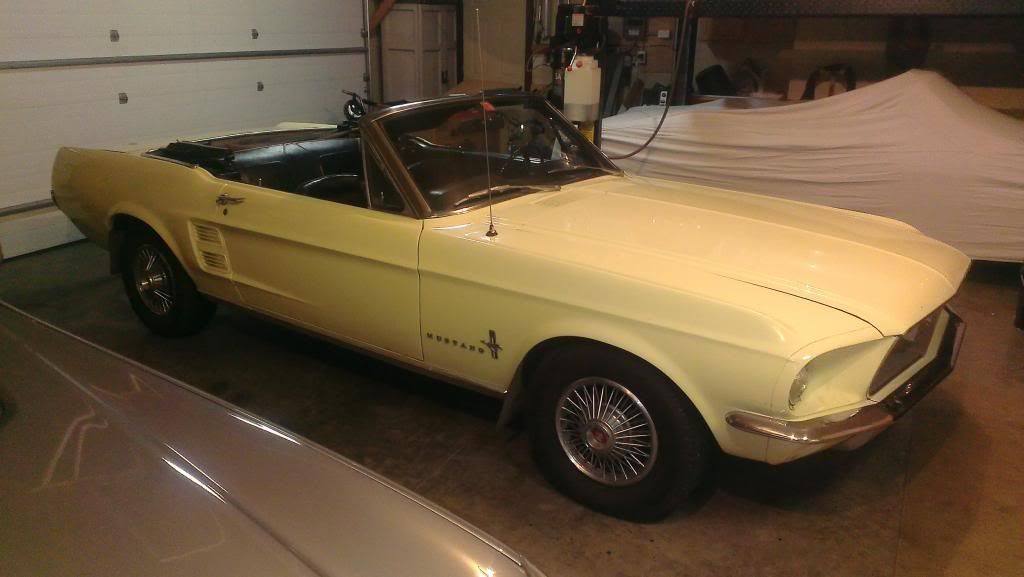

Since you asked for some pics of the other projects, here are some pics of the 67 mustang convertible in progress...she was a mess. I basically had to replace the floors & rockers (can't find my photos for those) and then then entire back end was rotted away so I started over... literally.

More of the 67. I'm close to all the metal work being done. first time in 3-1/2 years she's seen all the doors, fenders & hood.

Yeah, it was a ton more work than I had planned on. Attached is a pic when I first bought it....one would say why did you touch it, it looks pretty good but after i started looking into it, the sins of the past started showing, the previous owner did a lot of "masking of issues"...look at the 2nd pic where the PO glue a good section of the tail light panel onto the rotted tail light panel.
I knew it had "some" body work which is why I got it on the cheap, but I didn't however know the guy bought stock in body filler and panel glue.
Also found a couple pics of the completed floor w/ suspension installed
