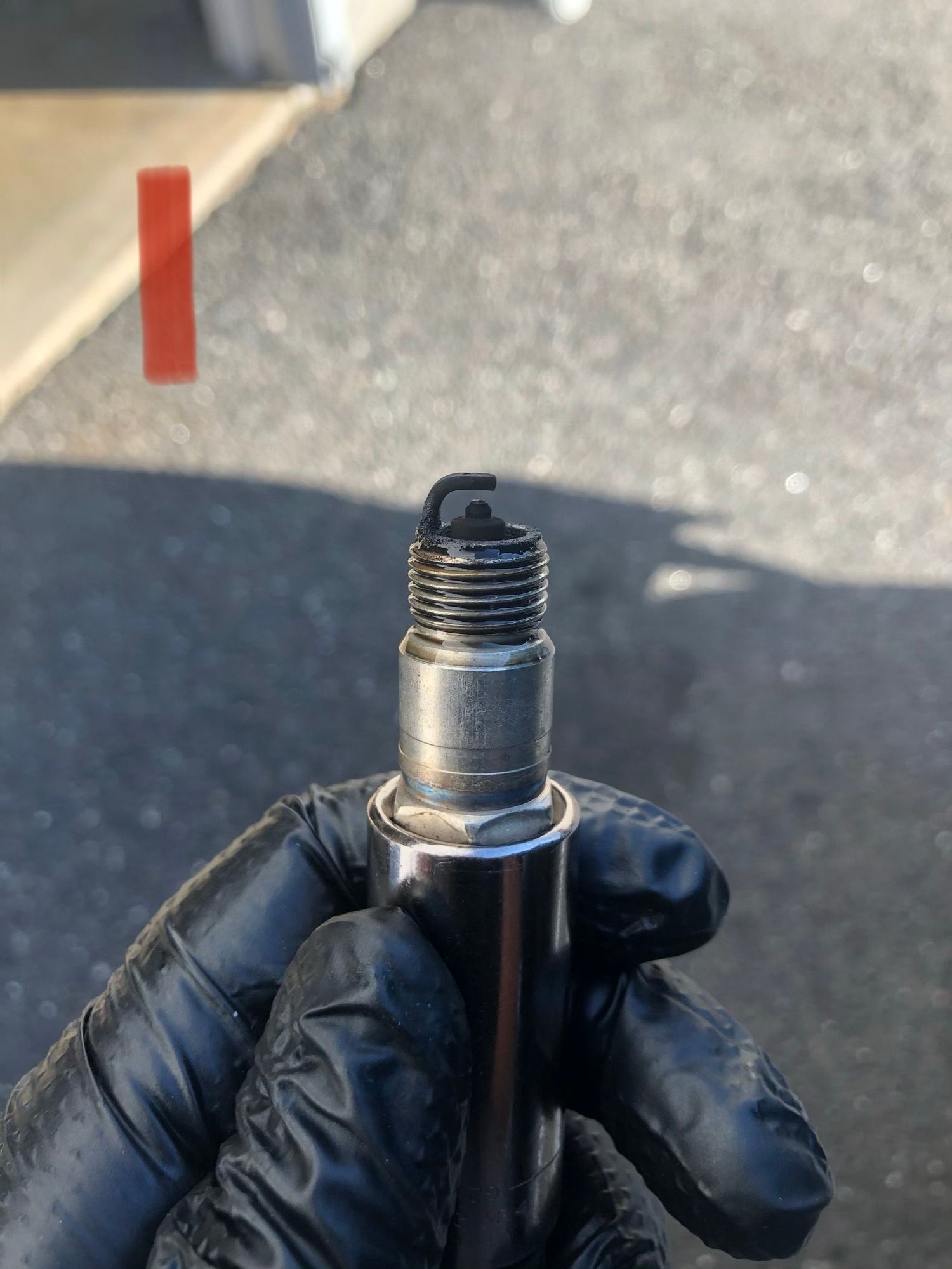

Some Updates for you guys - did a compression test - results posted below. Took photos of my spark plugs all posted below, some had dried oil residue past the threads.

I thought when squirting oil you could only go up in compression but I have no idea what these results mean. I did cylinder 2 twice again after noticing the drop and got 111 (no squirt) and then 113 with a squirt of oil, note that this was directly after the first wet - so results may be off.
Vacuum was reading about 15 at 14 degrees timing, I brought that to 13 degrees and then adjusted my air/fuel mixture screws to get vacuum up to 17.
After doing my compression test I let the truck run for about 20 minutes and the metallic noise pretty much stopped. It was extremely minimal and would only be able to hear it slightly at 3500+ rpm. Then I let the motor cool down for an hour started her up again to pull her in the garage and the full on metallic sound came back. No idea what to make of it it was 54 degrees all day.
So confused. I just want to drive my truck haha. Appreciate all the help guys.
