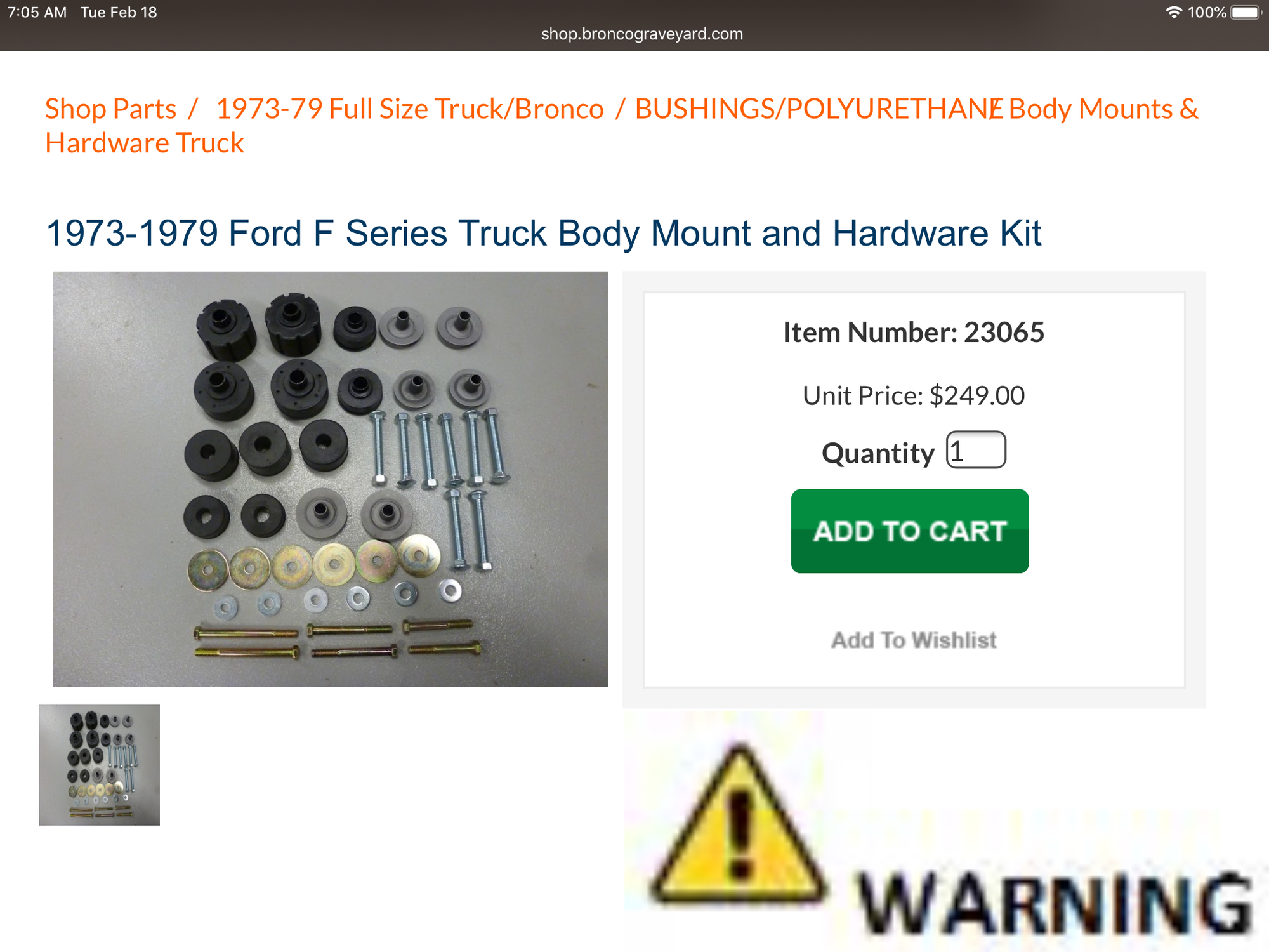

I want to make sure I have everything I’m gonna need before getting started. I found this kit which is a little pricey:
I’m not doing a full body swap just yet, but I’m planning to get a new bed down the line so I should end up using all these parts. Does anybody know a cheaper way to get what I need? This kit was appealing in part because I don’t know parts I’m gonna need. I may or may not be able to salvage some of this stuff from my truck and I don’t want to get my cab pulled off and then have to wait a few days to get something in the mail. This swap has to be done over a weekend and if we don’t get it done I’ll have to tow my truck back home to get it out of the garage we will be borrowing.

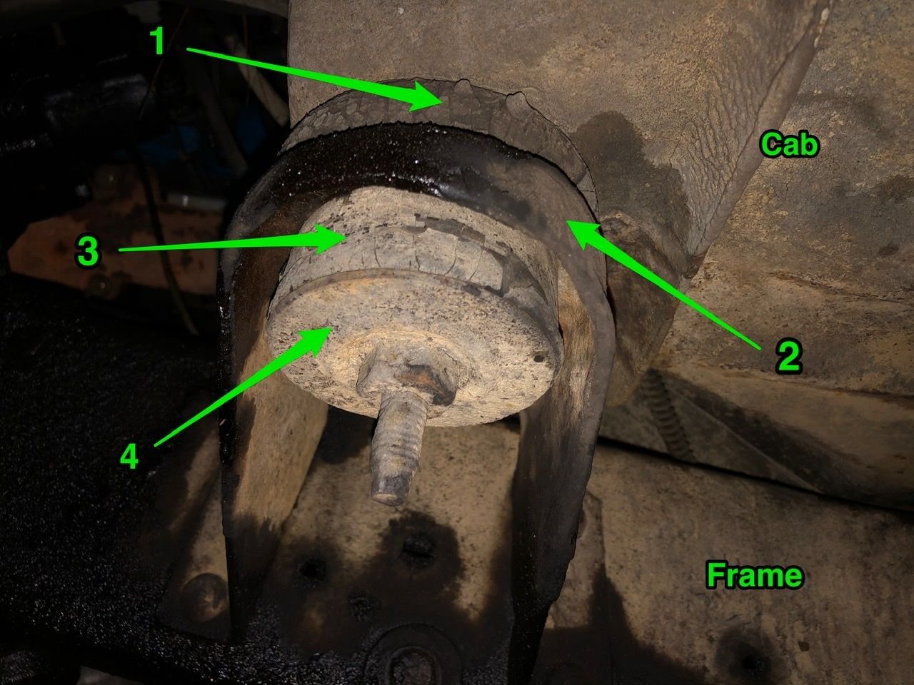

When you say “body mounts” are you talking about one of the following?
When I look at this, I think I need to replace 1, 3, 4, and probably that bolt. If #2 is the body mount, it looks like it can stay. I don’t want to over complicate things. If I can manage it, once we have the cab off I’ll try to wire brush the exposed frame and paint it before putting the new cab on the next day.

After looking again at that kit, do those “metal sleeves” go inside the bushings?

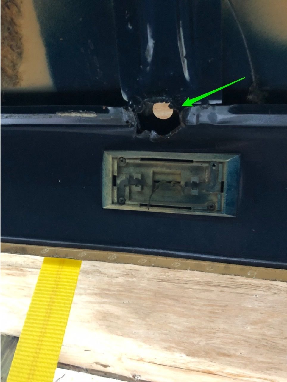

I’m working on cleaning up the new cab. I’m wire brushing the floor and planning to prime it and put sound deadener down. Today I noticed a couple things that made me scratch my head like this hole in the roof:

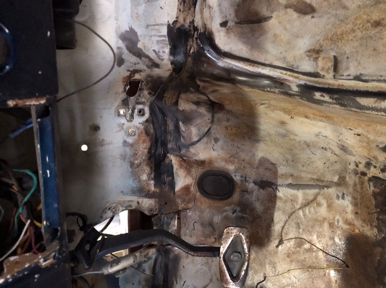

And behind the brake pedal you can see that they made cuts down at the bottom of the hole where the steering column goes. What’s that about?

The hole is probably a (poor) CB antenna install, the "tar" is seam sealer from the factory, firewall, don't know.
The retainers, aka metal sleeves, aka towers are the lower part of the mount (#4 in your picture). The tower part is tapered and goes through the lower half of the rubber mount (#3 in picture). The upper half of the rubber mount (#1 in picture) has a corresponding tapered hole. When you tighten the bolt, you draw the two tapers together making for a very tight fit.
#'s 1, 3 & 4 are the body mounts. #2 is the frame bracket that the body mounts sit on/ are attached to. Sometimes the hole in the frame mount is very rusted out and now the hole in it is as big as the mount itself. There are "frame saver" bushings (actually large flat washers) that can be welded onto the frame to repair it.
