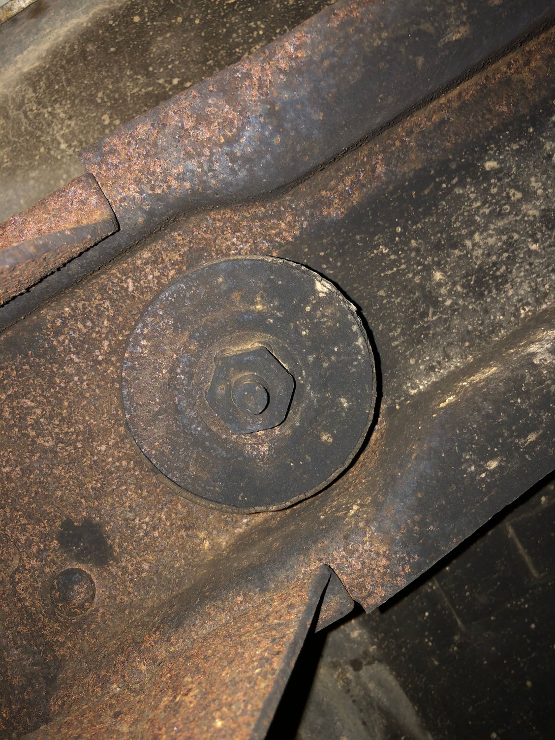

Originally Posted by mikeo0o0o0
#'s 1, 3 & 4 are the body mounts. #2 is the frame bracket that the body mounts sit on/ are attached to. Sometimes the hole in the frame mount is very rusted out and now the hole in it is as big as the mount itself. There are "frame saver" bushings (actually large flat washers) that can be welded onto the frame to repair it.
Do you think there’s a tangible benefit to replacing the body mounts? Could there be a problem reusing the ones I have?

Considering that they are 40+ year old rubber and you will have to remove them to get the cab off, yes you should replace them. They might get destroyed in the process of removal anyway. I've seen posts where they have to be cut apart with a sawzall.
The one in the picture looks to be in "okay" shape. If the other ones are in the same condition I don't know that you would notice any "tangible" benefits.
That’s what I was thinking too, but John89’s point about the body mounts getting damaged makes a lot of sense. I should order them in case I need them. Thanks for all the help.
