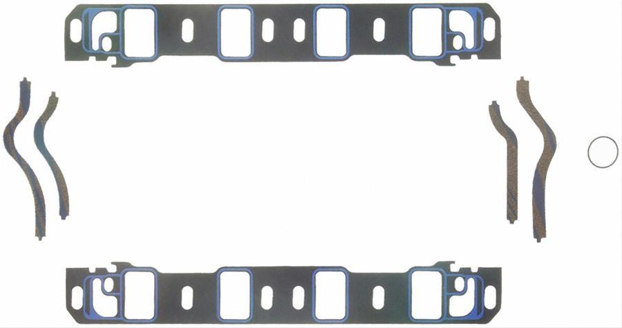

Originally Posted by xlt4wd90
Or you can install new intake manifold gaskets that block off the exhaust passage right at the intake interface.
d.
What type of gasket? Something I would make from exhaust material? I really do want to block that off below the carb spacer.

There are some gaskets from Fel-Pro that come with a block-off piece that fit into that middle hole to block off the exhaust flow from the head into the intake. Mine did, though I don't show it in this picture:
https://photos.google.com/share/AF1Q...ZEOUVmWjRfSFl3

I would be hesitant to block off the exhaust crossover at the head mating surface, all the carbed intakes had this crossover to provide carburetor heating. The only difference is that the earlier ones did not have the oval port connecting to the carb spacer mounting surface.

Do you see a problem with blocking the hole at the intake gasket?

"Do you see a problem with blocking the hole at the intake gasket?"
No, if that hole is blocked then the intake would merely function like the earlier intakes, allowing the exhaust to pulse back and forth under the carburetor pad.
Edit: Disregard post, I was thinking of blocking the hole at the carburetor pad.

If I blocked the exhaust passages into both sides of the intake manifold, I'm not sure how exhaust would get into the carburetor pad; isn't that the whole point of blocking those holes?
I can see if you're using the exhaust heat passage for the automatic choke, that would be defeated.

There are two ways out (well, three actually if you buy an aftermarket intake), either using block-off intake gaskets or using the EDEL block-off carb mounting plate -
Fel-Pro Performance Intake Manifold Gasket Set
Carburetor Spacer - EDEL #8714 Divided Center 1in Thick
