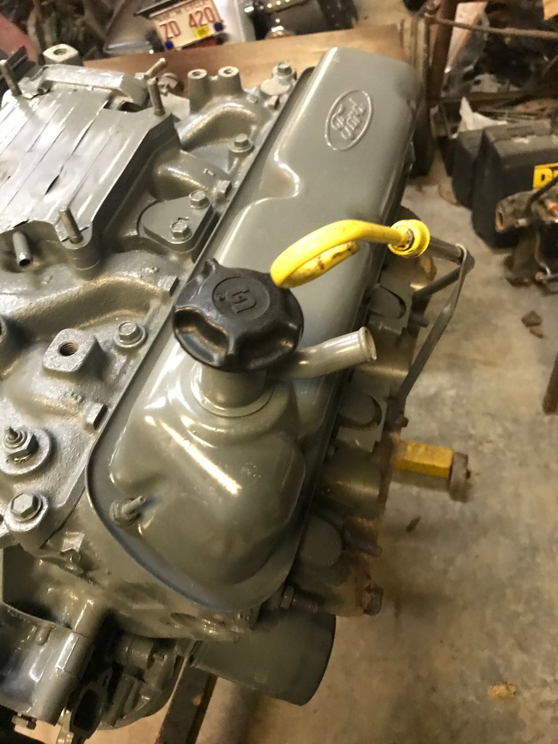

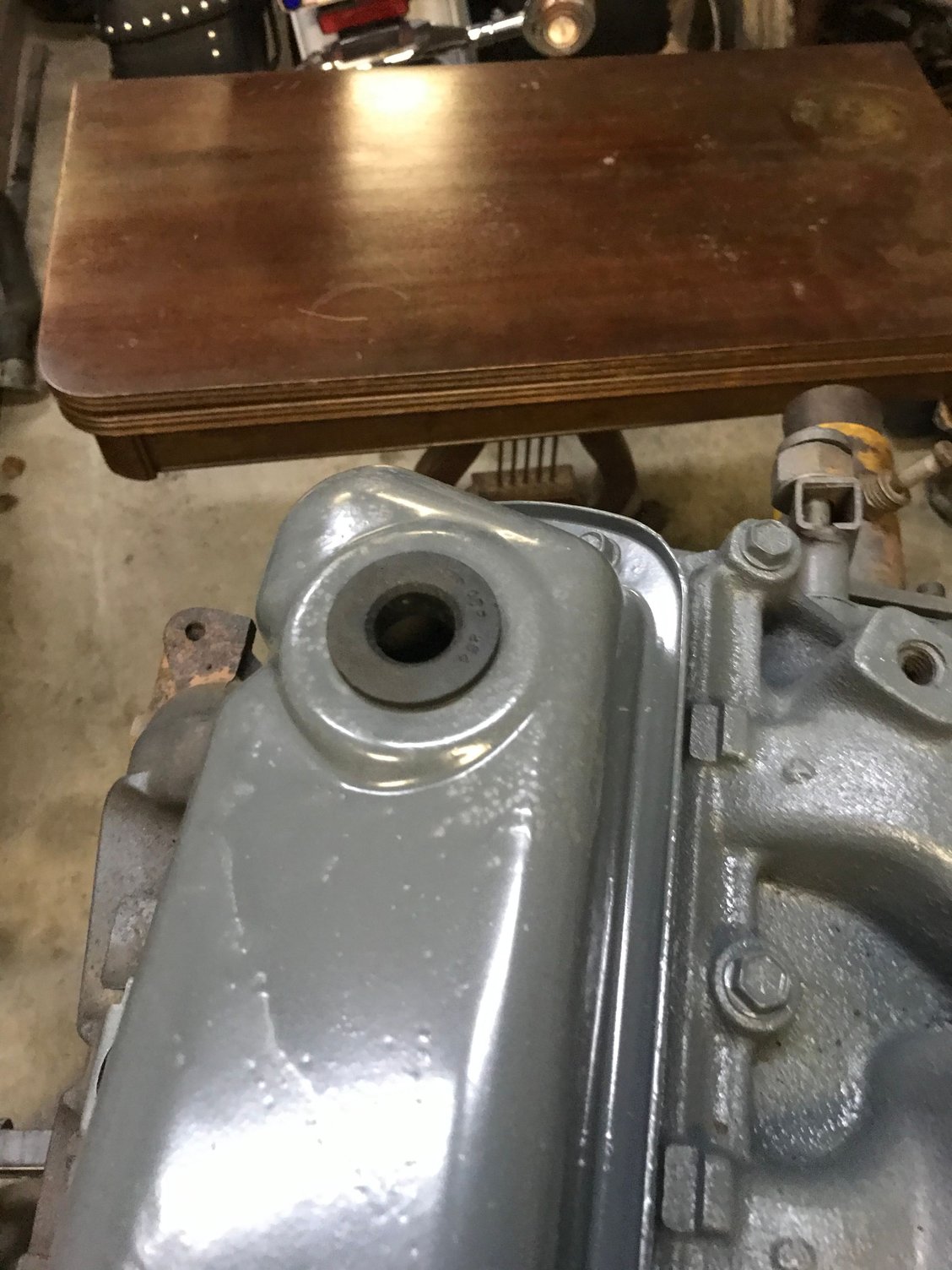

Passenger side with pcv gromet
Driver side filler cap with vent tube. I do not like the looks of this tube.

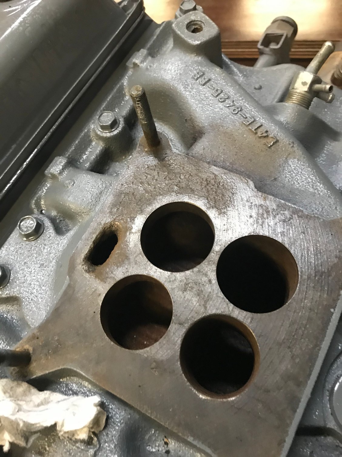

351 ho base plate

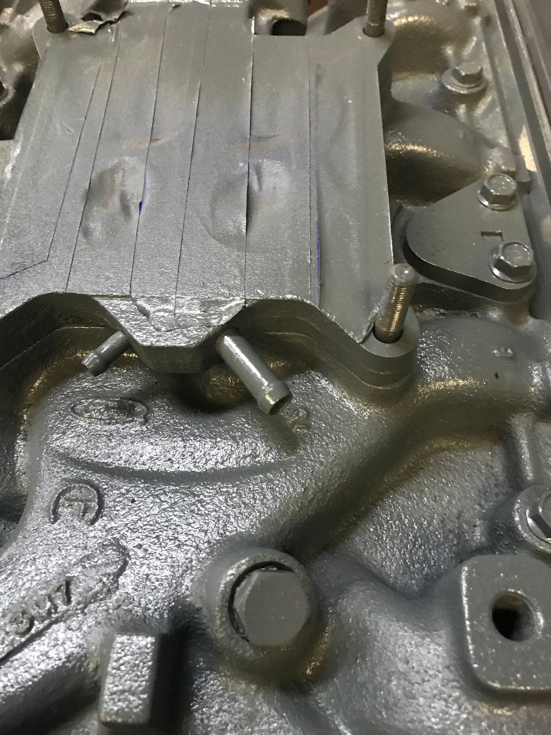

351 HO manifold. The egr hole keeps me from using a standard 4 barrel spacer. Wanting to use an older 4100 carb and no large vacuum outlet. I have a standard 4barrel spacer with a pcv hose and valve already attached, but it’s non egr

The short tube (left rocker cover oil fill tube) is for the fresh air supply from the air box. Simply connect the fresh air inlet from the replacement carb air cleaner and that one side will be done.
ok I’ll run it to the air cleaner. Done
i may have to remove a intake vacuum plug and run the pcv to that.

What I would do is try and find another RS rocker cover with the hole and grommet (will that hole accept an early twist-on cap or is it perfectly round w/o the grommet)?
Where is the plug-off located?

My filler is completely round but I believe I can grind it out and have same as rs valve cover.

You have ann EGR INTAKE MANIFOLD. How do you plan on defeating the EGR?
If you keep the EGR carb spacer and remove the EGR valve and block the valve opening (block-off plate) you will have a nipple for the PCV VALVE at the rear of the spacer.
You can remove the oil filler tube and leave an opening for a grommet and push-in oil filler cap.

Copy, but just a little more aggravation, that EGR spacer is going to be filled with exhaust so the carb temp will be high. Consider a phenolic 1/4" spacer between it and the carb base.
