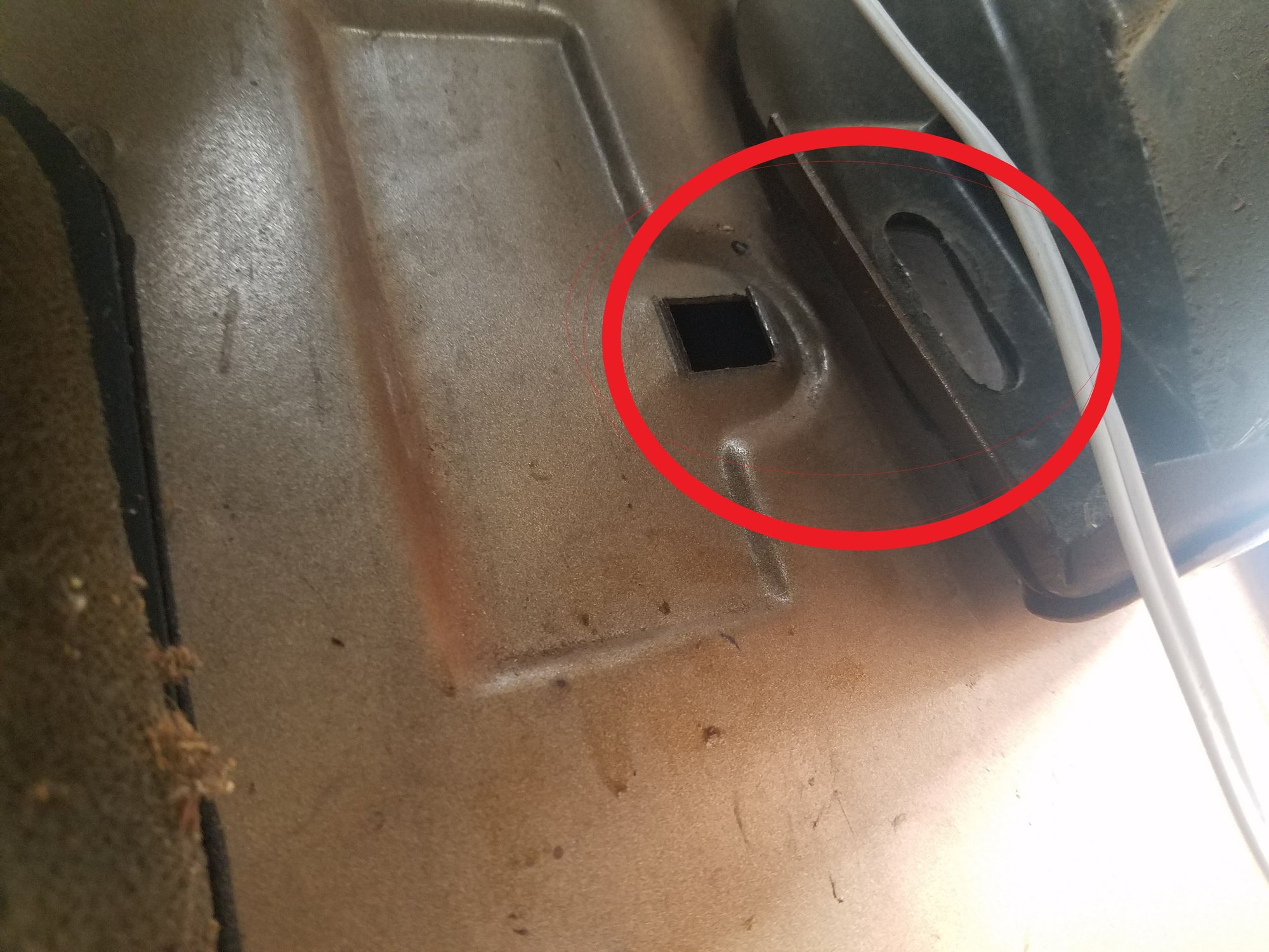

The square anchor fell back through the hole and I can't retrieve it. Does anyone know how to anchor the dash to this square hole? Is there a part number?

In the depressed area on the left of the square hole you might be able to drill another hole big enough to use one of the J bolts like what's used on the fenders.

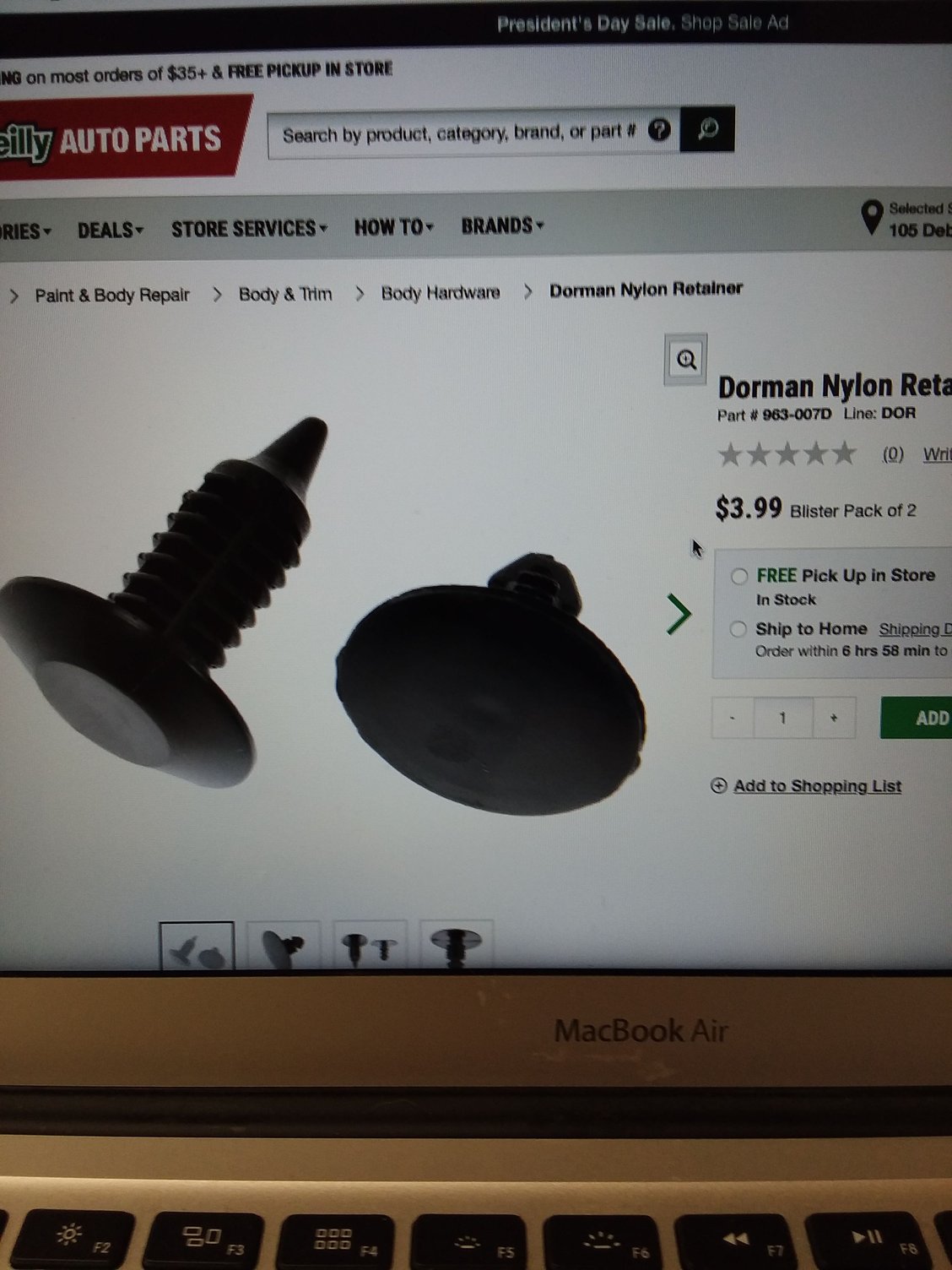

Does a screw/bolt go into it?
Maybe some body fasteners such as these.

John89 that's a great idea, those square push ins for license plate bolts look about the right size.

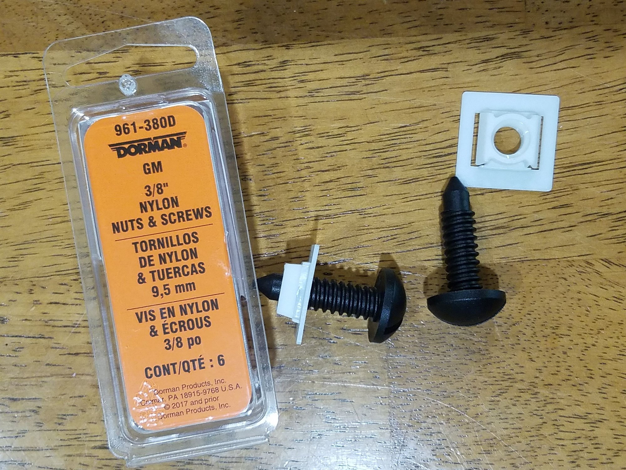

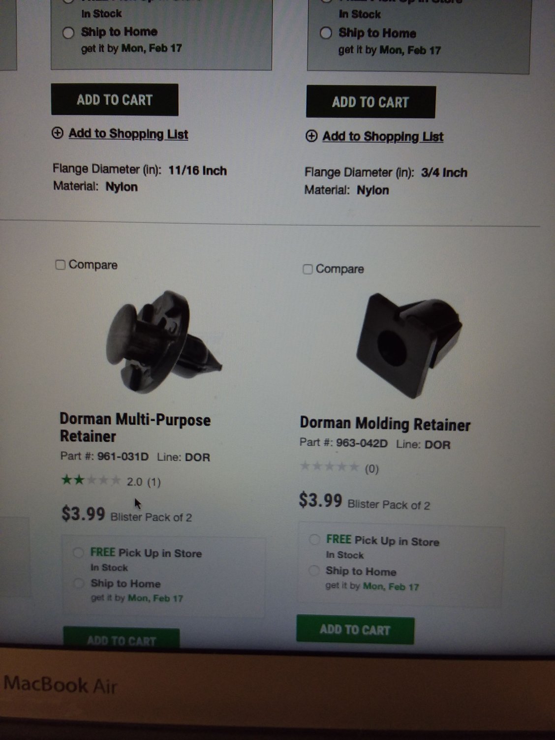

I used these. They take a little trimming with a dremel or file to push in. Seems ok right now. Time will tell. The license plate bolts are much smaller.
