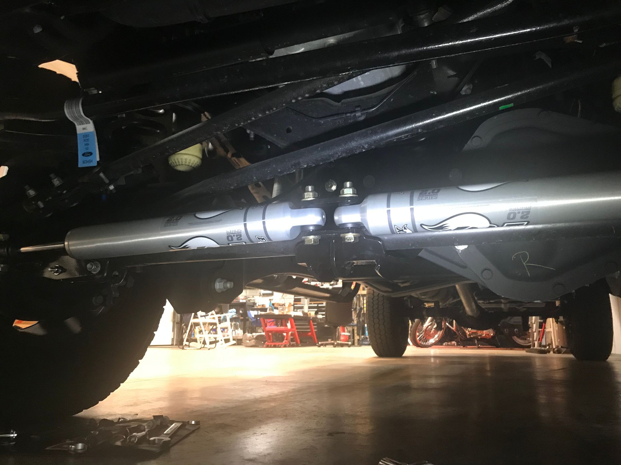

my PMF dual setup was a bit tricky. first of all I have a 2019 f-450 dually and correctly bought the wide track version of the dual stabilizer setup.
put it all together and added the extra boots.
had binding in both directions between the shock body and the track bar.
I had to reverse the shock position so that the shock bodies were furthest from the track bar.
sent PMF pics and explained the problem and solution.
they agreed their would be more clearance to do it the way I did but did not understand why their standard install method did not work. they examined the pics and agreed there was a problem with their install method on the 2019 f-450 dually.
so yes...some mechanical ability is good so you can recognize potential problems.

I installed my Kelderman myself, laying on my back on the ground. A few things I learned and some replies to your comments. I talked to Kelderman before doing the job, and they also told me they had no torque specs. In my opinion the only torque numbers you really need are for the two bolts on the differential cover. I didn’t torque mine, just snugged them tight like they said. I believe that I read somewhere that these bolts are torqued to 25 ft-lbs but don’t quote me on that. I was comfortable snugging them on. . In regards to those two bolts, Kelderman included two replacement bolts because they are longer than the OEM bolts, so you might want to check your bolt kit. If the new ones really are absent, call Kelderman and I’m sure they’ll send you some or give you the size so you can buy a couple. I noticed that the OEM bolts had blue Loctite on them, but I didn’t put any on my new bolts. This was probably something I should have done. The four big bolts that secure the bracket to the axle are Grade 8 bolts with nylon locking nuts. Just pay attention and get each one on evenly, and tighten them down hard. You ain’t gonna break Grade 8 bolts. It’s probably a good idea to recheck these after several hundred miles to confirm tightness.
You do have to replace one of the bolts on the tie rod end bracket because again the OEM bolt is too short. Kelderman supplied the longer bolt. No big deal here. Just pay close attention to where the square “washer” is located that fits on the square side of the OEM lag bolt because the new bolt is a standard hex head bolt. Again, no issue here with installation. Just pay attention and maybe take a picture of it before you start removing things.
The biggest issue for me occurred when I went to install the stabilizer shocks. I had the truck on blocks so that the front tires were not in the air. This made getting the greatest distance between the mounting holes difficult. The second time I did it (don’t ask), I supported the axle on jack stands which made it so I could push the tires and extend the tie rod to its maximum extent by pushing the tire out with my feet while I inserted the bolt in the tie rod bracket. Put the bolt into the axle bracket first and then install the outside tie rod bolt. And insert the bolt from bottom up. I had to have a helper insert the outer bolt because it took both my hands and most of my strength to compress the stabilizer. These are damn strong shocks/stabilizers.
I believe in the end, you’ll be extremely pleased with the results in regards to stabilizing your front steering. I left my OEM stabilizer in place until I replaced it with a FOX ATS model 093-02-143 race adjustable style. Honestly, the steering was completely stabilized by the Kelderman Dual setup. I simply wanted all the stabilization I could get since I had TWO OEM stabilizers go bad on my 2019 F-350, one at 15k miles and the second at 18k miles. I just passed 21k miles and am confident that I’ve solved the problem with Sustained Steering Wheel Oscillation/Death Wobble on my truck.
I also installed Monroe boots on my stabilizers to mitigate road debris from from contaminating the piston rods. I got them off Amazon and they fit perfectly. Well worth the $10 - h
