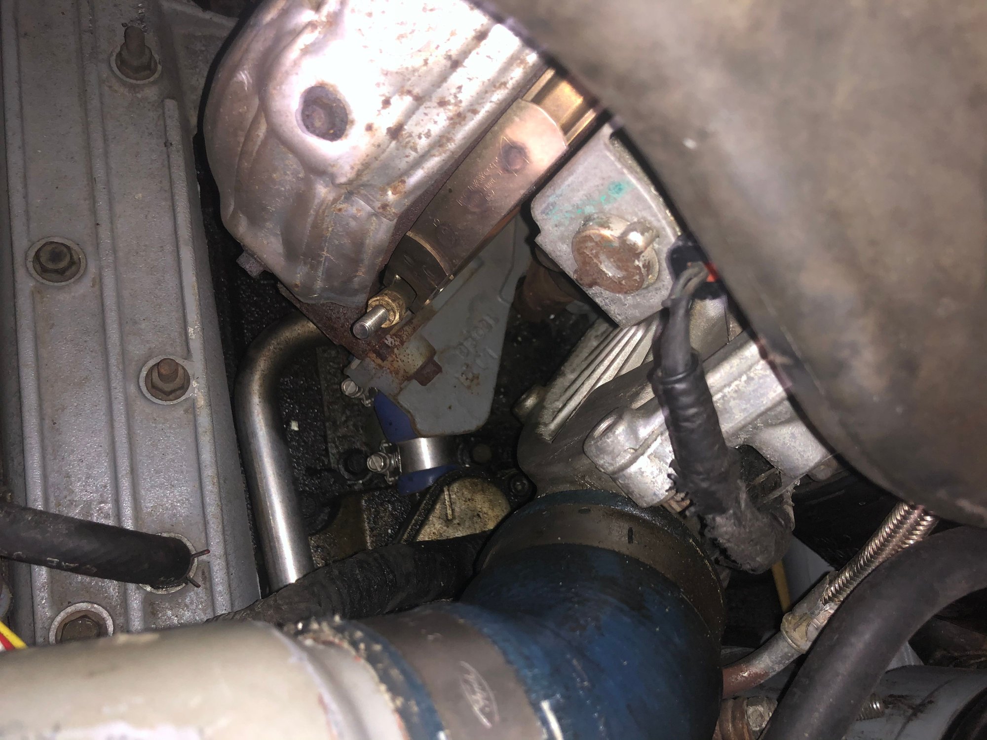

Changed the batteries voltage still at 13.2 on bulky dog tuner., new fuel filters as they were horrendous, did a bunch of wire inspections and found nothing, had confirmation injectors were in fact done about a year ago with glow plugs and new harnesses at a reputable shop, did a bunch of testing with the soluce but can not replicate my issue unless I manually shut injectors off one by one.

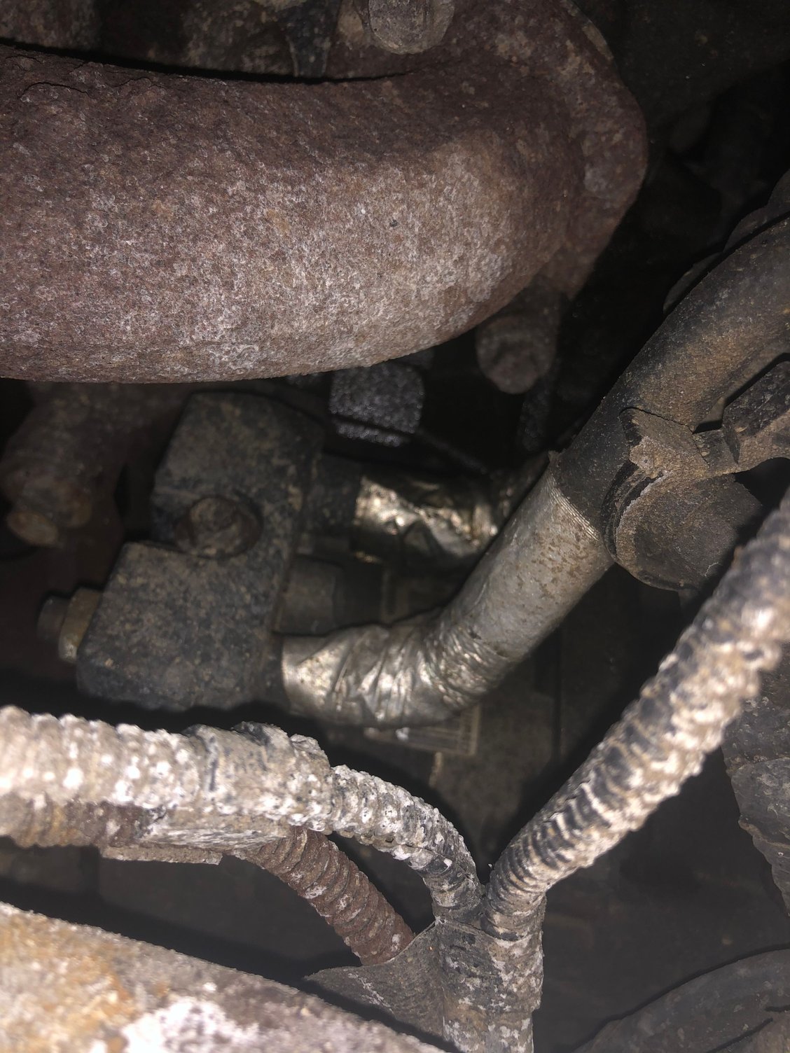

did find plug on transmission harness to be broke and zip tied to my transmission. Would this cause a shift issue? Obviously it’s a good place to start for the gauge dropping randomly..
What’s next? Do I just have premature injector failure from poor maintenance?

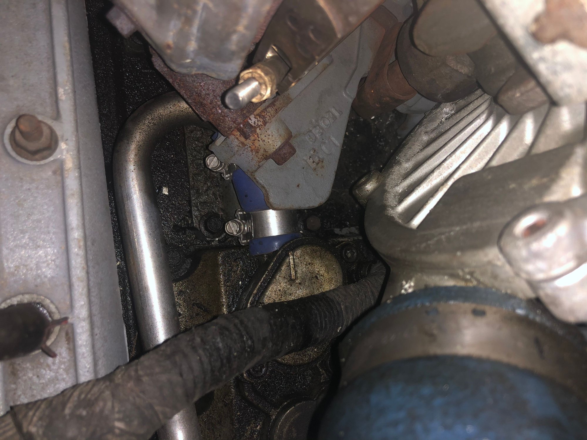

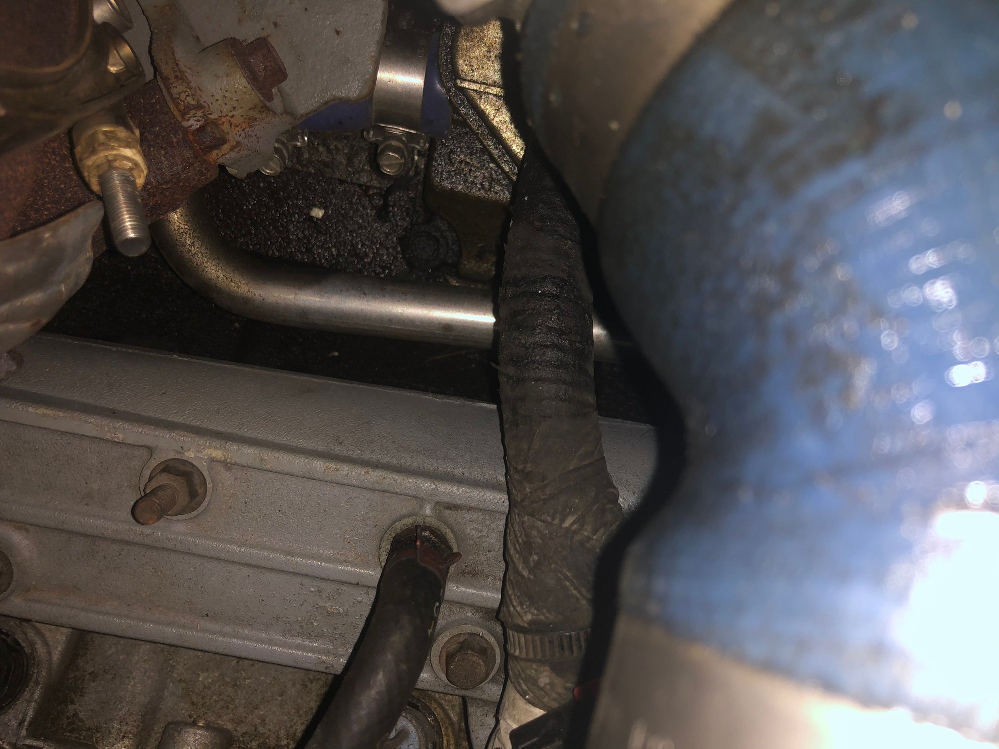

also I have some leaks from these areas
This little blue hose Down there. Will that cause an oil leak of some sort? I always seem to have oil or something all over the hot side blues turbo connector.
Would this cause tough shifting and a random temp gauge

Aftermarket injectors, diesel in the oil, "crudded-up" fuel filters (ie low pressure) ...... sounds like the potential of injector issues is high.
The blue hose is the EGR cooler hose. It has been known to leak (the original orange hose was bad about leaking).

ive checked fluid it looks clean, I’ve checked level it appears good, I’ve checked trans codes and find nothing. The slipping started after I replaced the batteries. They were out for pretty much the whole day while I checked it out and did other work.
pictures above of that plug will that cause these issues? I have no codes except for the trans temp sensor high resistance.
