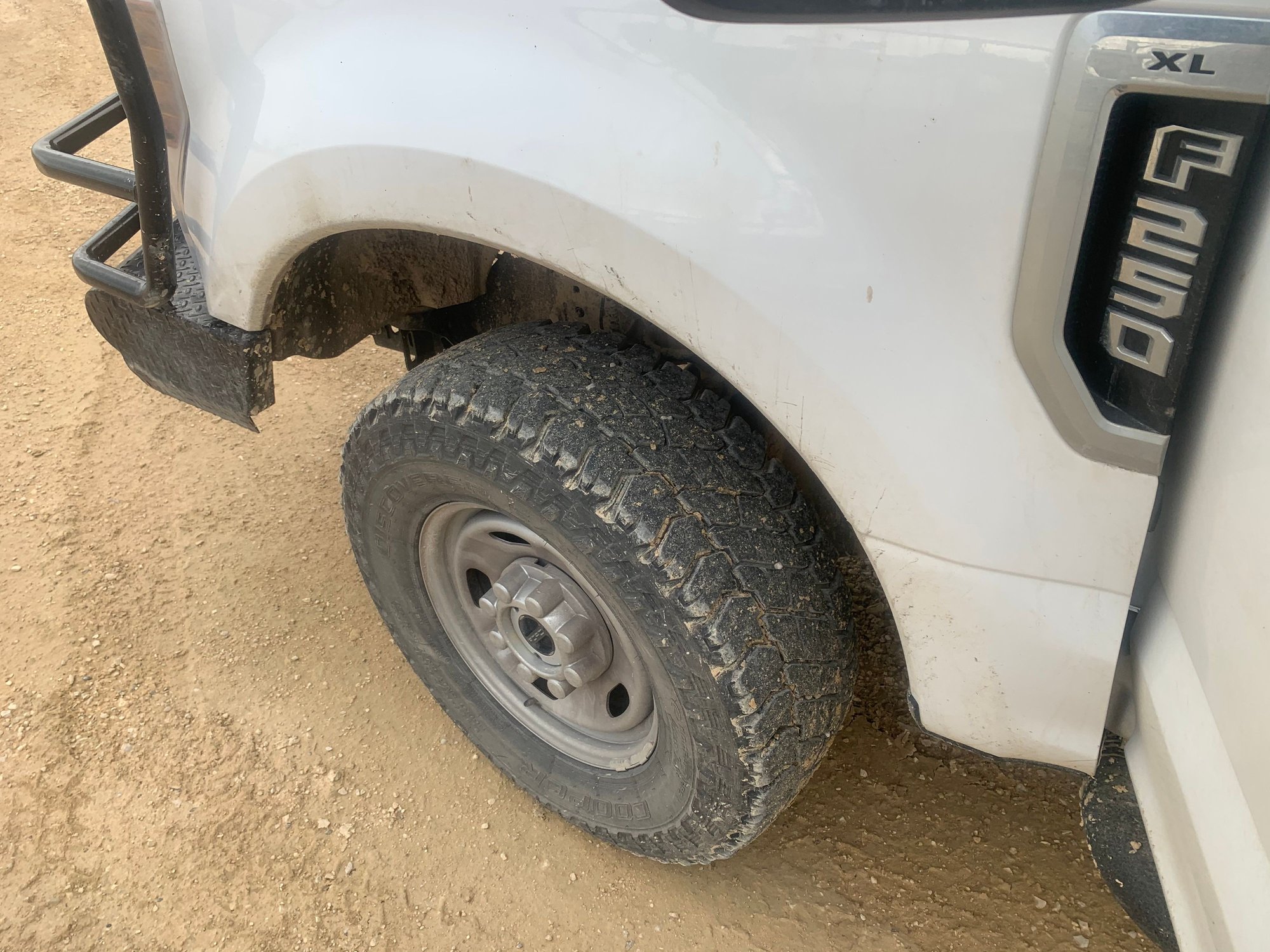

I recommend Motorcraft injector kits, some guys use the Alliant kits. I like Motorcraft when I can on stock parts and filters.
I drive rough, nasty roads and over 1200 miles a week with my F-250 for the last 8 years and my Excursion for over 3 years and found the best tires are Cooper STT Maxx and STT Pros. I have had 4 sets on my work truck and beat them hard with my 6.7 and my new 6.2 F-250. STT Pros on my Excursion and they are wearing perfectly and very little tread loss for a heavy truck.

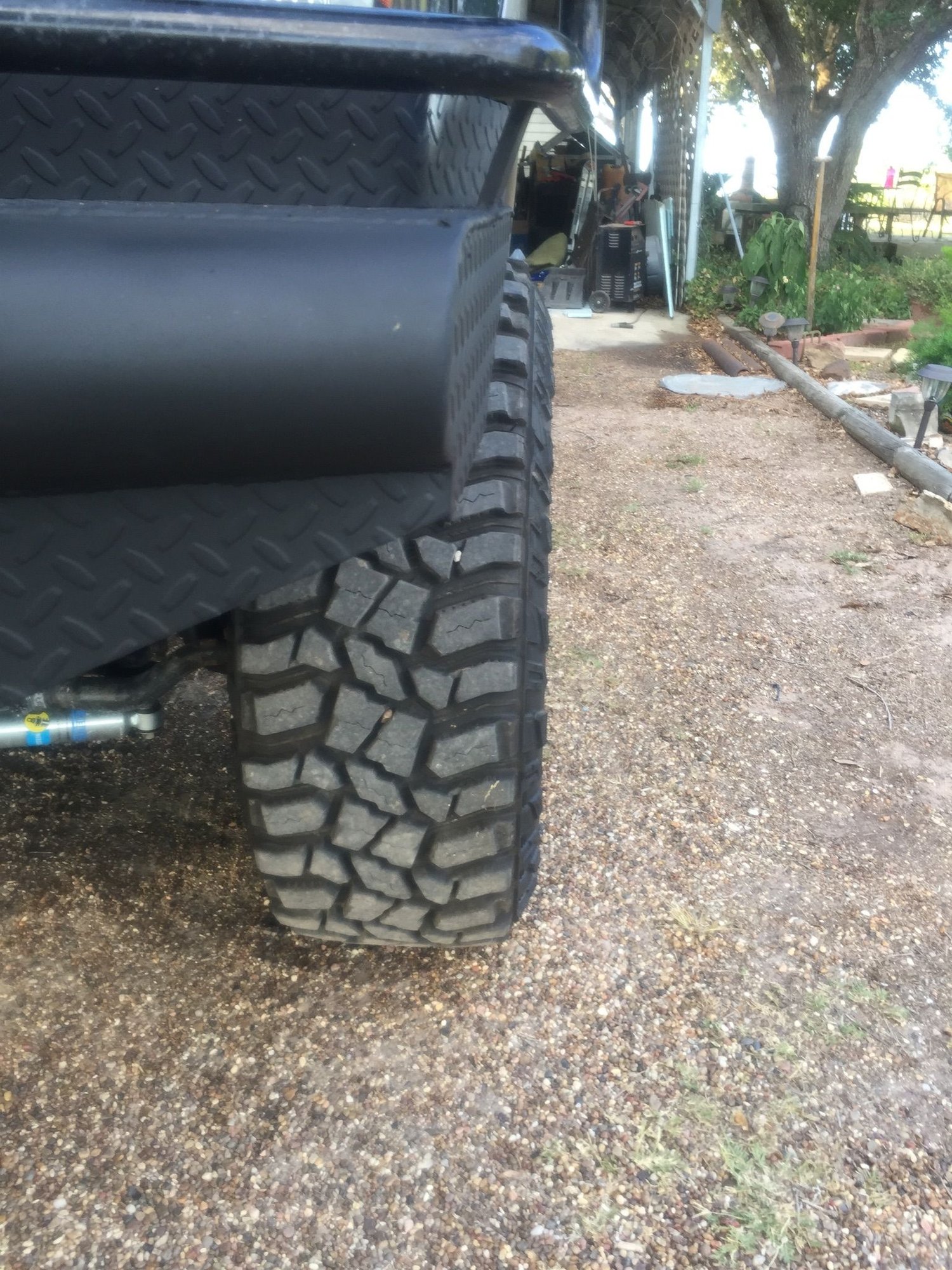

I’ll check them out, not to many tires out there that are 35x12.50r20... really want to go back to a stock rim lol

Both of these tires come in that size, I just checked. You’ll love them, the STT Pro looks aggressive but it’s much quieter than you’d think and has excellent wet and mud traction, the wear is fantastic and the sidewall is supportive. I drive 85-90 a lot and they handle it like a 9800# sports car.
