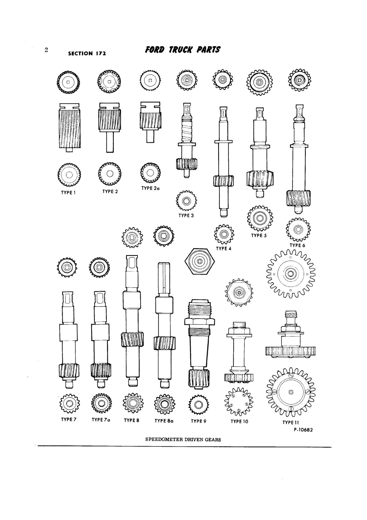

I don't know if this is what you need or not:
I'm not sure if these apply since you have an AOD tranny.

This is good information and I appreciate it. I'll do further investigation and see if this will help me get the MPH more accurate.

Speedometer gears
1 tooth on the driven gear usually makes a 3 MPH change.
