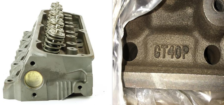

quick look at front of head 4 bars is GT40P, and under valve cover
There will also be a "GTP" cast in one corner outside the valve cover rail. On a GT40 head there you will find "GT". On an E7TE head will be a "T" and on an E6SE head an "S" in this location.
