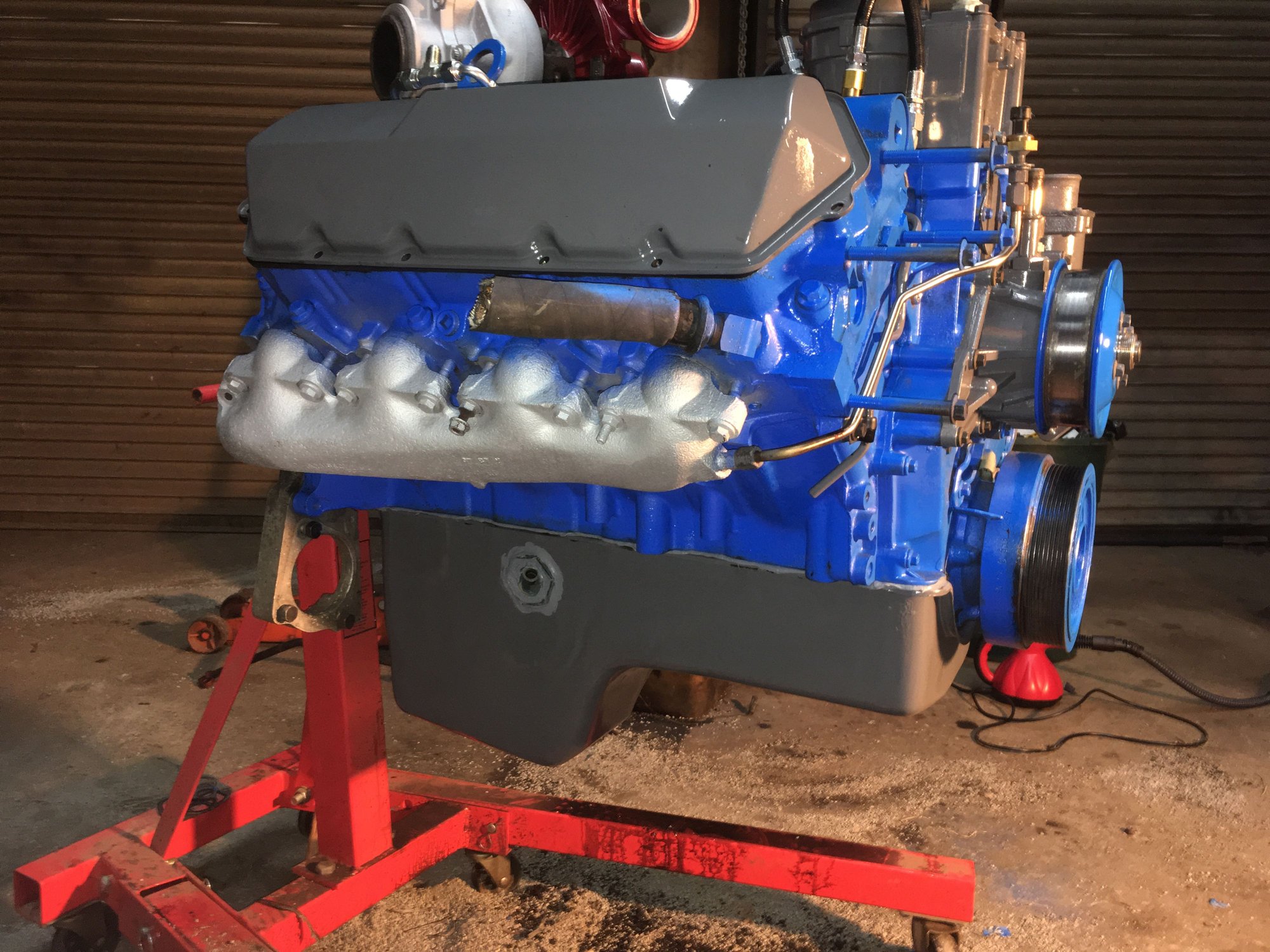

Okay y'all,
I've got the 7.3 out of my excursion. I wanted to know what mods everyone recommends while the engine is out. I've sent the injectors out to get tested at full force diesel in Tennessee.
I was thinking of doing head gaskets, head studs, pushrods and rockers, etc.
What work does everyone recommend I do with the engine out?

The long story short is that I thought I threw a rod and pulled the engine, but it seems like it's an injector. (My first diesel)
It's going to be a daily driver and occasionally tow. Very mild.
I don't want to spend more on this block than a new long block would be, around 4k or so. I'd like to focus on mods that need to be done with the engine out ad will increase reliability.

How many miles are on the engine? Kinda need to know what we are dealing with
Seems like total overkill for a mild build unless it has super high miles. 7.3 high, not just 400k high.
Replace the dipstick tube adapter thing for sure, and reseal the oil pan or replace if it's rusty or damaged. I'd do a front cover re-seal too since that would require engine removal or a lot of very crappy work later. Re-seal the oil cooler. New injector cups. Rear main seal, maybe front as well. Actually, since you have a $4k budget just replace every seal/gasket on the thing, but head gaskets would be overkill, unless it's super high mile.

I've got 211K on the car.
I'm contemplating pulling the engine on my '02 Ex to give it a refresh; what stuff did you have to remove to get the engine to lift out? Not looking for all the nitty gritty details like disconnecting stuff, but more like what had to come off the front of the vehicle and did you have to remove the turbo or any other engine parts?
I had to pull everything out of the front, radiator, intercooler etc.
I had to remove the turbo too.
It really wasn't that bad to pull it. The bell housing bolts gave me some trouble but it wasn't too terrible.
Here's a pic of me pulling it out. I removed everything from the front of the engine.
Oh my!! Yeah, that is a lot of extra work... Front end can stay.
