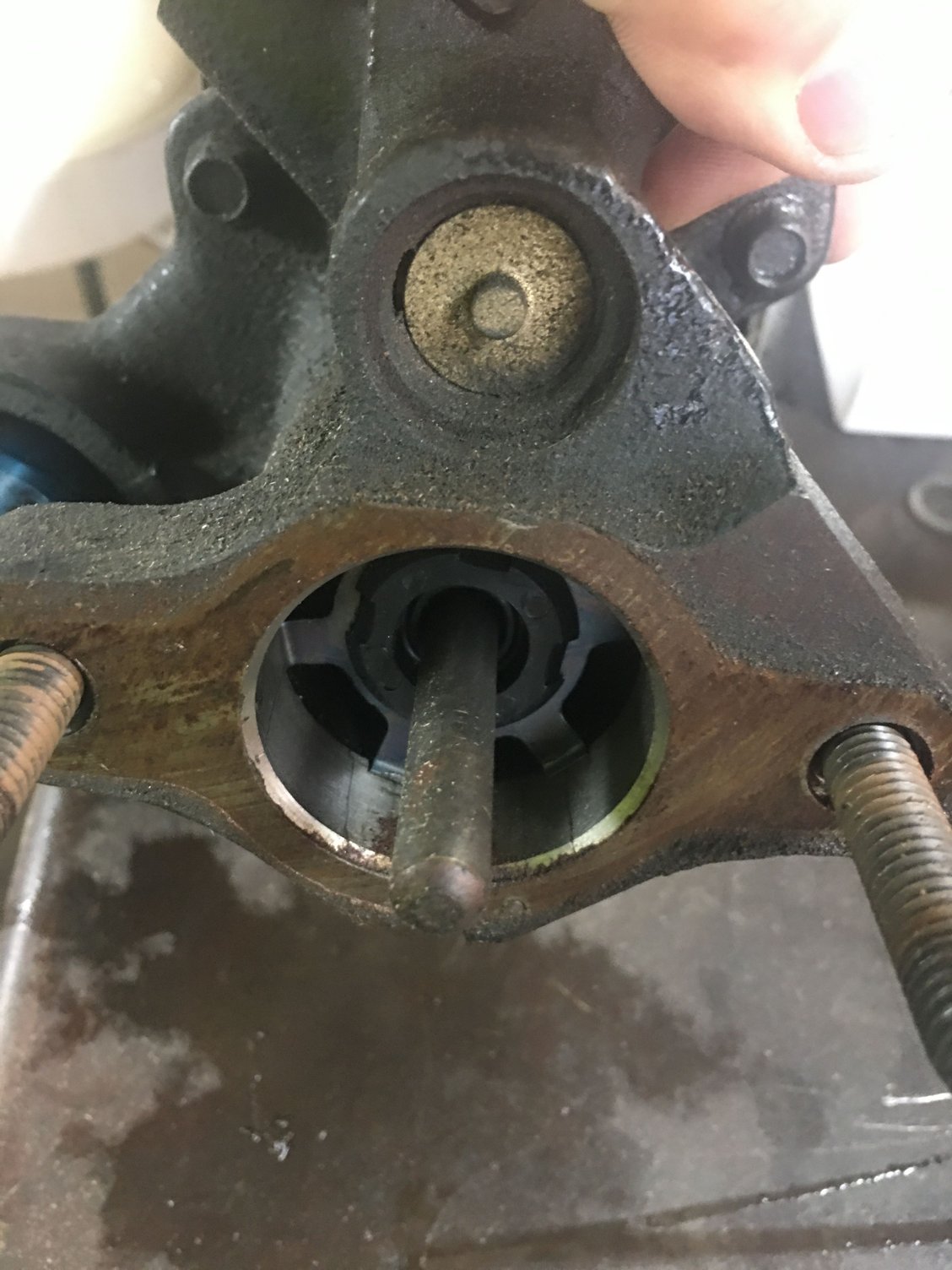

I’m in the middle of doing the hydroboost conversion on my 79 f350 flatbed, is there something that is supposed to go between the master cylinder and the booster? There was a rod sticking out of the back of the vacuum booster, and thought it was odd there isn’t one in the booster... any help/pics are greatly appreciated

Forgot to mention I’m using stock m/c and 90’s f-super duty booster

yes there’s a rod and clip to hold it in. On the hydro boost. If you bought a remanufactured one they don’t come with it. I found out the hard way.

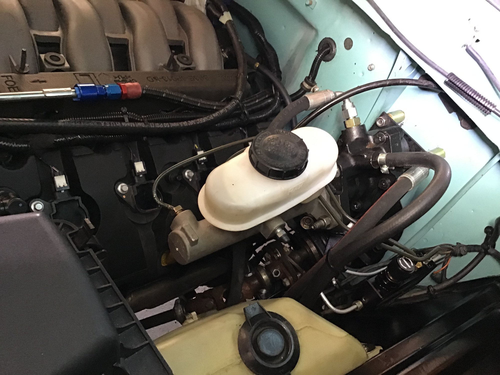

79 F250 hydroboost
79 F250 Master cylinder, 2001 F250 hydroboost and PS pump. Pirtek hoses to mate metric and standard. Redrilled stock booster brackets. Brake peddle sits a little lower. Ps pump was bolt on. Master was bolt on. Stops my truck on 37” tires quick😁
