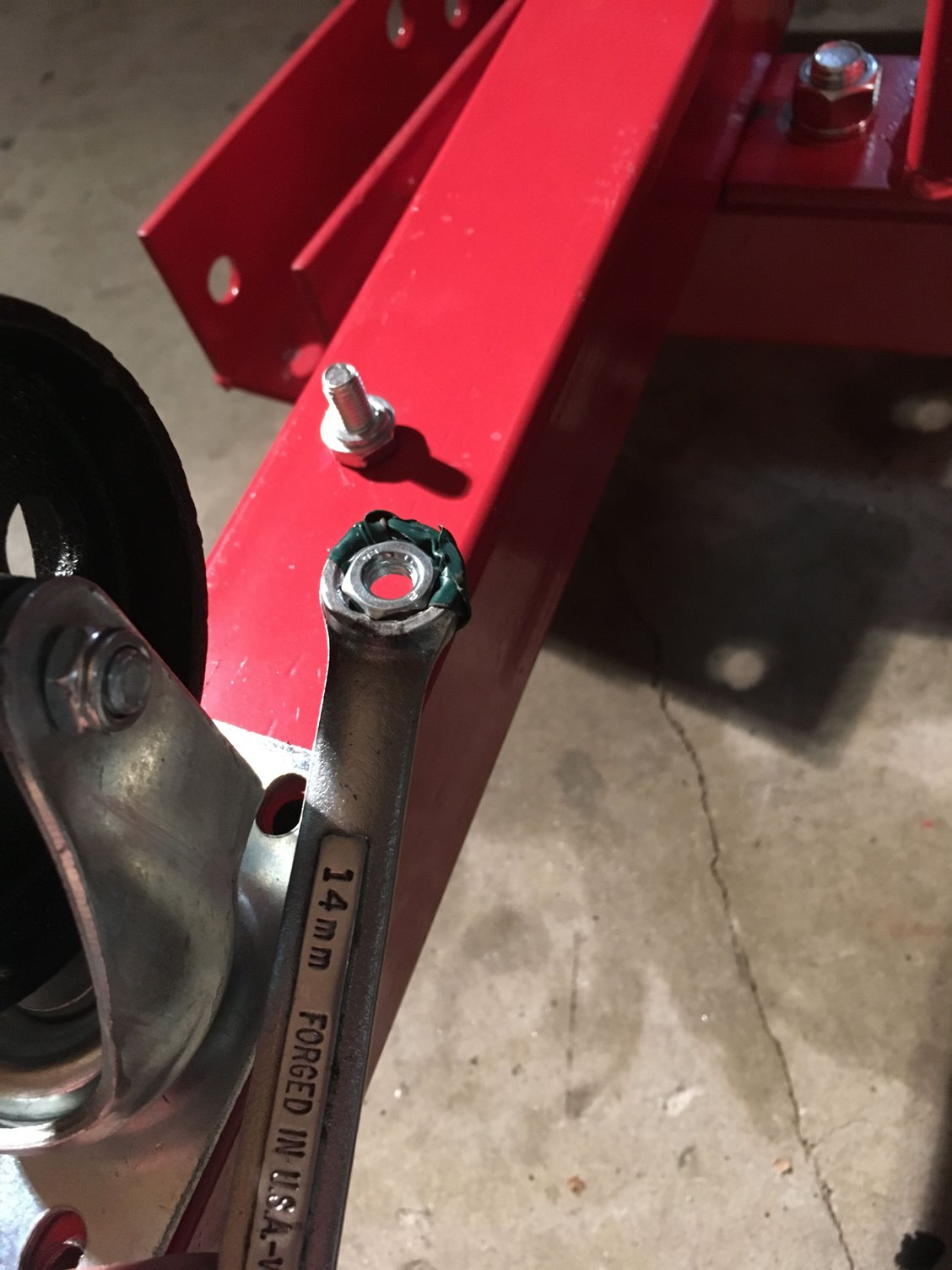

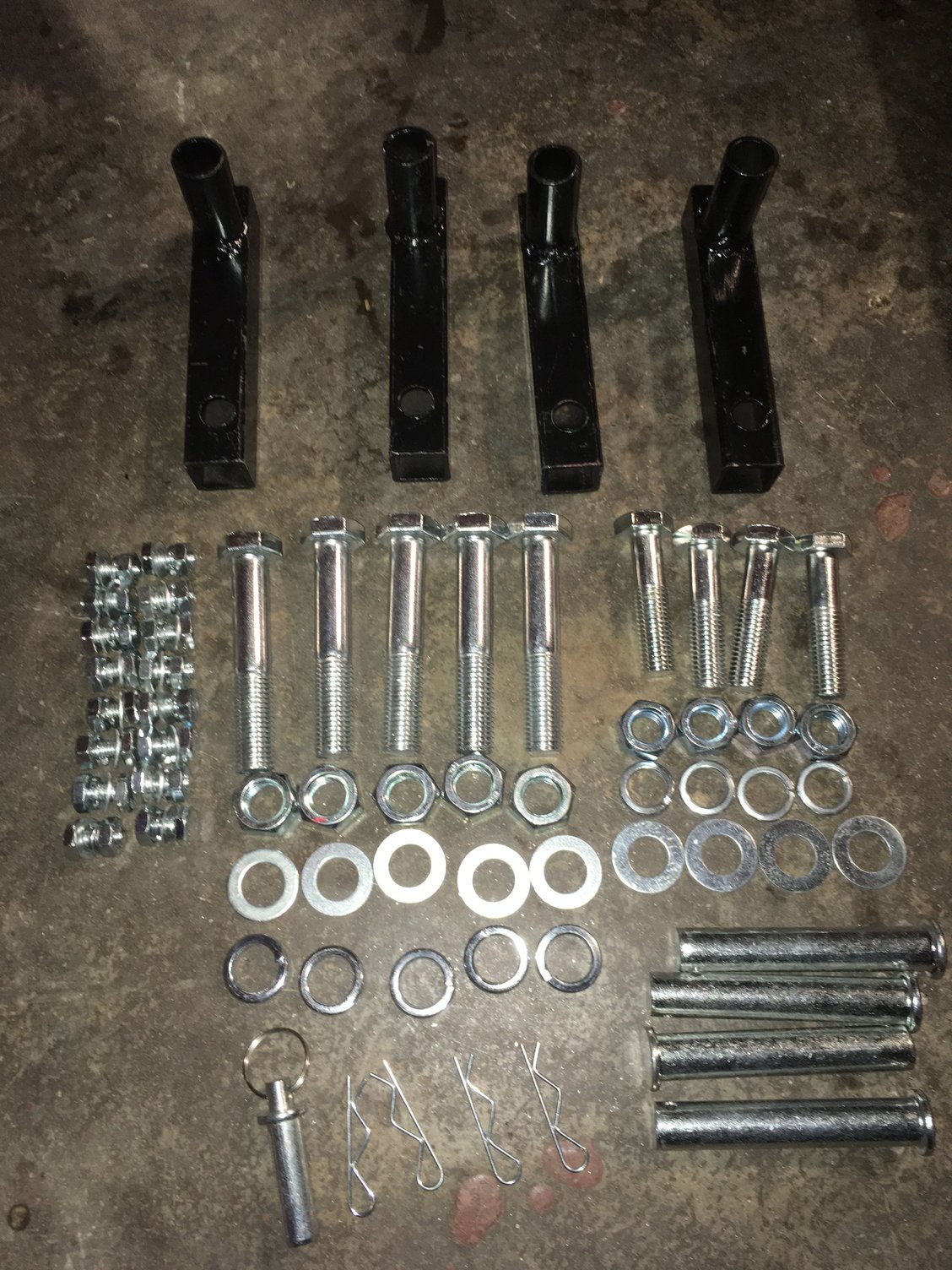

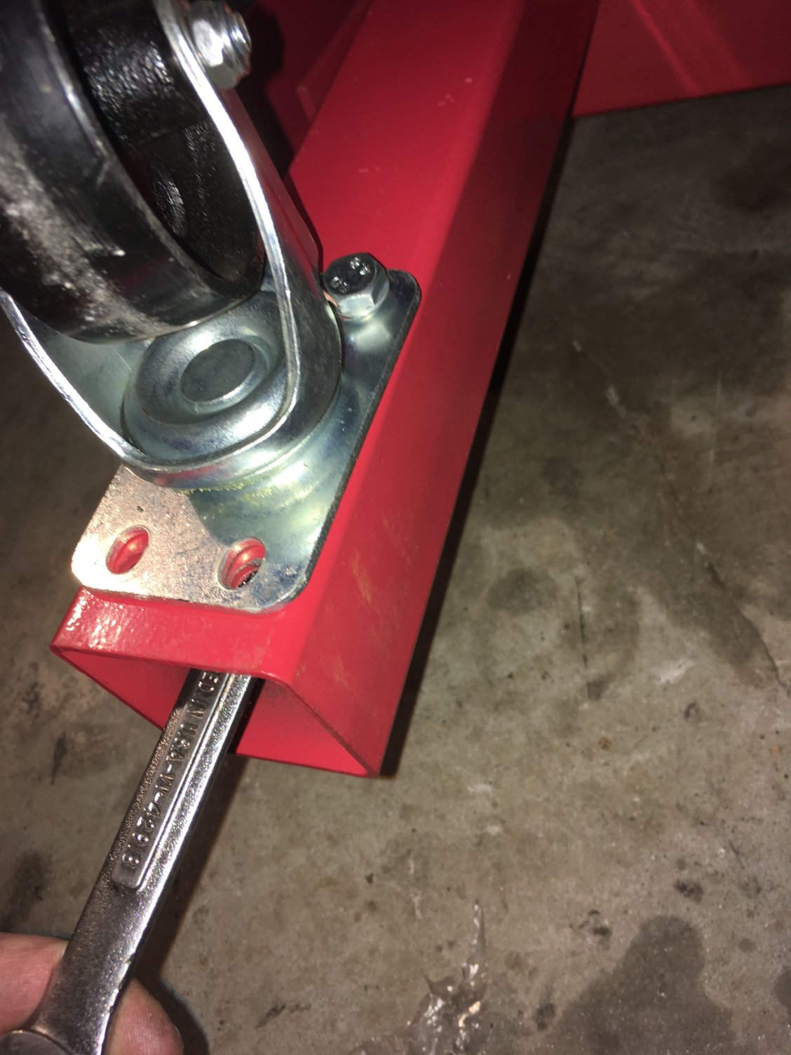

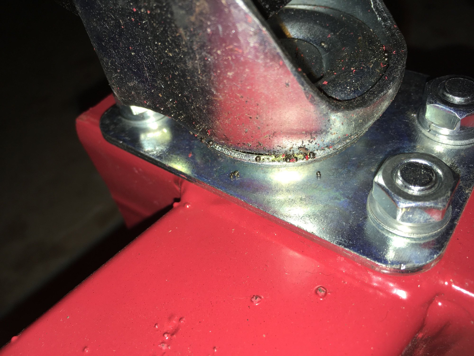

FWIW, I read the negative reviews from whiners on what appears to be the same product. They complained about poor boxing and open bags/missing fasteners and steel shot (blasting abrasive) in the box, etc. Sounds like the shot was in the casters and they didn’t work right.
In my experience:
The boxing could have been better. But it all appears to have made it here. It’s HEAVY so really needs to be almost bulletproof. UPS lady couldn’t get it out of the truck herself so my MOM helped her......
Open bags and fasteners scattered all over. We’ll see if they’re all there upon assembly....
Casters all spun freely. It feels like 3lbs of steel shot in the box!
I guess the whiners weren’t all wrong?? Lol.

One thing I will say is it is very efficient. Materials are minimal and design is adequate. It packs into a small box for shipping. I’m a little surprised they don’t manage and recover the steel shot better, because one of the reasons to use that abrasive is because you can recycle/reuse it. But, I’m sure they’ve figured out how much it costs to recover just a little more vs let it go and buy more.

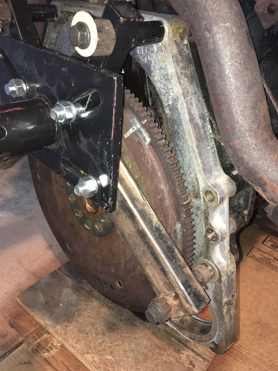

The little T-Rex arms that came with this stand are not long enough to reach the lower bolt holes for transmission to block.
So I poked around in the scrap metal/project fodder pile and in about 20 minutes, whipped up some new, longer arms.
I used old head bolts here, but they are a little long. Looks like I need to cut about an inch off of them to work without the hillbilly spacers.
I’ve got a few things to do while it’s on the ground, but should have it up on the stand later today! We’ll see if it works or not.

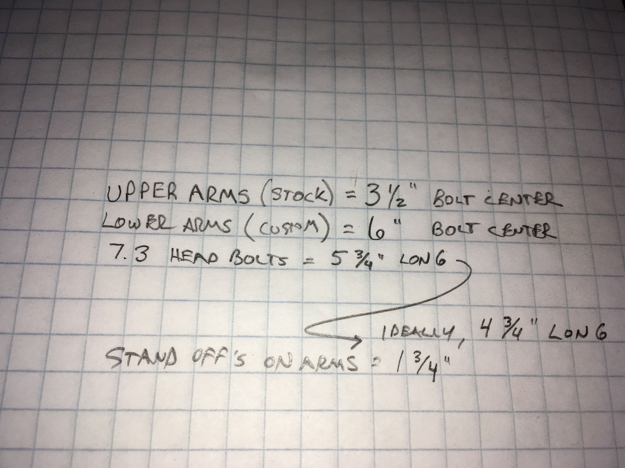

Some chicken scratch drawings of dimensions. Hopefully that is enough to help?
I see in Eaglescout94’s pics and a couple of my old pics with what appears to be the HF 2k lb stand - the arms appear longer....

It works! I can rotate it pretty easily, but haven’t tried to go upside down yet. Gotta put some paint on the stuff that is degreased and ready to paint first!
